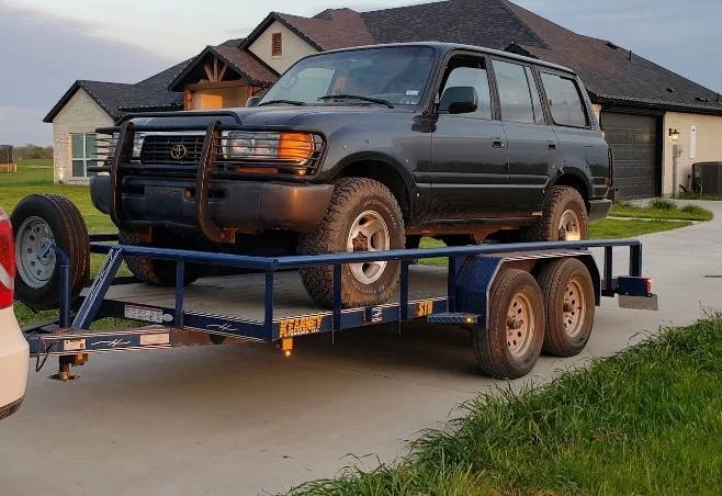

Started looking, Covid happened, prices soared which pushed the purchase off for a bit until I found one pretty local and scooped it up and trailered it home and it sat while I started baselining and checking things over

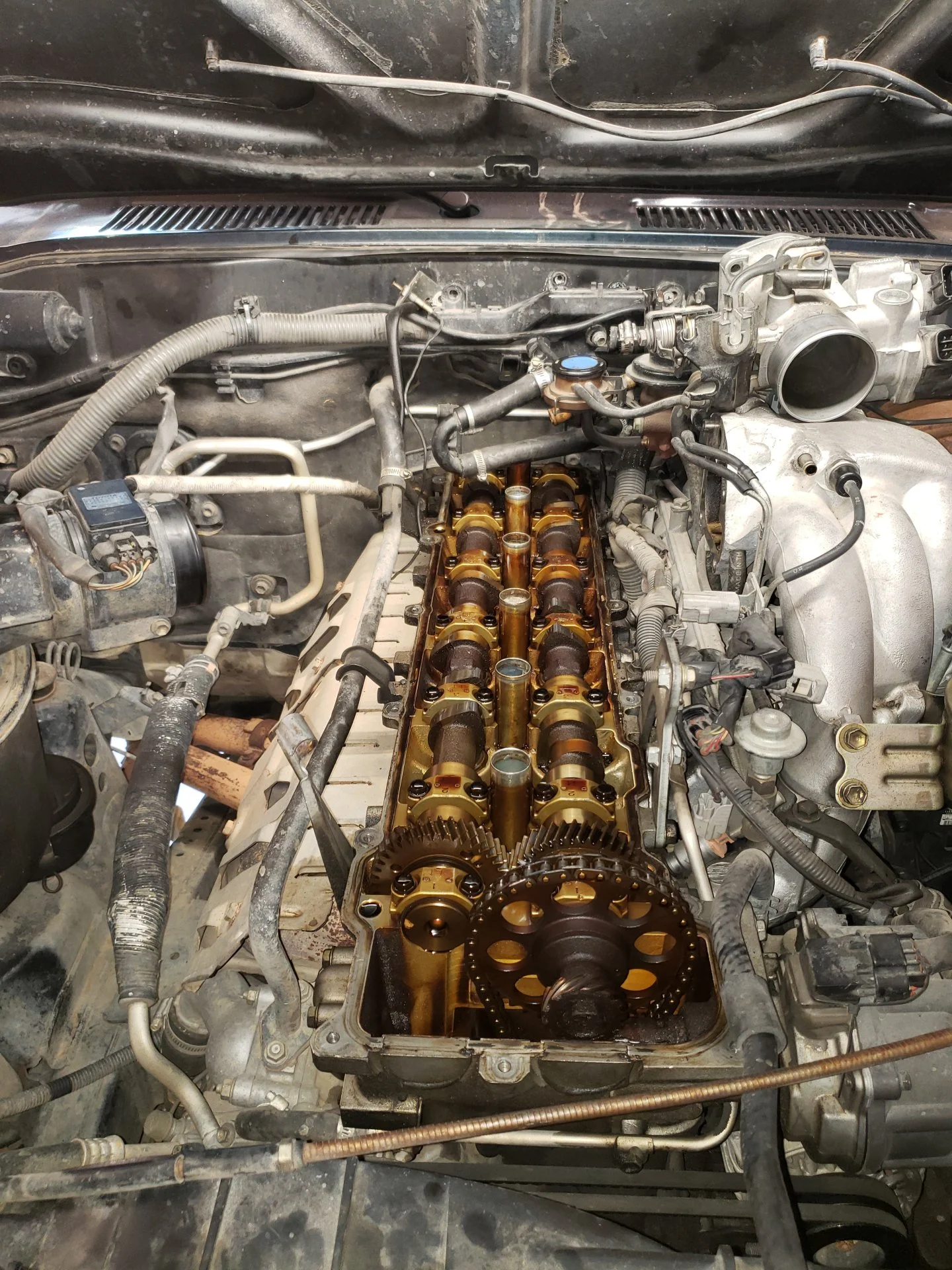

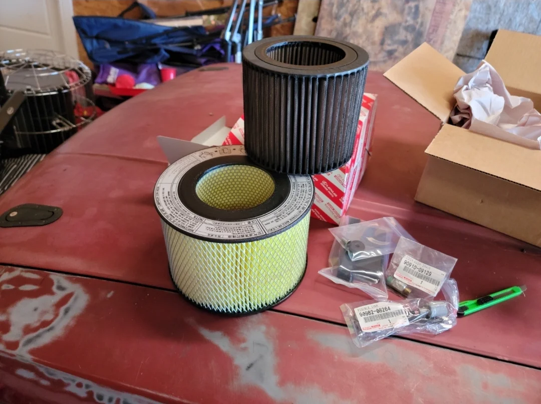

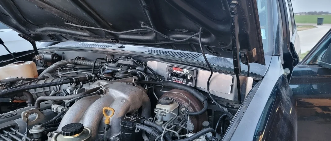

After making a 200 mile round trip without blowing up I had a little more confidence it the 'ole girl and started driving it to work about once a week as I was baselining. Made a few orders and got everything from the valve cover up, injectors, gaskets, plugs, plug grommets, wires, cap, rotor, and went to work

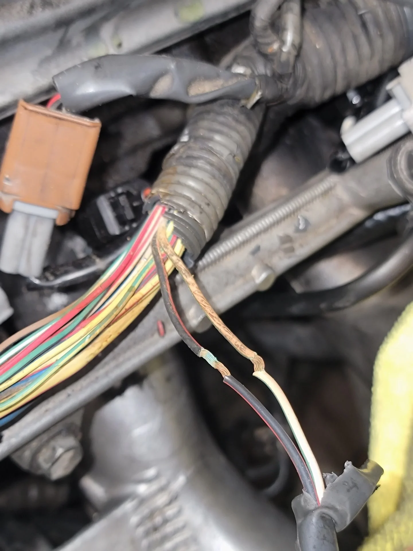

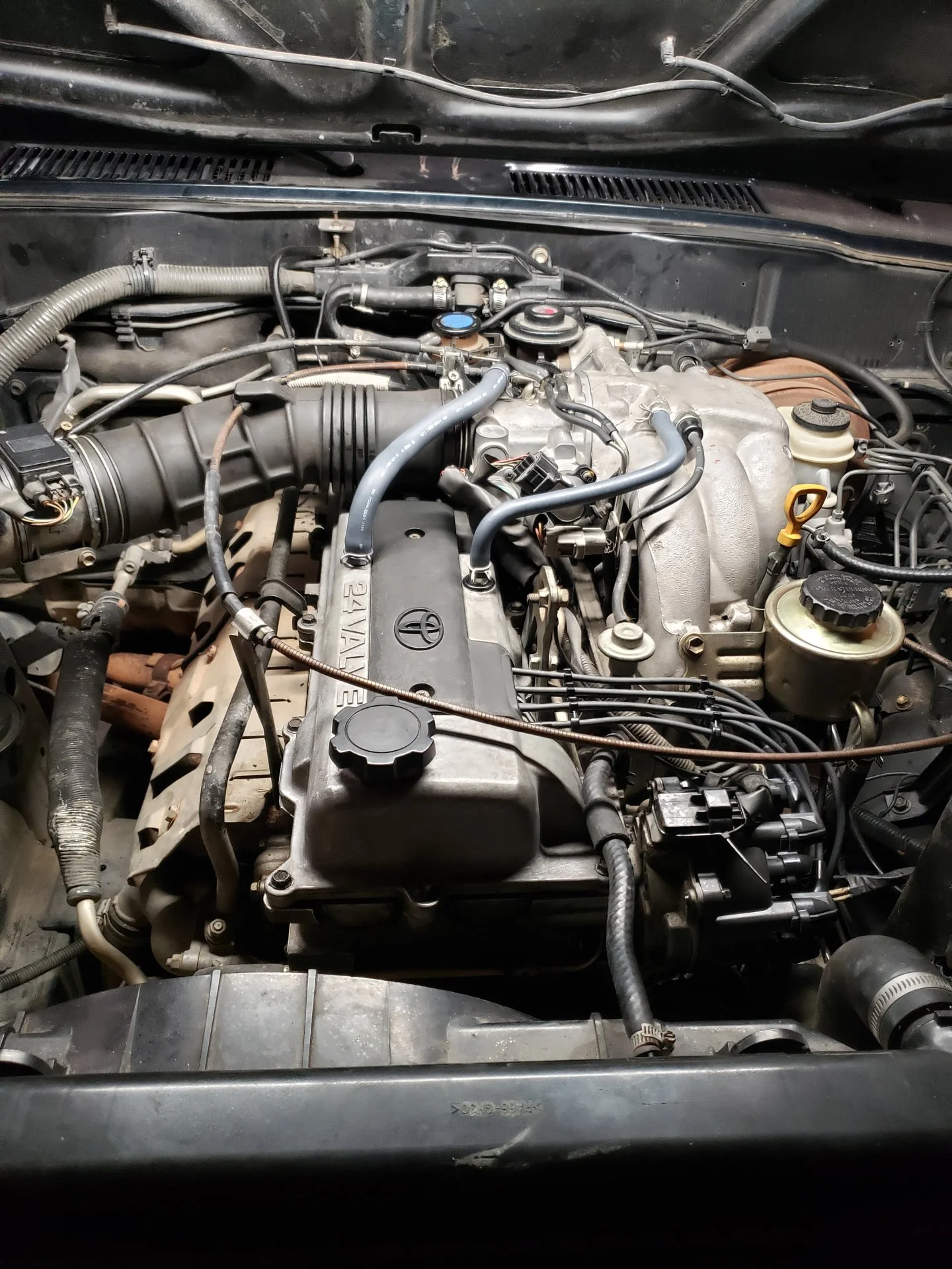

While putting the new injectors in I thought I found a concerning problem:
But after repairing it, there was no change in how it ran, so seemingly good to go.

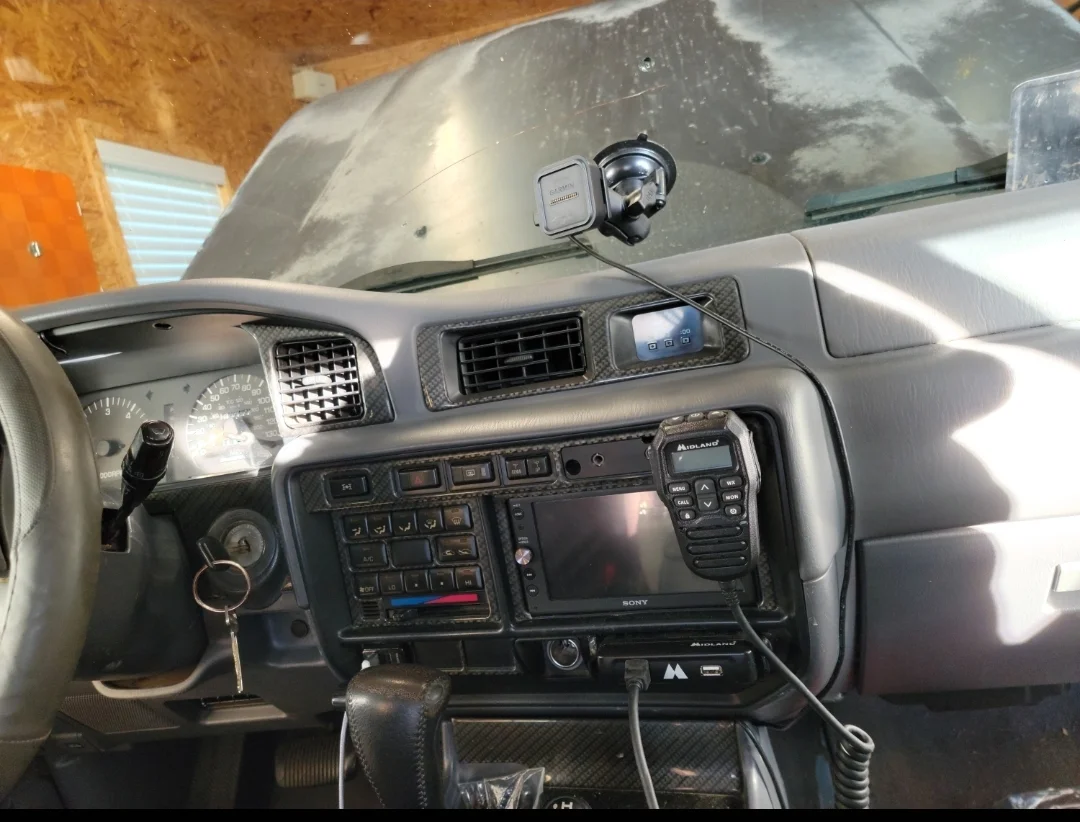

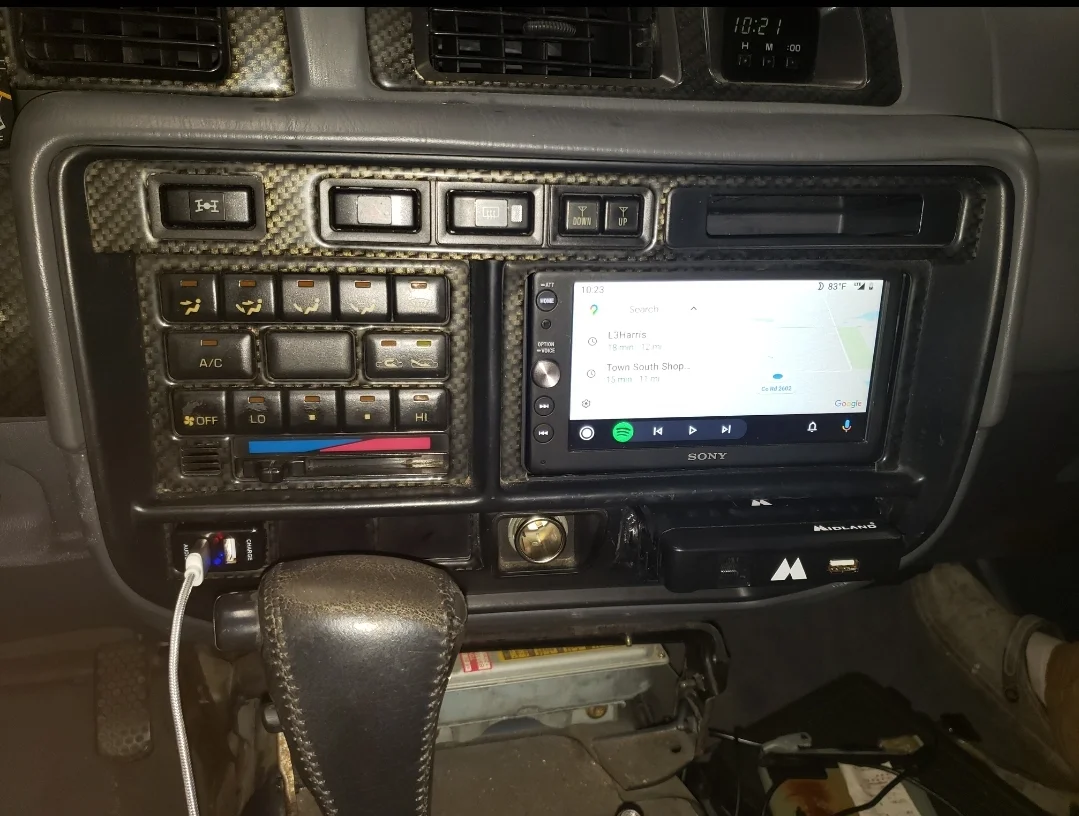

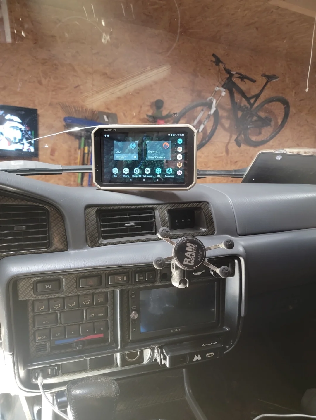

It didn't have a radio when I bought it so I tossed in the Sony XAV-ax100 that everyone here seemed to like. Also shown is the Midland purchase from a night when I was under the influence. Don't drink and Amazon....

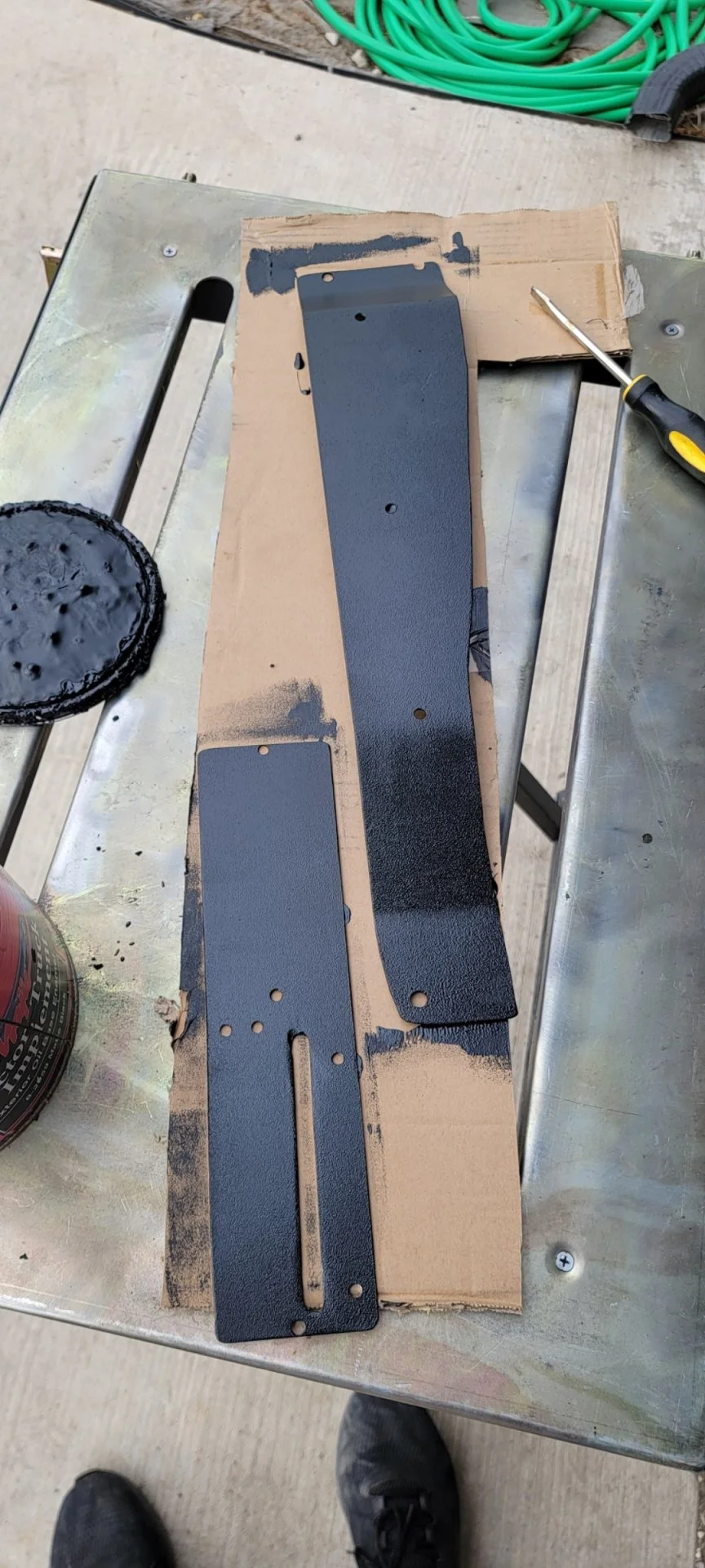

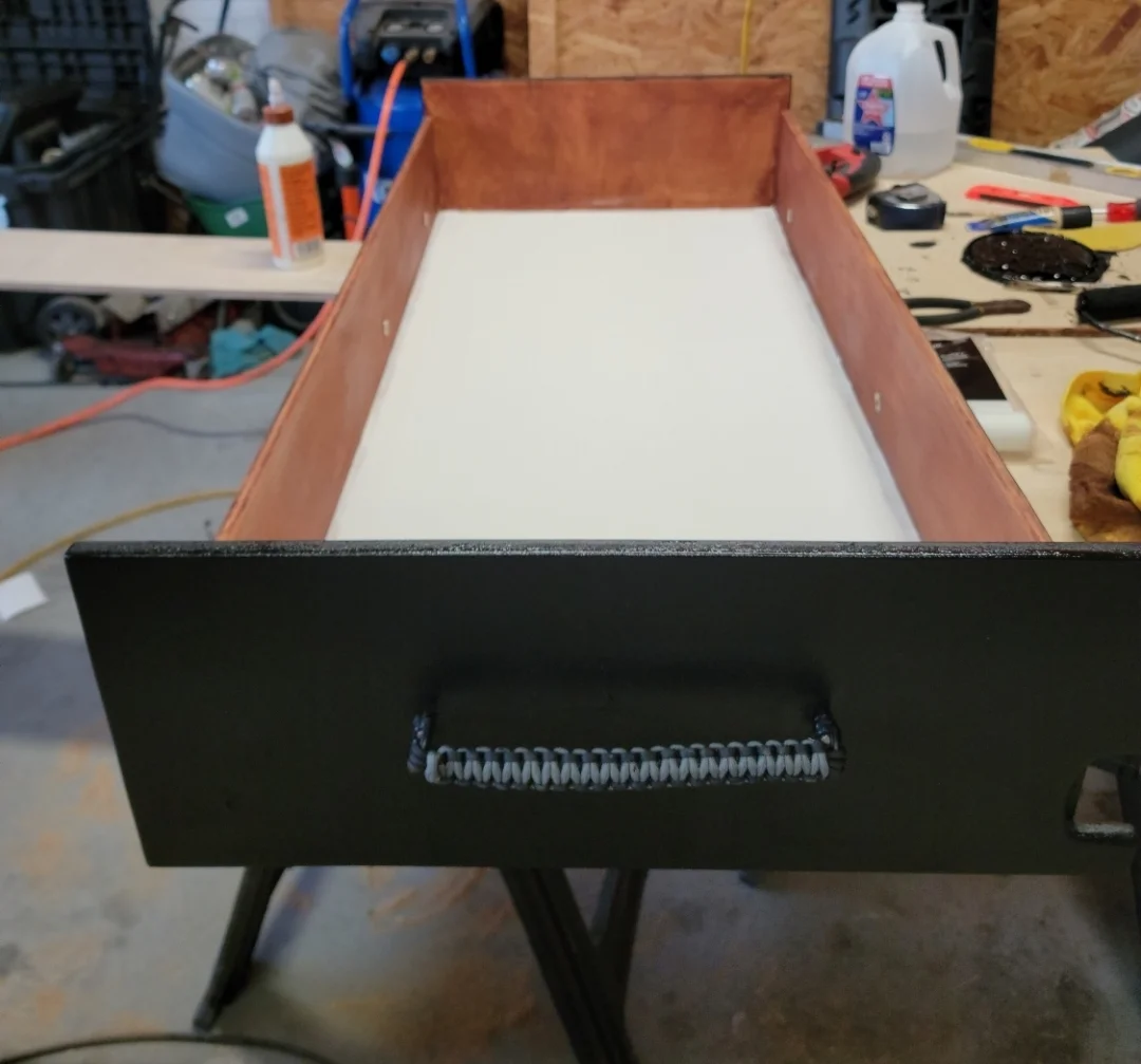

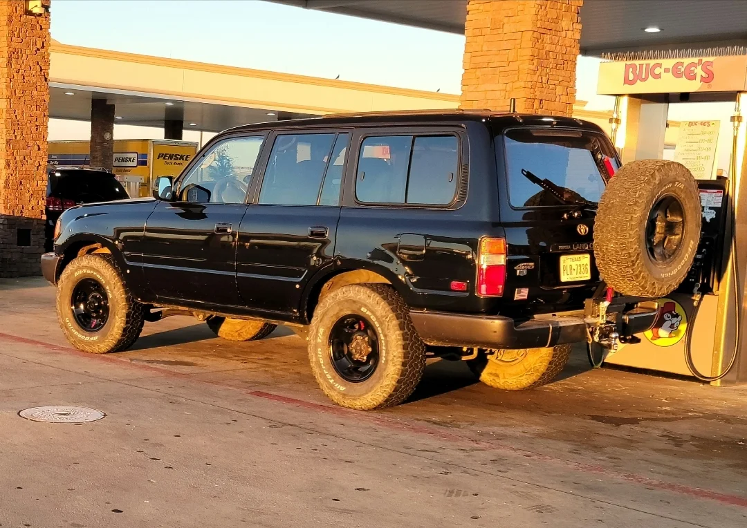

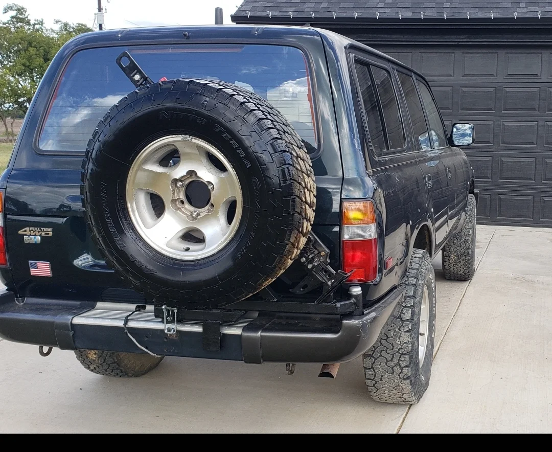

I stumbled on Summit Cruiser Jr's thread and discovered his swingout. Really wanted one but with him being slammed with life I decided to make my own off his and a few other threads I found
Being a bargain shopper I didn't have a solid plan of what mods I wanted to do in what order, but just grabbed items as I found good deals and kept adding on.

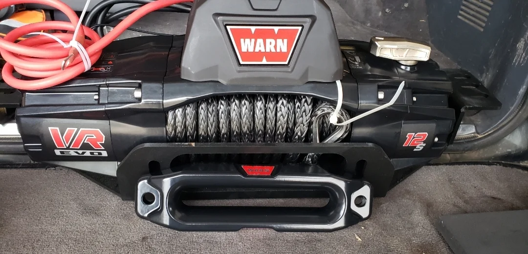

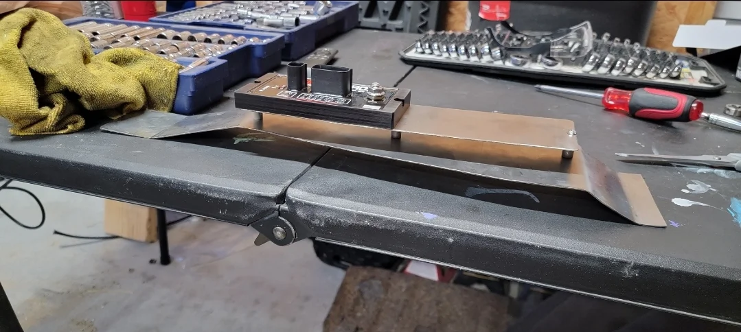

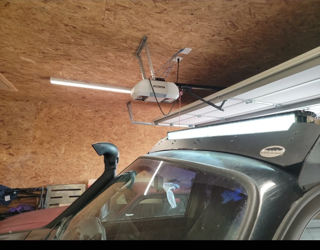

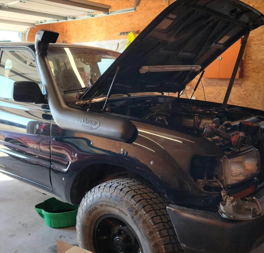

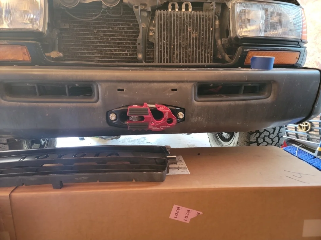

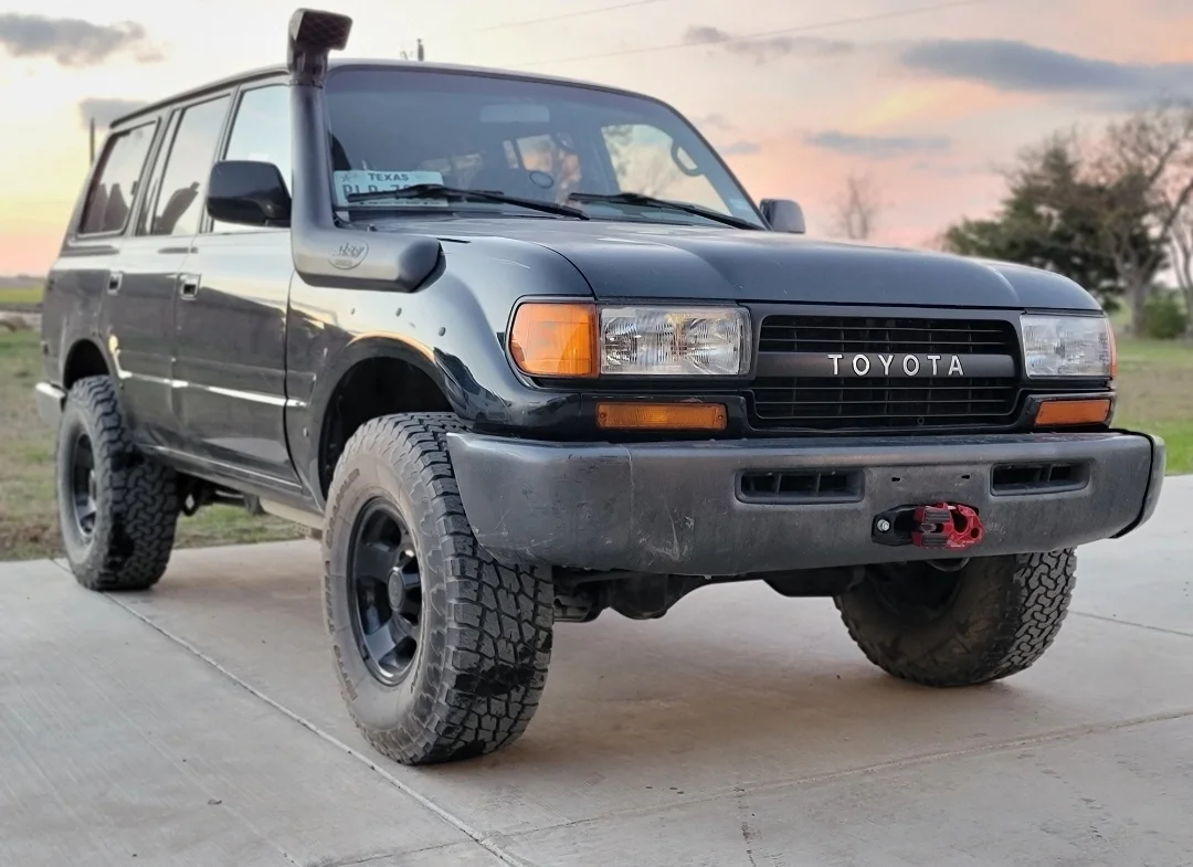

Found a 12k warn and snorkel for cheap on FB marketplace, and because I couldn't, and still can't, find a used full front bumper I went down the @TRAIL TAILOR path of a winch plate behind the stock bumper.
You have to relocate the control box for this install so I chose here for easy access if I needed to plug in the controller and I wanted it up pretty high as well.
If anyone ever needs help with a snorkel install please don't call me. I think this was the worst mod on the 80 I've done to date

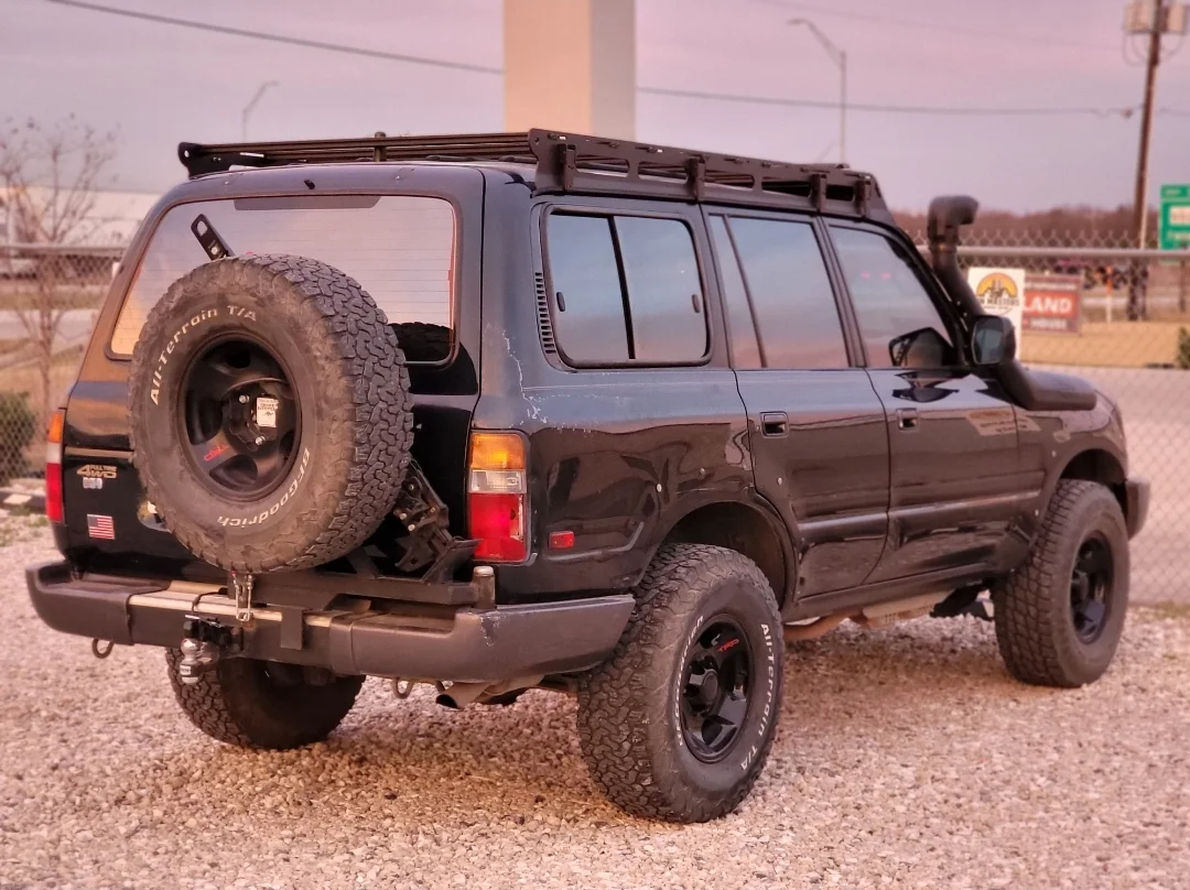

All done I also swapped in an earlier grill as I like those more.

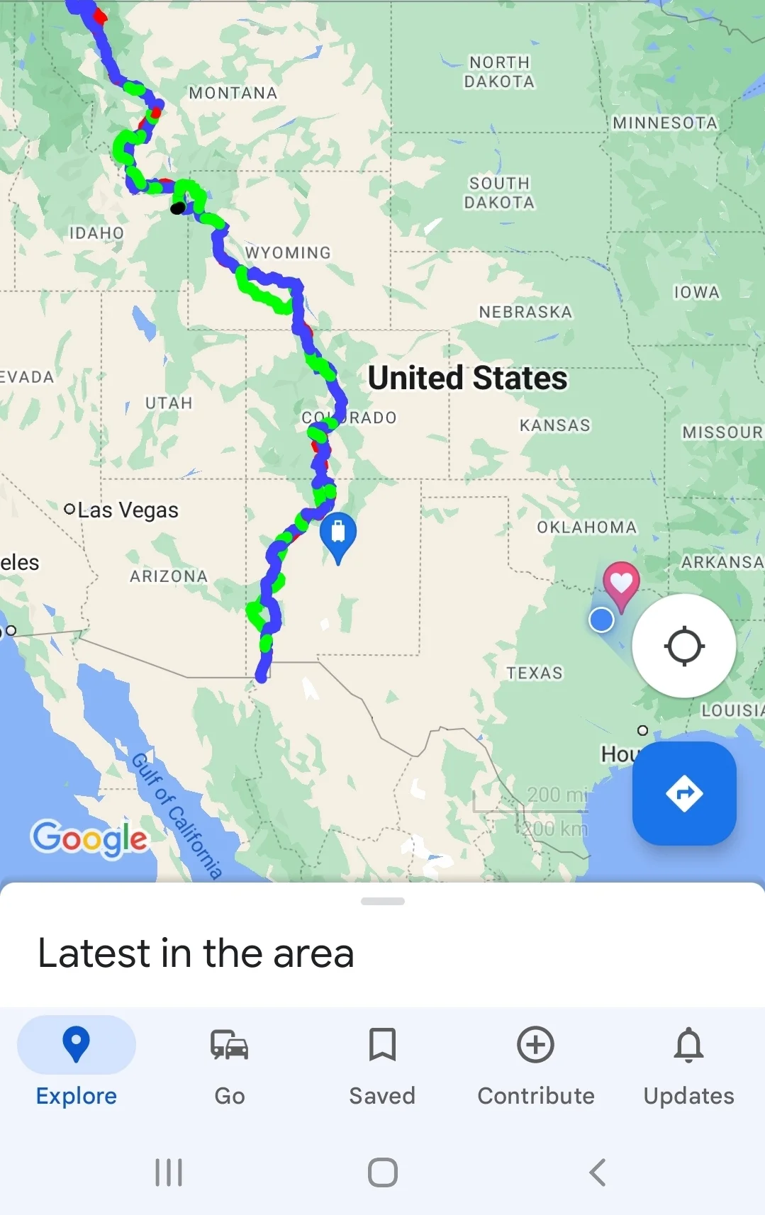

About a year in I started thinking of a trip I could go on. It was to be 2-4 weeks long and I wanted to see a lot. A lot of what I didn't know but I started searching. Narrowed it down to either going over to Baja and back or the Continental Divide. My oldest wanted to go, so we chose to stay in the US and do the Continental Divide.
Never having done a trip like this I thought I needed a lot more than I ultimately did, but hindsight being what it is I ramped up the build pace.

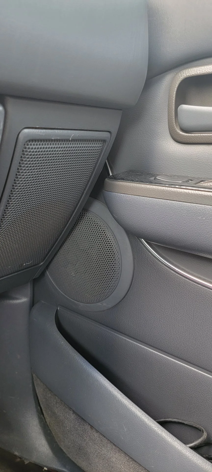

And the factory speakers were worn out so I tossed in some new for the front doors.
Still have the factory grills

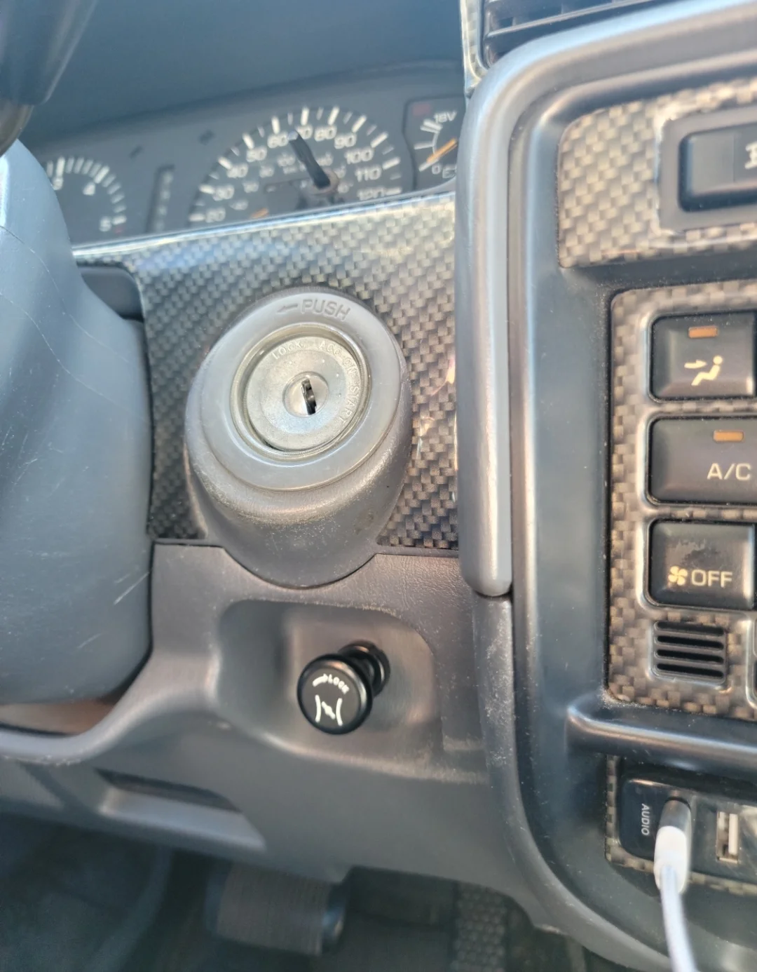

Read a lot about the high idle cables, my a/c would struggle a tad in the heat while idling so I figured I would see if the cable and a few extra rpms would help the cause; it did

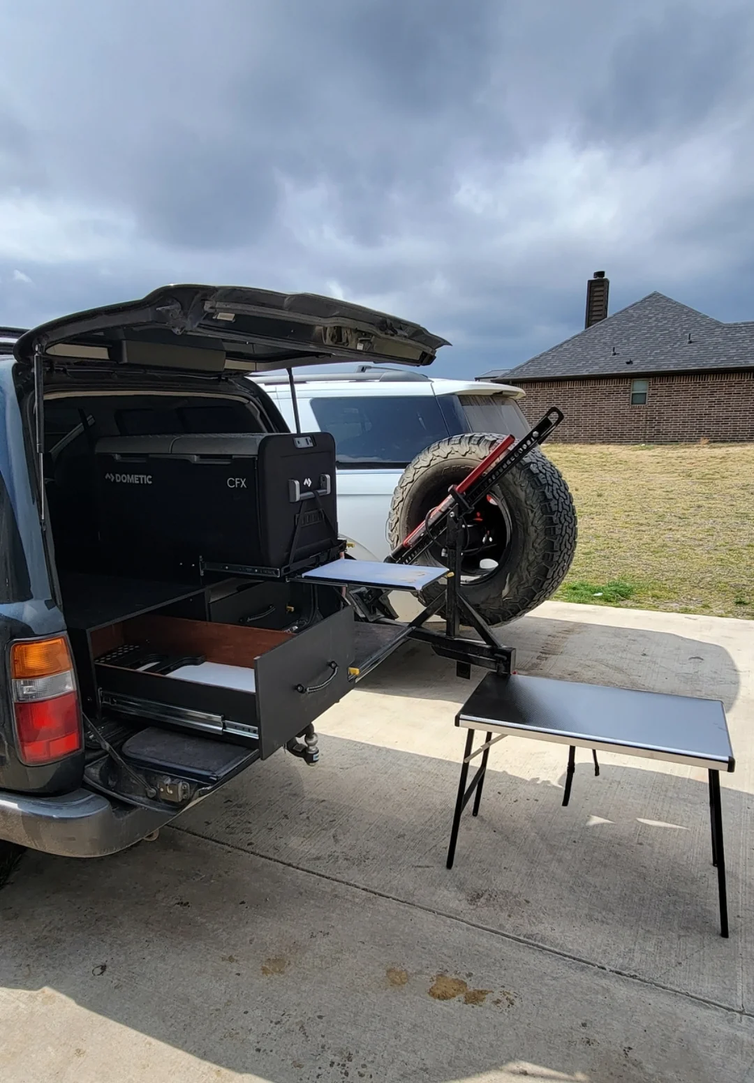

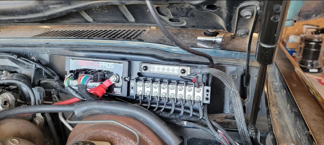

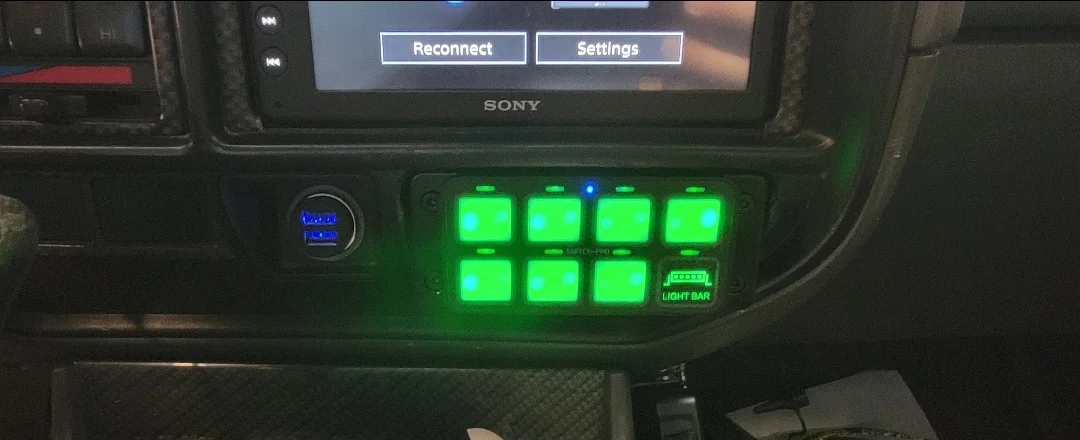

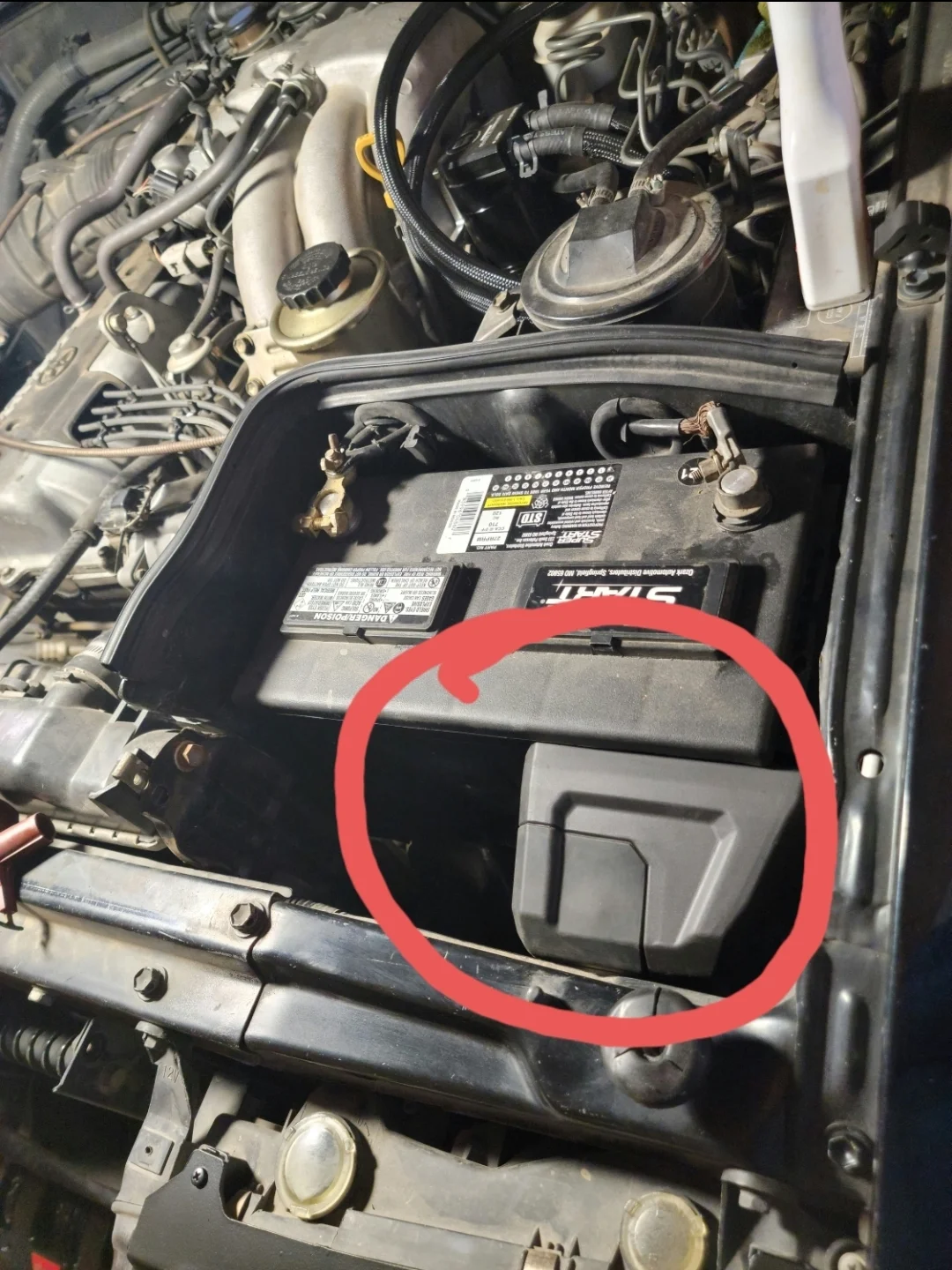

Added Slee's bracket for a second battery, ARB compressor, Blue Sea dual battery isolator, and a breaker for the fridge wiring.
Solve function dual 12v mount for the third row seat for fridge power with dual USB for power to the RTT
