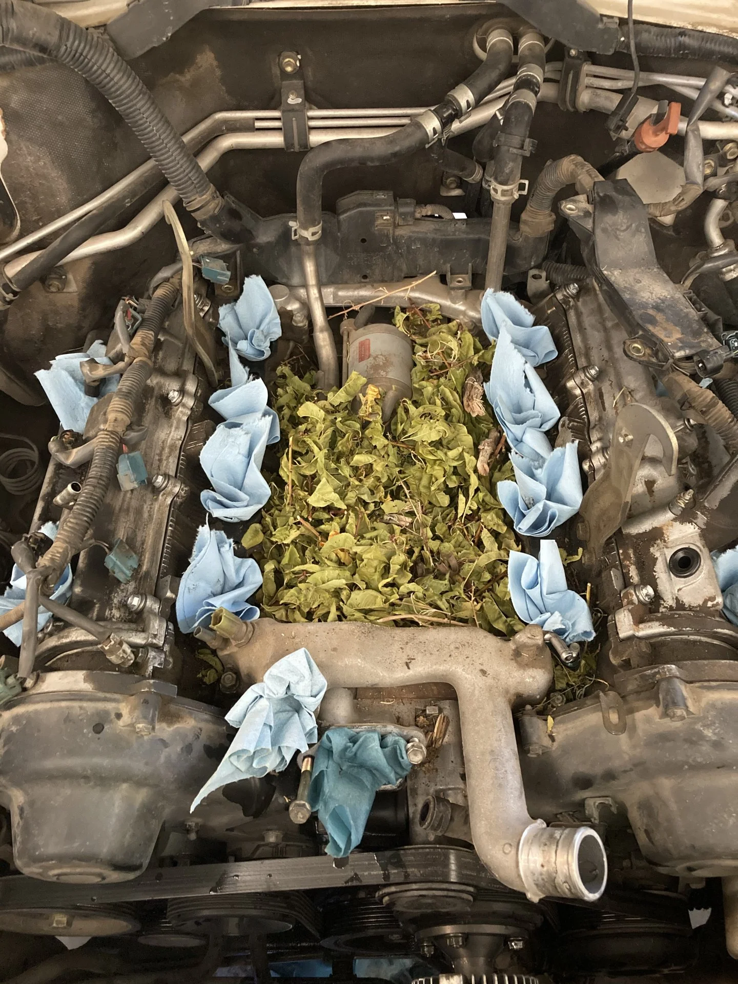

FYI, one potential problem that can occur from doing the starter job, which could wreak havoc on the engine, is knocking debris or dropping something down one of the intake ports. Considering an apprentice did the job, he/she probably didn’t know about this risk and just yanked the intake off.
Below is an example, albeit rather extreme, of what could be hiding underneath and easily fall into one of the ports. This is from a buddy’s 100 when I did the starter, valve cover gaskets, and timing belt/water pump jobs for him.
Wow thats brutal,
PSA : Every now ands then shine a light into all the gaps around the intake to inspect. Once a year or so a mouse likes to make a home in mine. A long grabber tool is a perfect way to keep that area clean without any disassembly.
