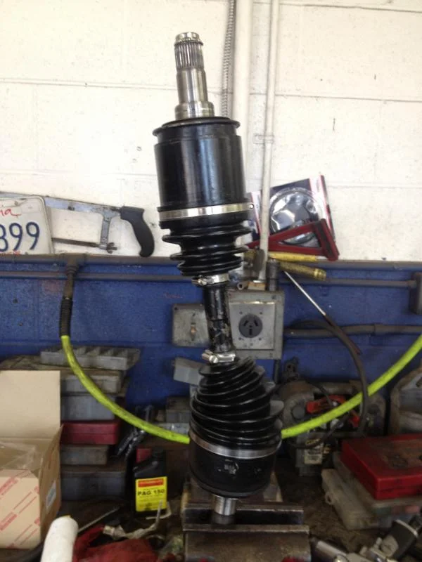

OK so I am just about to head down to my uncles to replace the boots on the CV's. He just called me and said it would be better and cheaper to get refurbished CV's that have the boots on them. He said he can get them for $60 a piece and that they would be better than the originals I have in there (116,000mi). Any opinions on whether we should take the time and reboot the original CV's or buy the refurbished ones?

Just to add to the mix, I've got nearly 50K miles on a non-OEM drivers side that has seen some pretty heavy abuse. Obviously, the quality of material used is inferior and will likely lead to premature failure but hey for $60 bones, I"d throw it in until you have time to repair the OEM unit, then keep the cheapo for an emergency spare.
Repaired and kept my original until the knockoff breaks, but it's not cooperating. It's probably waiting for the most inopportune time to go. :)
