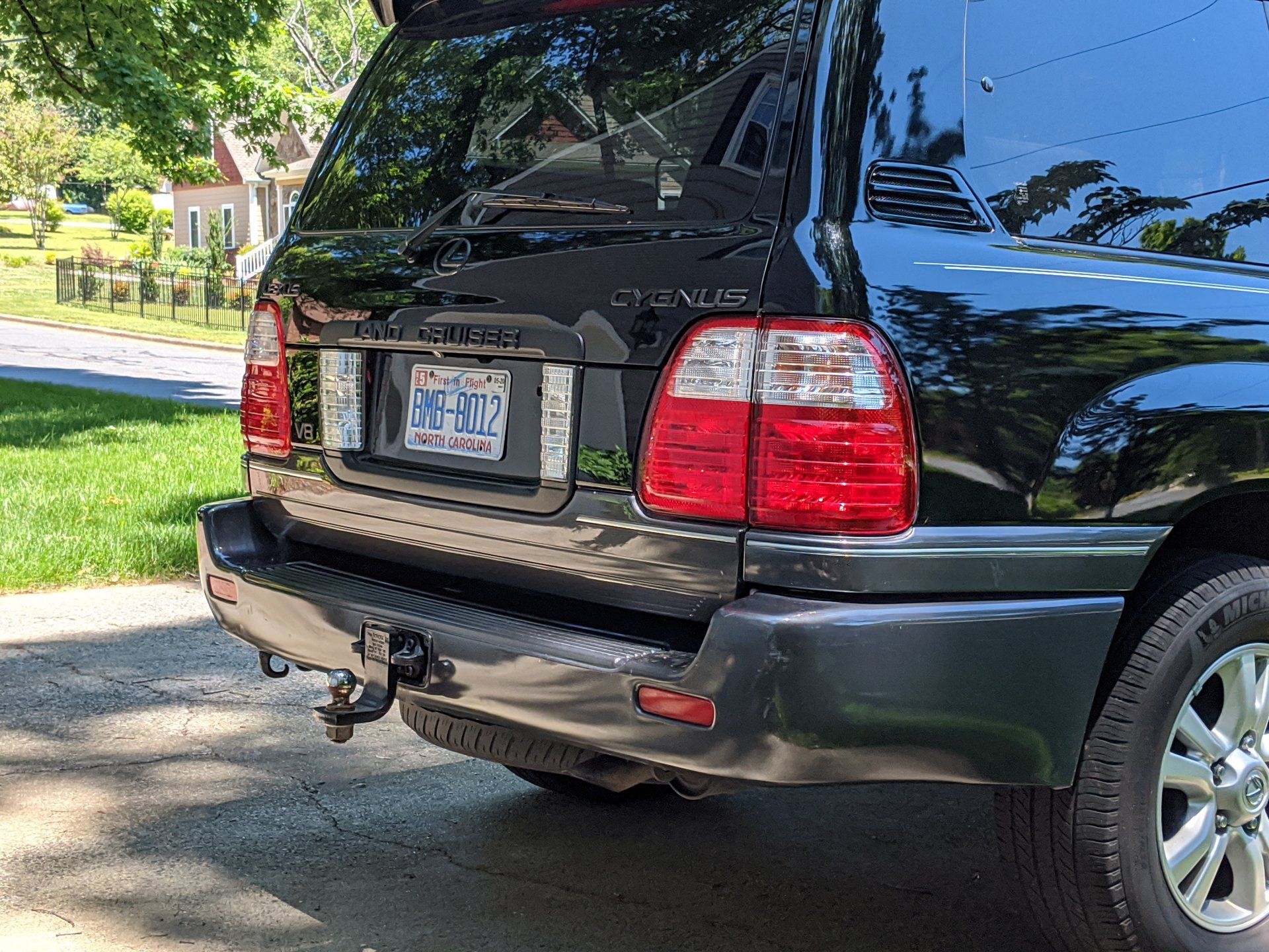

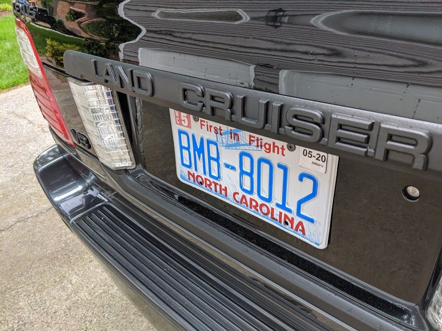

I bought the official parts mentioned in the first response and used JB Weld to clean up the transition from original trim piece to the Land Cruiser badge. I like how it turned out. :-)
What is the easiest way to remove the existing badging for coating? An old friend advised using a WD-40 soaked paper towel to soften up the glue overnight. He then used some dental floss to break the logos away. Any thoughts?
I didn’t remove the badges when I dipped. I didn’t wanna worry about positioning or using the wrong glue. OEM glue sticks. If layered thick enough, plastidip peels right off paint. Just go around the letters with a toothpick first to encourage splitting the “seam” there. Overall very easy
Yes, it's PlastiDip (or something equivalent), and I actually did remove it this time (initial trial was on the car, to be sure I liked it - before I got the Cygnus and LC badging). I just took a wide metal putty knife and scraped against the back side of the badge instead of near the paint. The OEM double-sided tape comes off with a bit of elbow grease (it's 15 years old at this point). I then used some polish to clean up the scratches around where the badges have been washed around for ages before I put the re-dipped badges back in place.
The only piece I didn't remove was the frame around the license plate - that thing is really stuck down and I didn't want to warp it.
3M trim tape is the right stuff - just use an X-Acto knife to cut away the excess.
Also, one correction - the piece listed in the post from @BEG mentions the overseas Land Cruiser badges, but I got the one(s) from the 98-03 - sold as OEM parts 75442-60150 (Land)/ 75443-60040 (Cruiser)

That really looks stellar Crash, nice job. The Land Cruiser lettering is going on our rig too then.
