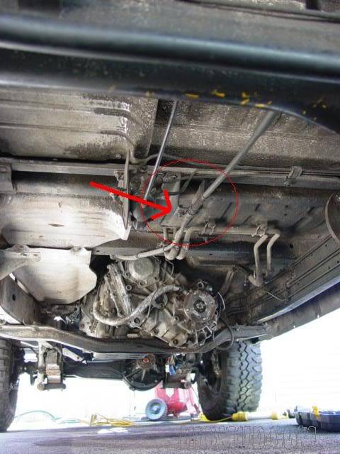

I figured I would get a better response outside the build thread on this one. Can anyone validate the orientation of the rear x-member? Does the threaded hole reside on the driver side (by the exhuast) or the passenger side?
Anyone have a picture?
Yellow arrow points to threaded hole. Frame is UPSIDE DOWN. The bracket on the rear shock mount is where the exhuast mounts to.
Bolt is on the drivers side on mine. Hope that helps for confirmation
