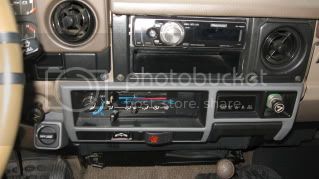

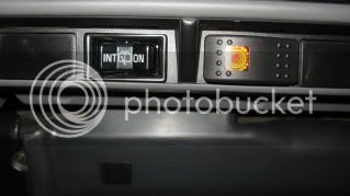

Both front and rear wipers have the INT function, the switch for rear wiper is the same one that on the 60 series (but in horizontal) and is standard for all 70 series LX grade made in Venezuela. I will post some pic later from my home.
Posted from my BlackBerry using BerryBlab
Here are the pic's
Check the grounds or negative wiring (-)
Sometimes it is a corroded connection
