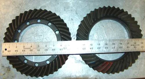

a) The ring and pinion does not have splines.
Answer: The side gears in the differential on the 100 is 32 spline. So when you do the pumpkin swap that you talk about, the side gears for the 100 are retained otherwise you can get the axles back in.

It is not a pumpkin swap. It is a carrier swap, which when you run an ARB is trivial since you the 80 and 100 ARB carrier is virtually the same thing.
ShottsUZJ100 said:
Others have taken the 100 ARB locker and 80 pumpkin and gears and made a usable 4.88 rear gear set. (Slee)
Again totally not right. We took a 80 housing (the thing that the carrier fits in), used a 80 series ARB with 100 series ARB side gears inside and used a 80 series ring and pinion.
So John, when you post, please do not post BS. A pumkin is a collection of parts, and if you do not understand what was changed, don't shoot down our mods, because even my wife knows it drives better with the 80 pumkin :D :D:D:D:D:D

Picture of gear sets.
attachment.php
attachment.php
