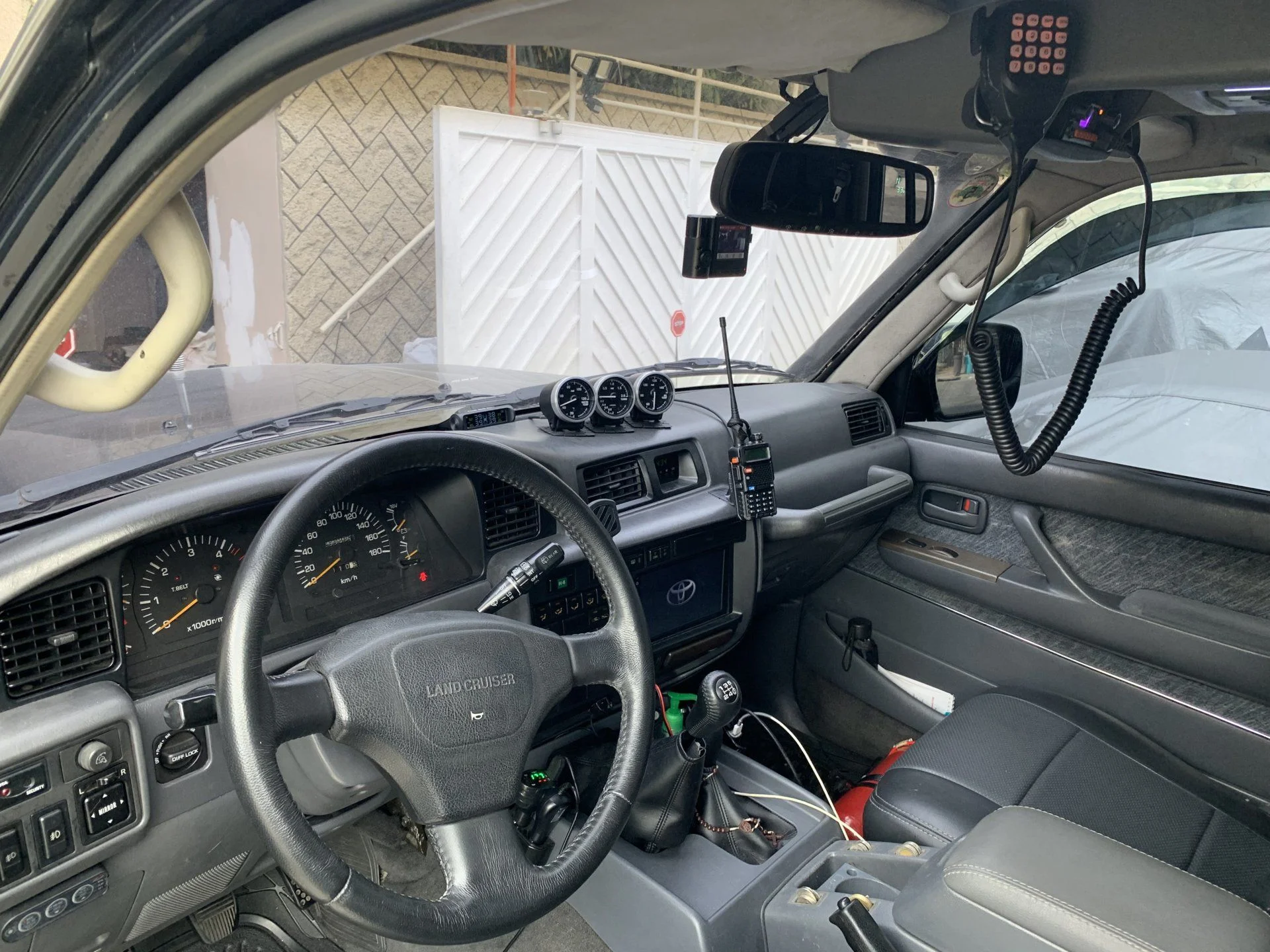

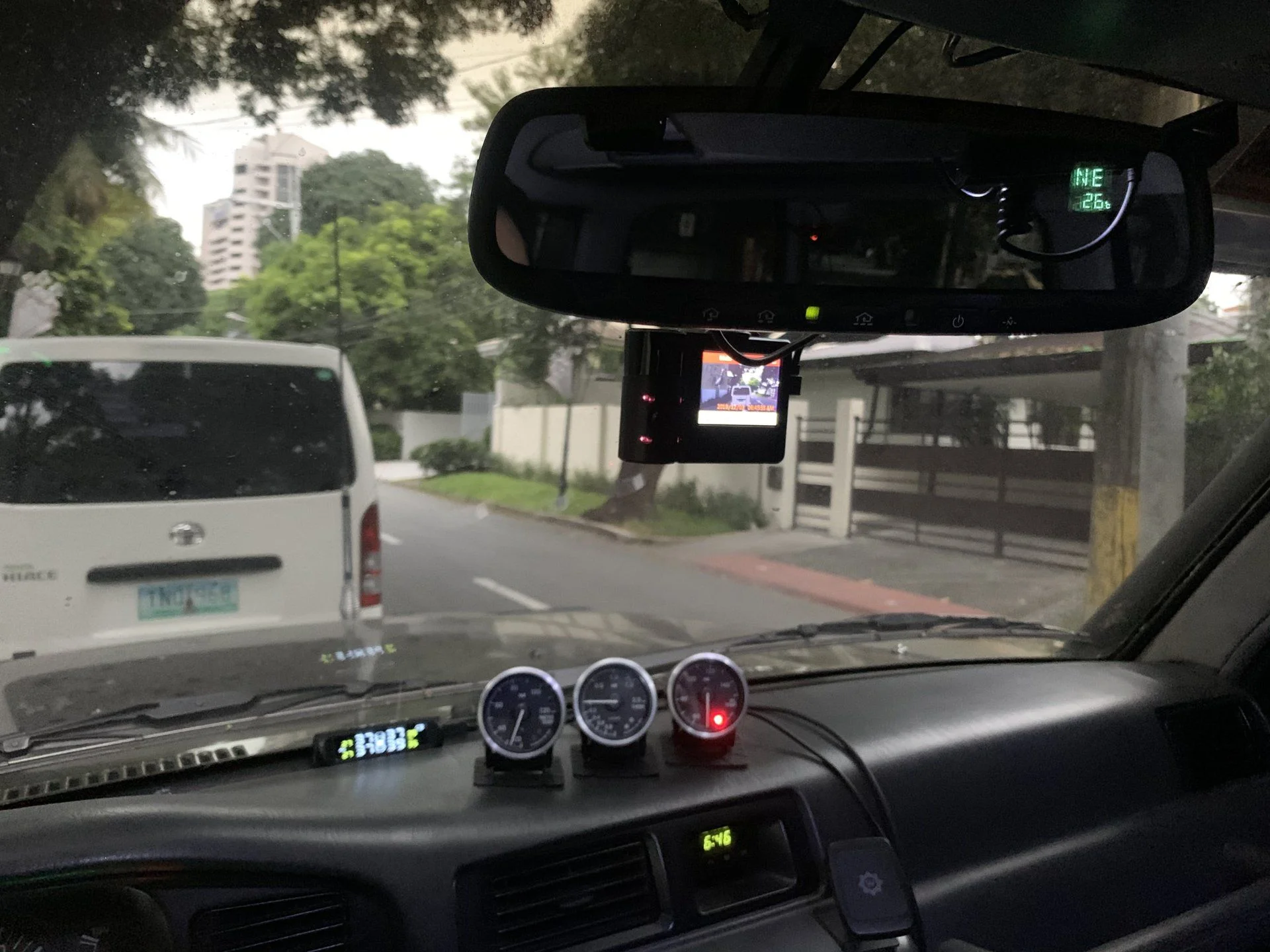

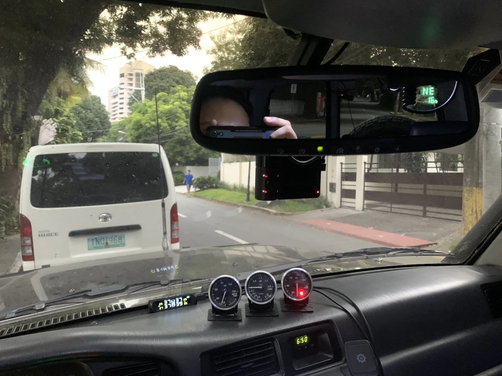

Here are some pics..

I bought mine off ebay, I believe it’s a custom Gentex 453 with Homelink and hidden compass and temperature displays. It came with a sensor and I just used my own wires to wire up the sensor. Works great.
