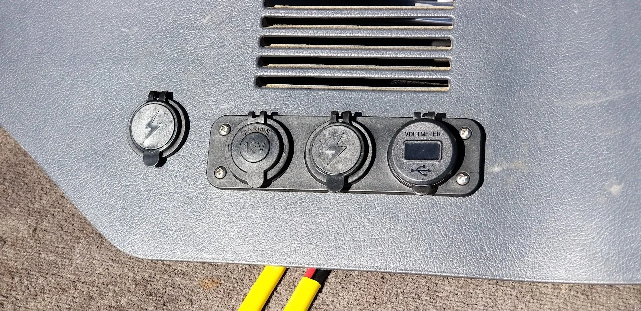

Installed on rear passenger panel
Left to right:
Dedicated dual 45A Anderson for the fridge. Constant voltage but controlled by a dash switch and relay.
Constant voltage dual Anderson for diesel heater or my smaller air compressor.
Cig lighter plug just in case. Can be used to charge my Jackery while driving.
Dual USB with voltage monitor and on/off switch to charge cell phones while at camp.
I have a new 100A Anderson for running my new air compressor that's not pictured but mounted on the same panel.
