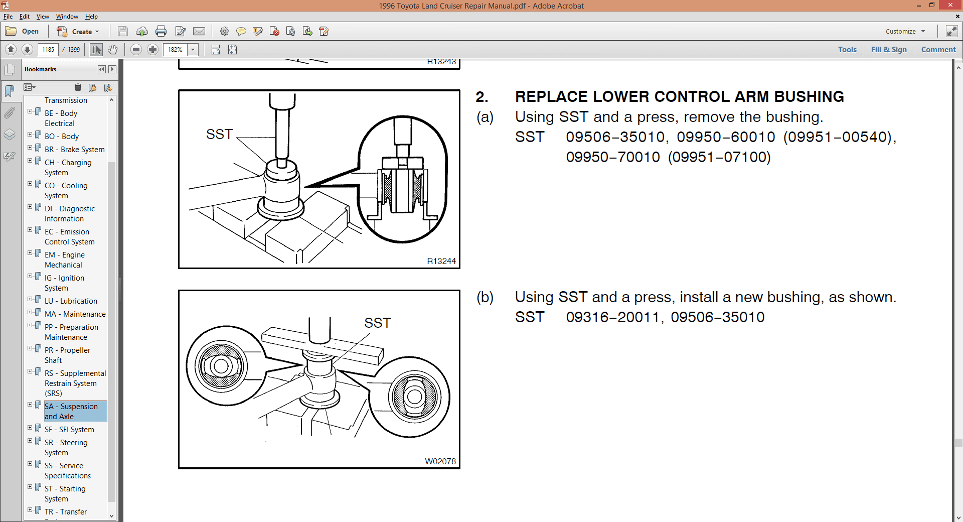

See the attached screen shot.
The front is horizontal, rear is vertical.

Excellent! Thanks for that I have access to a press but could not find the actual pictures of the orientation.
I have just found my cloud based storage of the full set of 80 manuals and was just looking through for the info. I knew the voids were bound to be wrong, I might not have been so suspicious if they had all been the same but when none of them are the exactly the same it triggered the 'am I about to install a problem?' thought.

Thanks for that you were beaten by @BILT4ME by about fifteen minutes, but the effort is appreciated, it does seem that there has been some deviation from the original setup from.t years back?
In the meantime I have contacted the Pedders agent in Spain and see what they come back with.

Another update.
The supplier emailed me today and informed me that PEDDERS agree the bushes have been installed incorrectly, so are entertaining a warranty claim however, the supplier does not have any more in stock. So I am unsure how long I am going to have to wait? If the supply from PEDDERS comes from manufactures in Australia then that could be weeks! Or there is another set somewhere else in Spain or at least nearer that PEDDERS might be able to divert to me?
