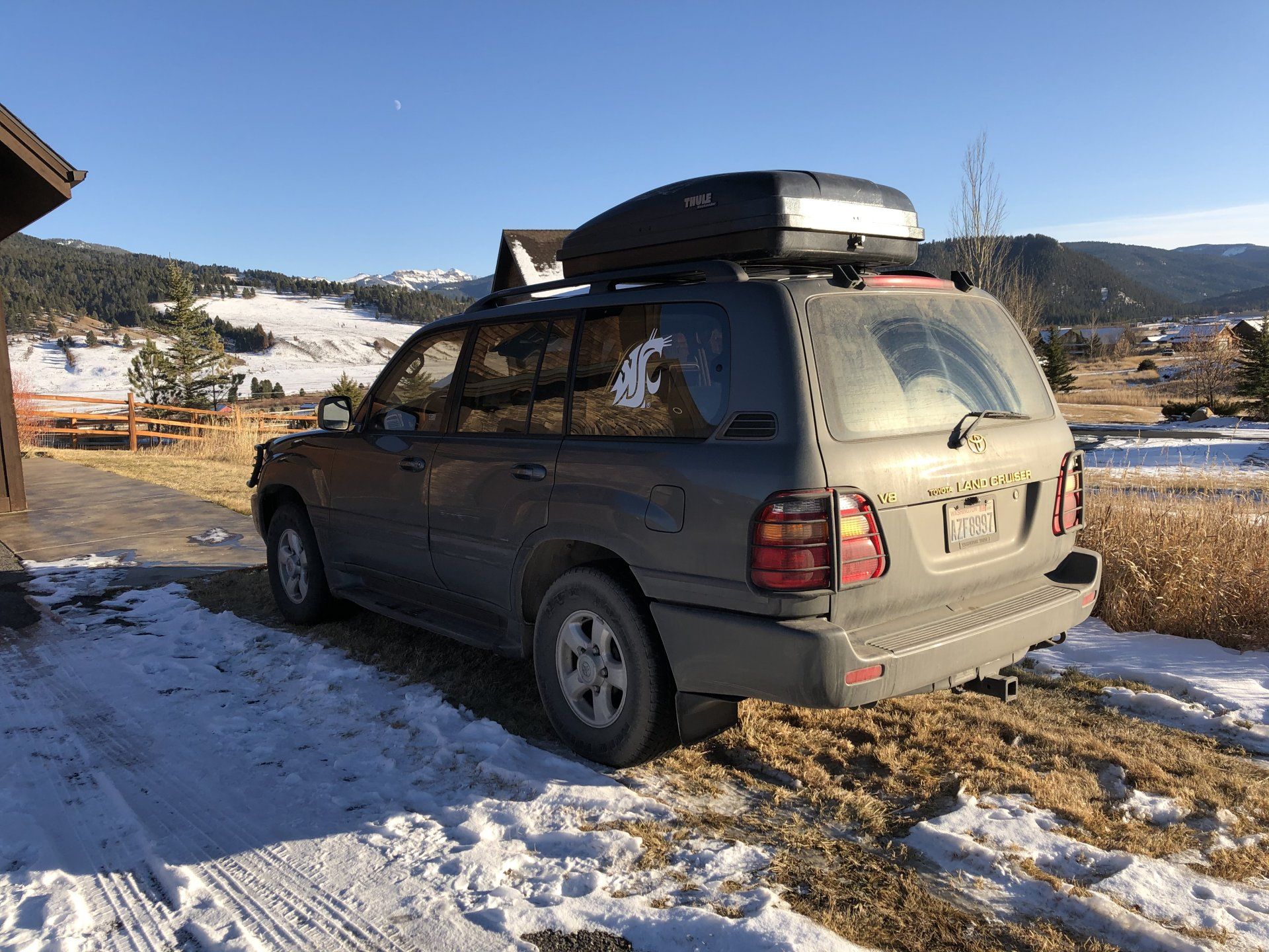

Hey guys, new owner of a 2000 Land Cruiser and so far I’m absolutely loving it as my ski car here in Montana. There’s a couple small problems with the car including my electric locks do not work with my key button, which isn’t the biggest problem (but one id like the fix down the line if possible). I have been using my key to unlock my driver door. Yet my key seems to not be able to turn counter clockwise to unlock the rear tailgate (I am able to turn the key to lock the tailgate). As a skier I’m constantly loading gear in and out and don’t want to have to climb through my cruiser to unlock the rear tailgate from the inside with ski boots on.
If anyone has any ideas on what this could be I’d appreciate any insight you could give me.
