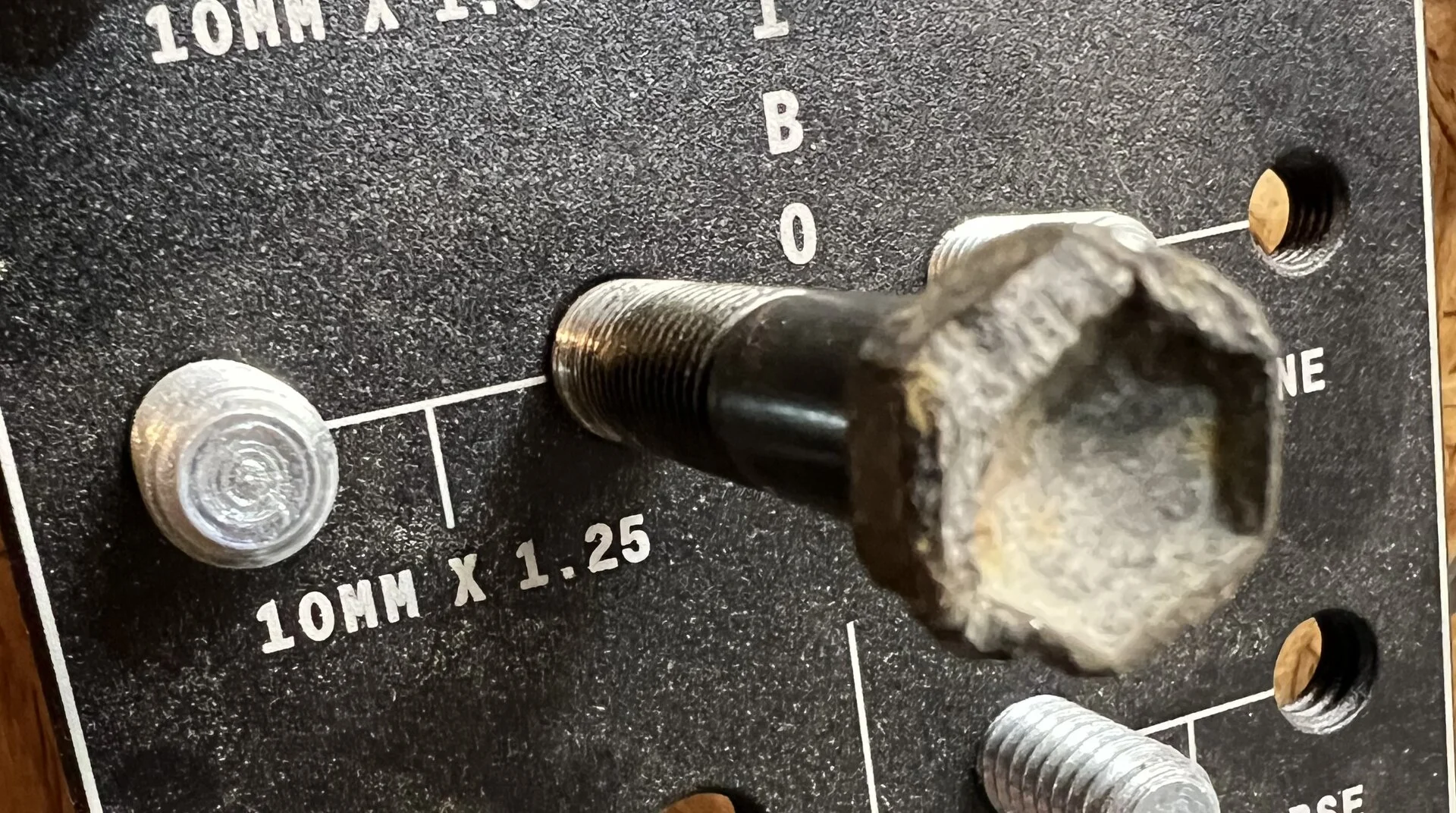

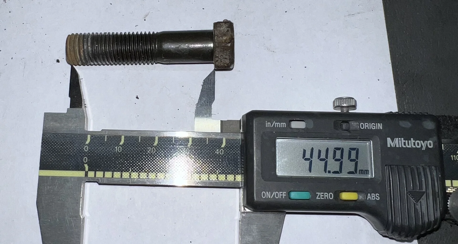

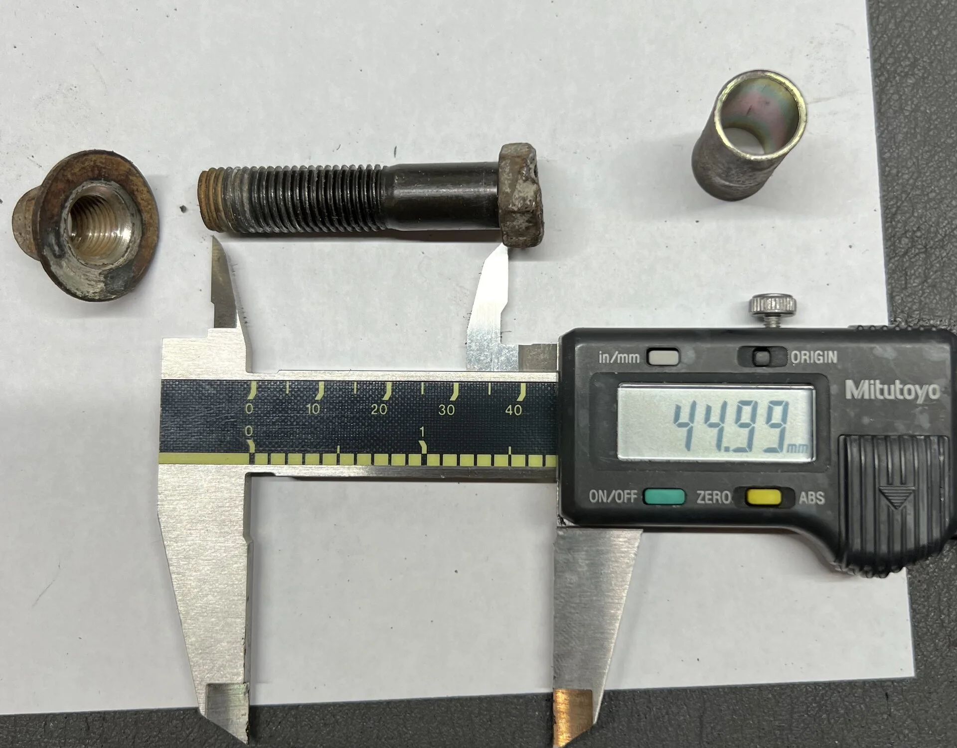

Posting info in this existing thread for future searchers. The bolt is M10 x 1.25 x 45.
