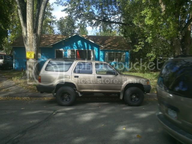

I'm curious, what's your top rim edge to fender lip measurements front and rear? I can grab mine for comparison. FWIW I can put about 500-ish lbs of gear and things barely drop 3/4" from dead level. :D
No pics, but I've had 4 people plus backpacking gear plus 15-20 gallons of water without noticeable sag. I'm sure there was some but the truck still looked level. So far I have about 6000 miles on them, 3000 of which were loaded hard with about 500 miles of loaded down wheeling. The coils haven't sagged at all.
If I remember correctly the front measures 14" rim to lip, 13.5 in the rear. It does appear a tiny bit raked like this but I don't mind. By the time these would sag I should be sas. :)
Great looking truck by the way. If I go to 33's I'll be doing the cruiser coil lift.
For the sake of the thread those coils are rear from fj80's. If possible get a pair of left or rights. They are slightly different lengths. Maybe only 1/4" but people have noticed.
