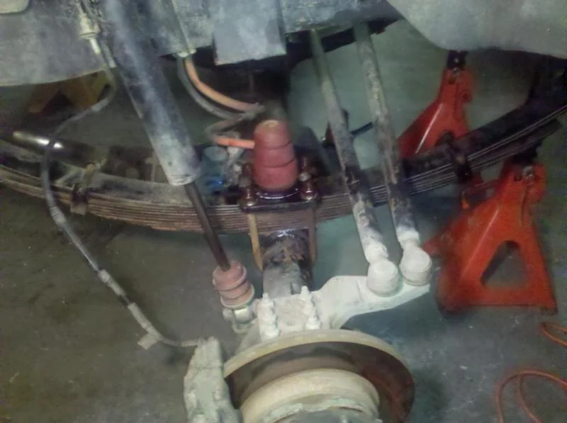

Another option is to run Timbrens (http://www.timbren.com/) or Micro-Cellular Polyurethane Aux springs. I set them up on my mini-truck, and not only does it do a much better job at taking up the bumps, but they help handle the additional weight when I load up the truck.
Sorry for the picture of them on the front of my truck, but its the only good picture I have. They do the same job in the rear.
BTW: the picture is at full droop. They are .5" from hitting the frame at ride height.
