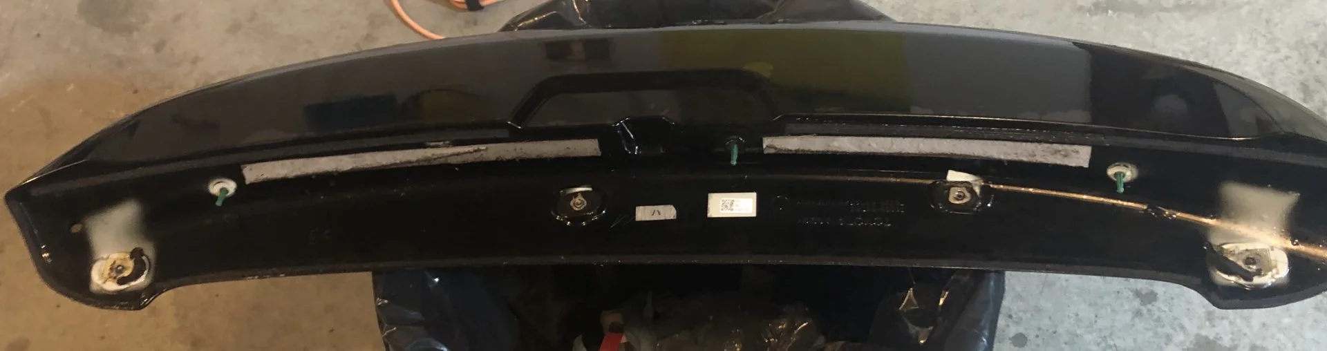

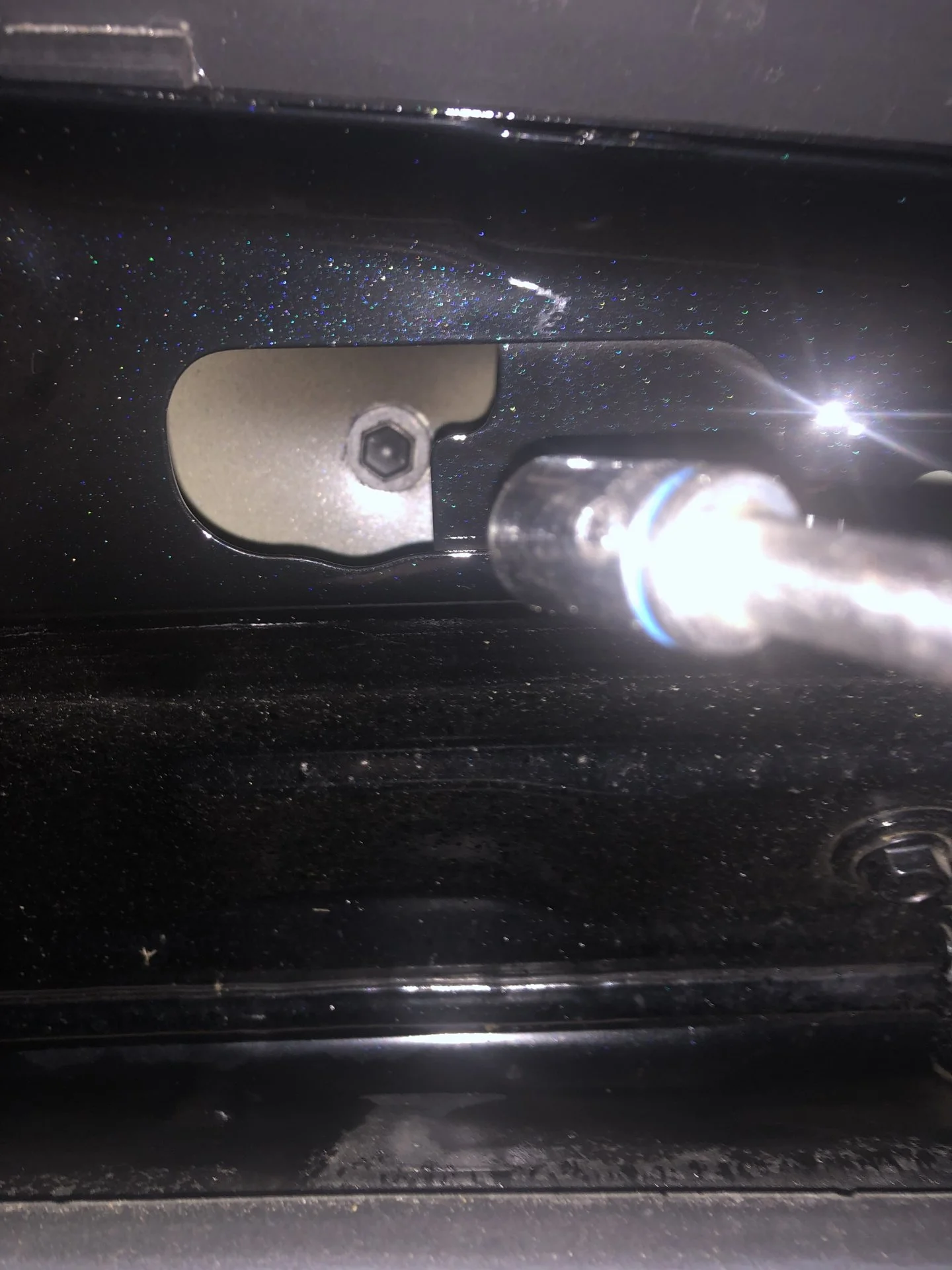

The things holding the spoiler to the decklid are four bolts, two strips of double sided tape, and three plastic pins (but these seem more like locating pins for ease of assembly). The four bolts also appear to have some sort of foam washer between the decklid and the spoiler (preventing water intrusion?).

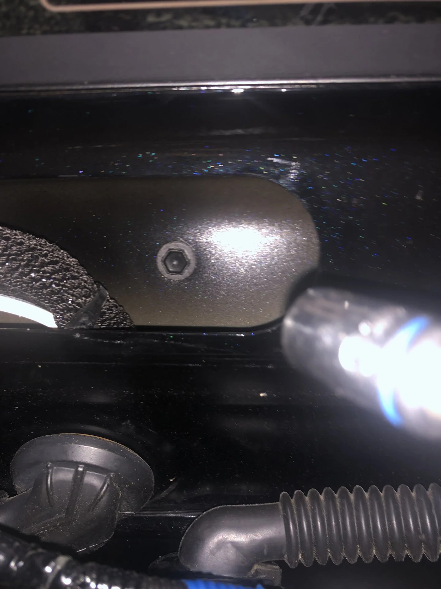

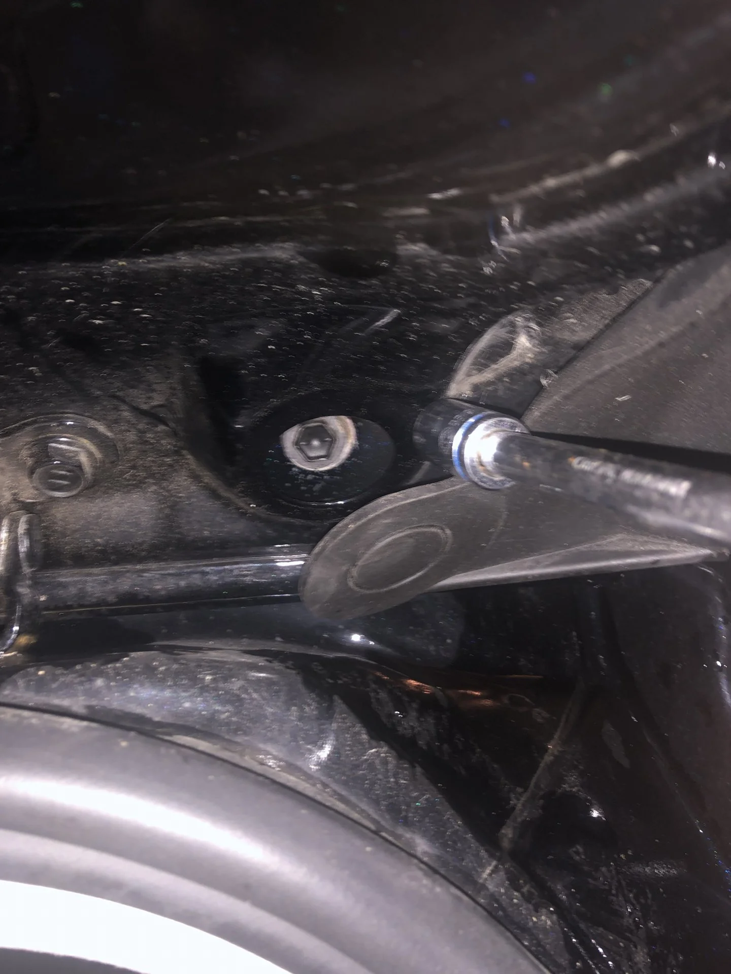

You acces the bolts from inside
the hatch - the two middle ones are visible through holes in the sheet metal, the two outer ones are hidden by rubber plugs at the corners.

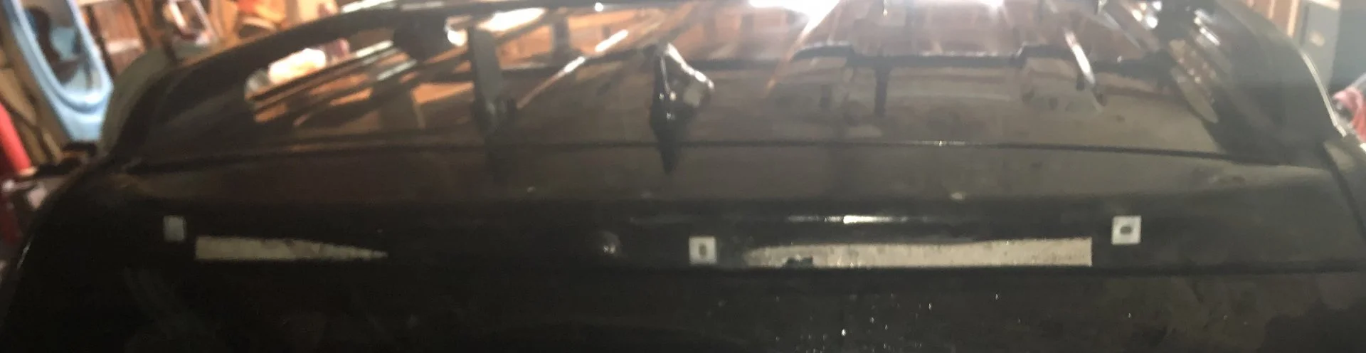

The double sided tape and plastic pins are on the vertical surface (whereas the bolts are in the horizontal surface).
The bolts have a 10mm head (and are very short).
I removed the bolts, and then tried to use a line to cut the double sided tape, not really knowing where it was. I think this partially worked, but I didn't get very far before I ran into something on both ends preventing me from cutting all the way across. I think it was probably the plastic pins.
After that I tilted it downward and pried it with my hands until I felt the double sided tape coming apart and something popping (probably the plastic pins coming out of their retainers). Eventually I was able to pull it off from one side first and then the other (pulling toward the back of the vehicle rather than upward).

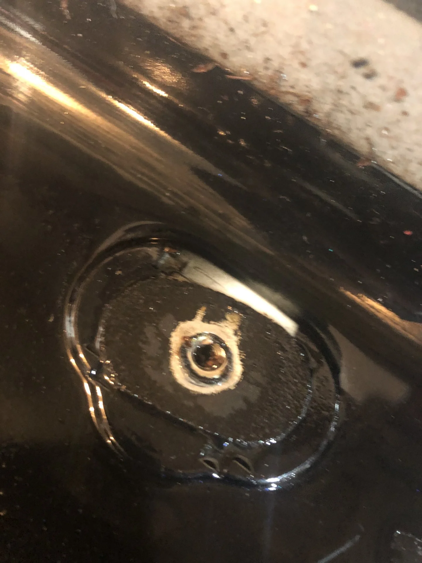

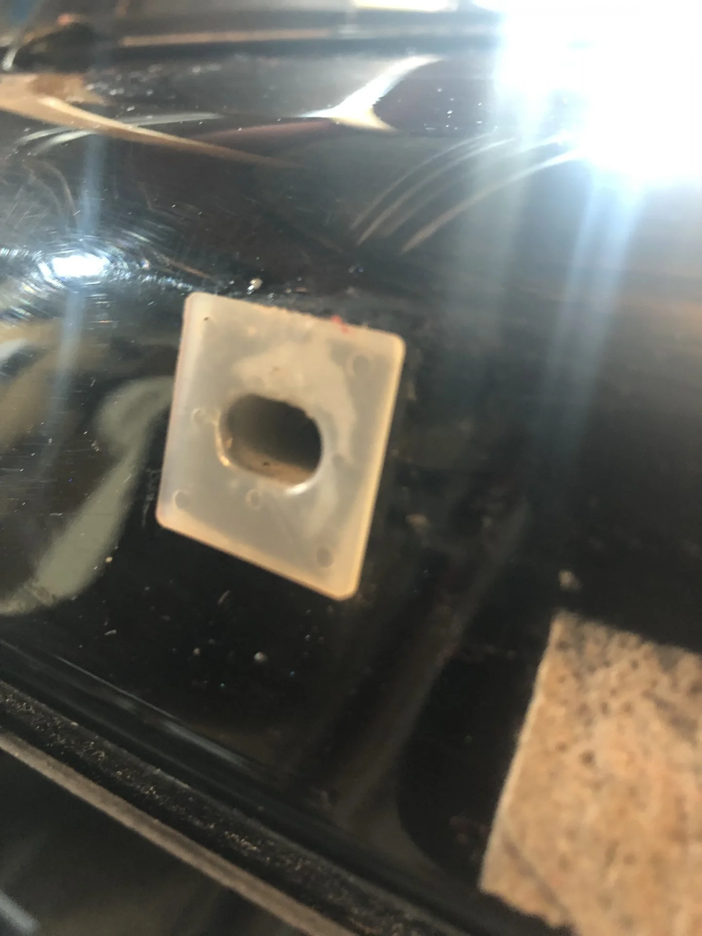

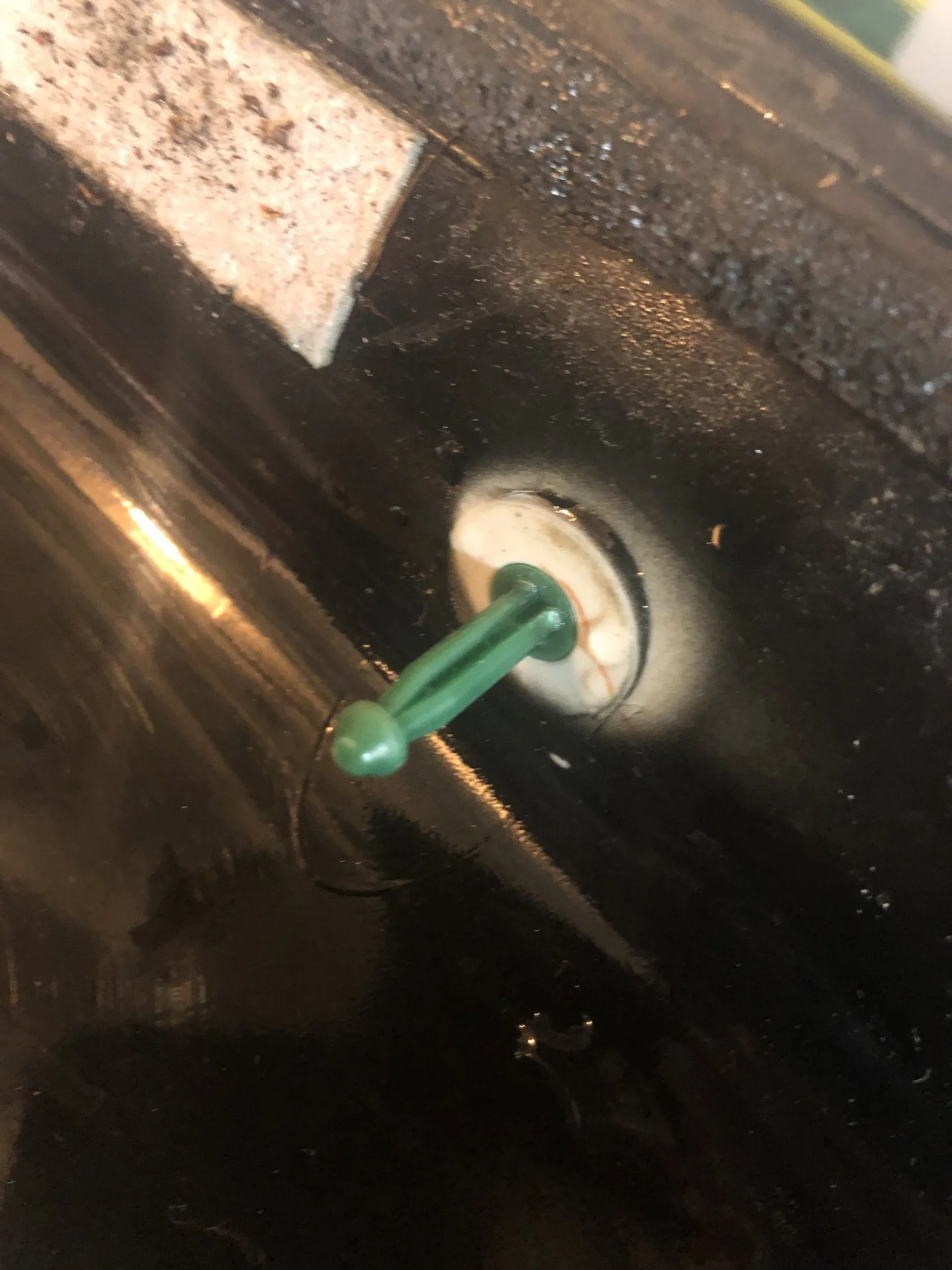

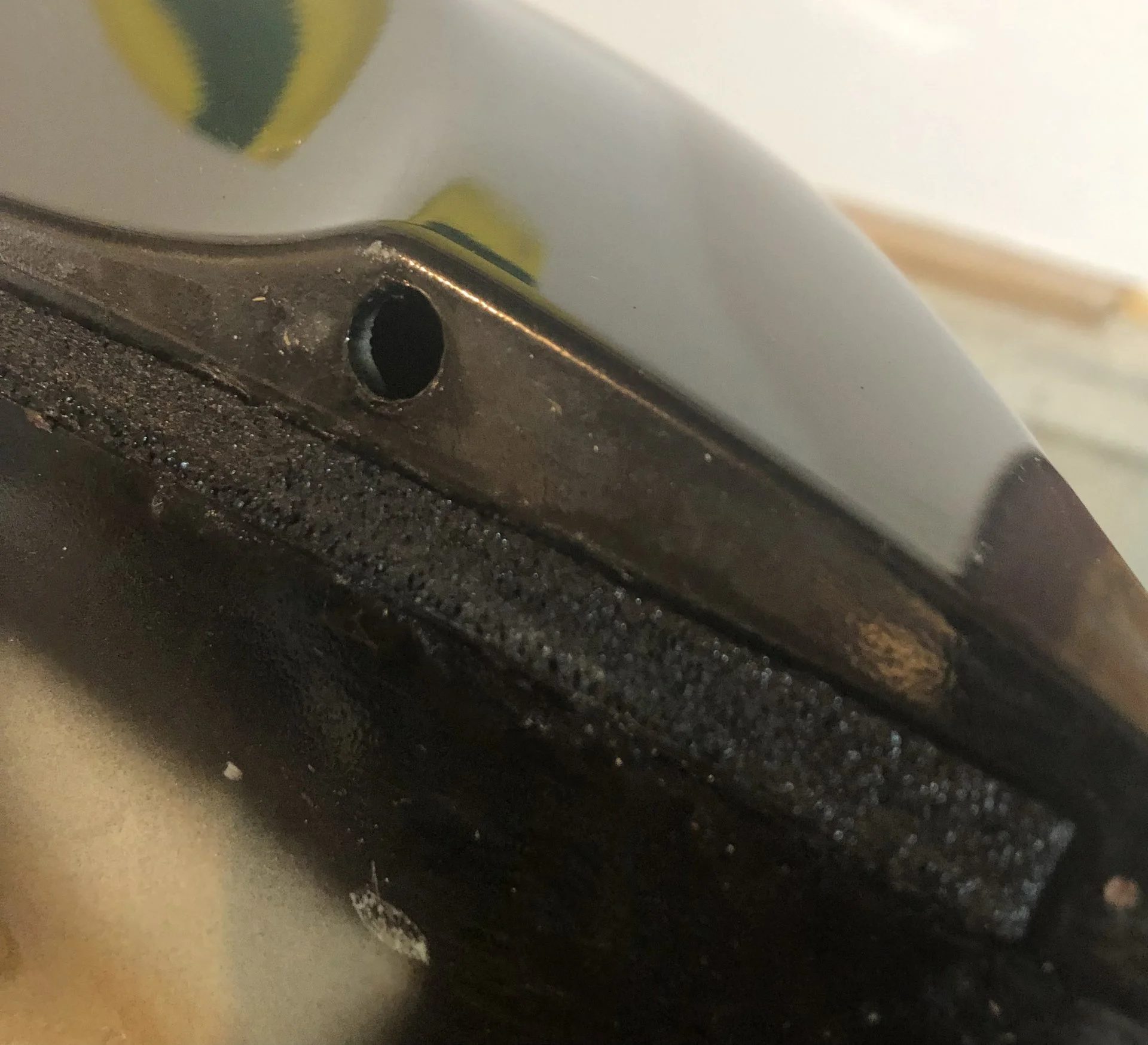

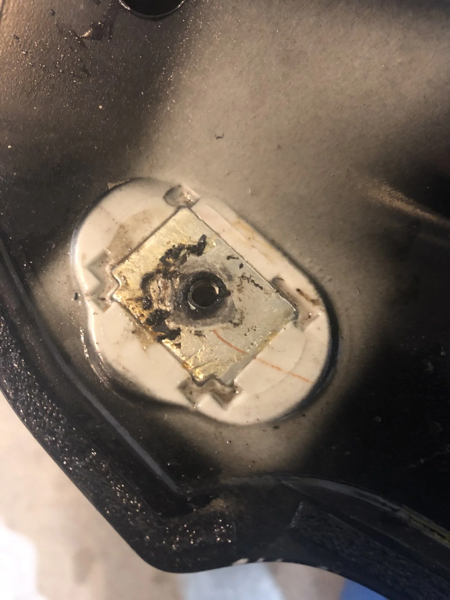

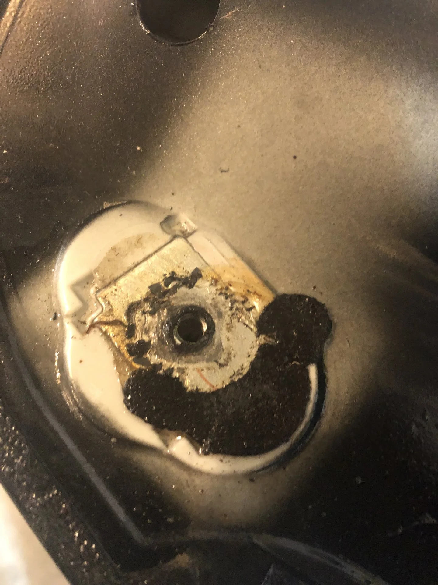

Example of one of the pins and their receptacle (there are three total). And the things around the bolt holes look like they were an oval foam seal attached to the spoiler side- but that may not be the case, the outer ones could have been mangled by my cutting, or the installation process itself.
The bolts thread into metal nut plates molded into the ABS spoiler.
Felt weather strip on the bottom edge, and drain holes at the low points. Clever toyota engineering.

I removed the vehicle side of the remaining double sided foam tape with a heat gun, friction, plastic razor blades and wd-40. On the spoiler side, I cut most of ot off with a safety razor, and am trying to decide if I want to bother doing more. I probably will go after it with a plastic blade and wd-40 since I hate doing things half way.

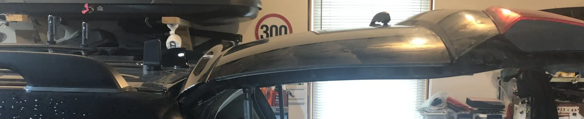

Pics with it removed? When I replaced the upper hatch on my 100 I left the wind deflector off, made the roof rack much easier to use. I'd like to do the same on this truck, although the shark fin will continue to be in the way. I can't raise the hatch without hitting anything sticking back past the roof rack right now. My rowing shell I carry often is a problem with the spoiler.

Intriguing.........If I left the spoiler off and also shimmed up a couple inches the rear crossbar of the Thule rack I use for my canoe (resulting in a bit of a rake), I think I might clear the hatch with the canoe loaded. That would be a winner!

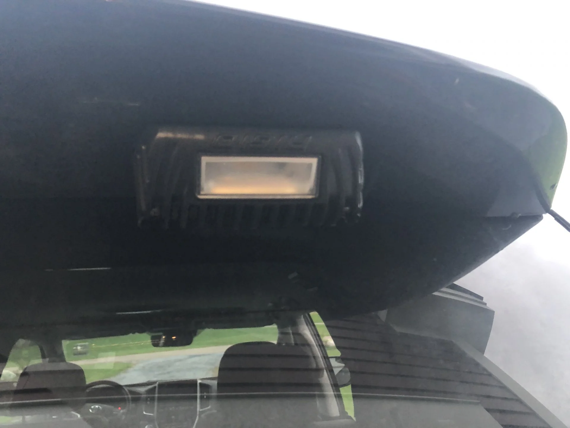

I put the spoiler back on after installing some dust/scene lights. I used clear rtv around the bolt holes and 3m double sided tape.
If I were going to leave it off, I'd be tempted to just cover the holes with 3m wrap, although a more long term solution might be bolts with foam backed washers and rtv?
install dust lights
What are dust lights? can you post a pic?
Looks like you also removed the chrome door trim pieces?
I like the rear spoiler looks and I think it adds slightly to better wind drag.. but every time a put a kayak up there I'm concerned with breaking it.
They're for visibity when someone is following you in the dust/fog or other low visibility conditions. They double as lights around camp. I used them this weekend in heavy mist/fog, and the guy following me was super appreciative.

Thanks for posting this. I just did it on my wife's 2017 LX570. Stepdaughter backed out before the garage was all the way up! Lexus part was about $1050 including shipping from Bell Lexus in Scottsdale. Repair took 30 minutes. FWIW i didn't use a hair dryer to loosen the tape--I just pulled repeatedly. that took a few minutes and getting the two middle stubby bolts back in was tough because it was tough to reach the threading. Other than that it was a piece of cake. Thanks again.
