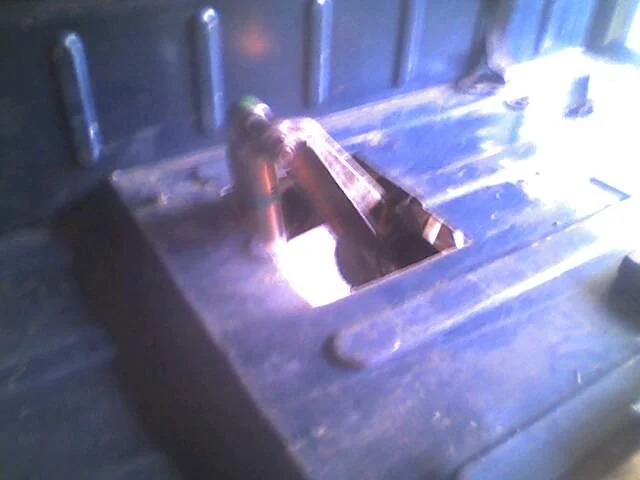

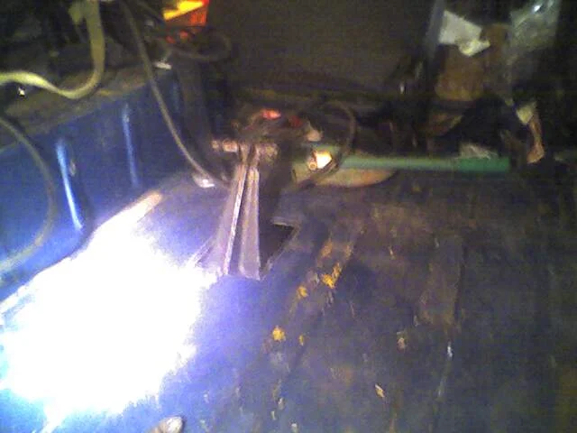

Here's what I did. It is still in the garage so I am not sure how well they work. I figure I have about 5" of up and 9" down.
Not sure how I am going to cover them. I would like to put a bench back there. I'll deal with it then.
Sorry for the crappy images.

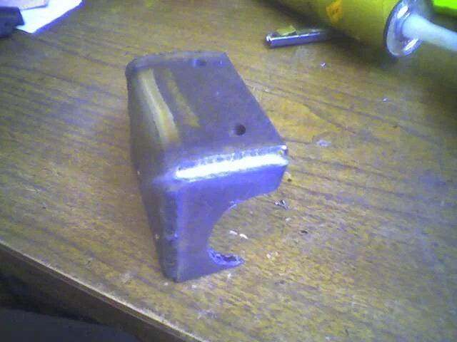

I made the bucket out of 1/4" and grade 8 bolts. Full welds on both sides at the cross member. They might rip out the wall of the cross member, then again they might not. I guess we'll see. If they break, I can unbolt the arms and build it bigger next time.
