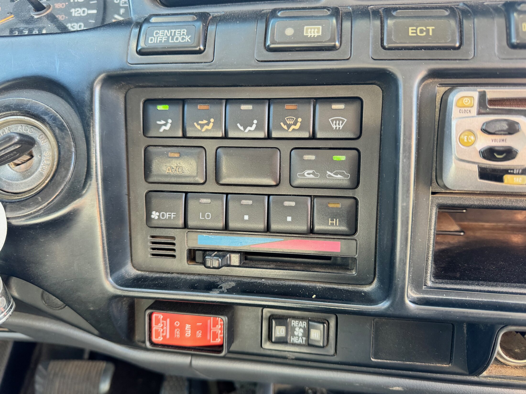

This is where I installed the switch for the Blue Sea ML-ACR.
