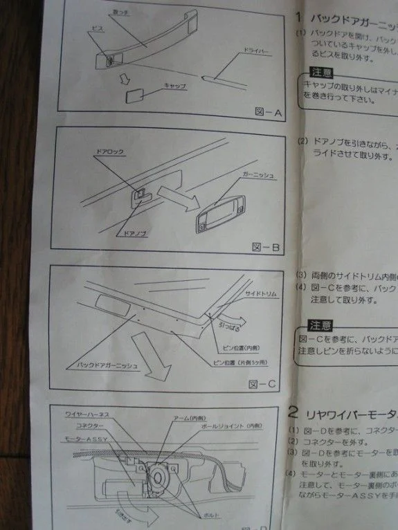

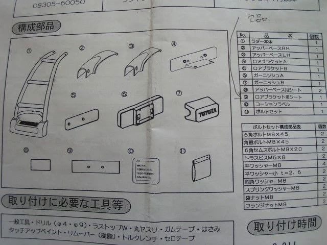

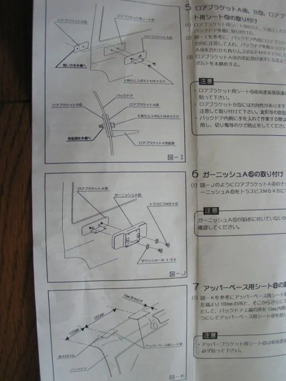

I just snapped some pics.
You can see in the first pic which part, the manual says (or the PO probably) is missing.
Don't have time now to go through it.
Let me know if I can clarify anything.

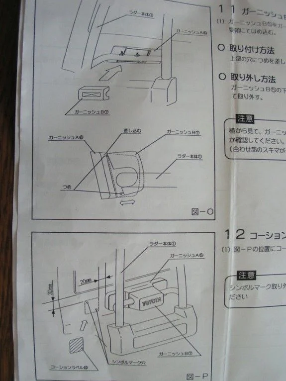

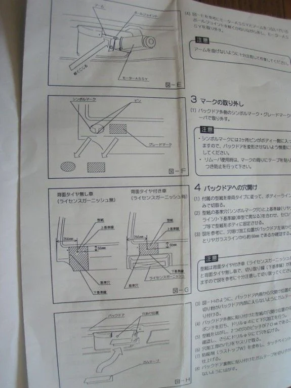

Looks like you have to remove the tailgate garnish, remove the rear wiper assembly, emblem(s), drill holes, install lower bracket A(5), B(5), lower bracket sheet (9).

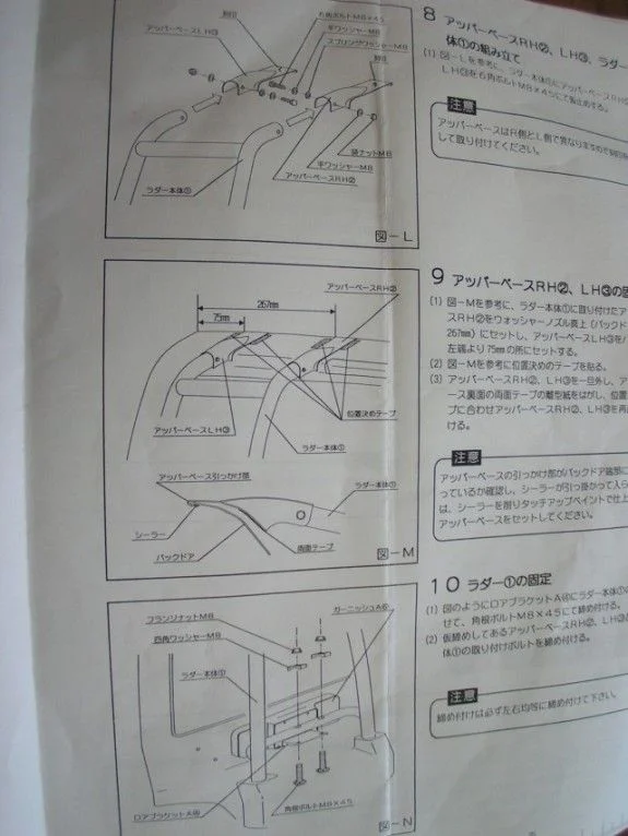

Then Install garnishA(6), slap on sheet/rubberish protectors for upper base(hooks)(8), assemble upper base(hooks) RH(2), LH(3), and ladder (1).
Stabilize/install upperbase(2), LH(3).
And install ladder(1) and garnish B(5), and finish by putting the cuation sticker.
The last pic is of the template for both with and w/o tire carrier.

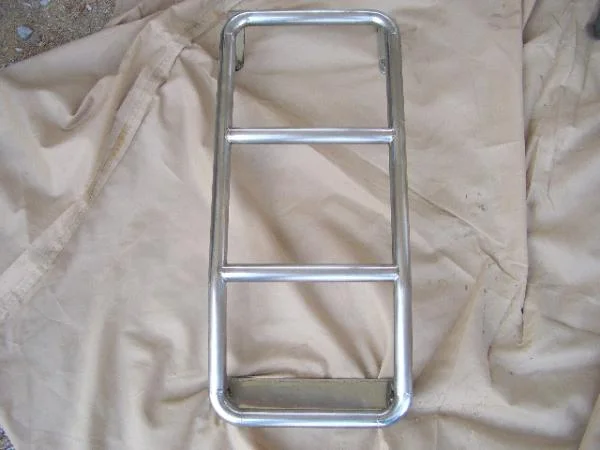

beaufort,
You must have beaten me to it deleting the pic since it did not want to load.
I do not have it/them in my possession.
The one in pic is supposed to have all the mounting hardwares, which should not be much.
I could probably get it and offer for a bit cheaper than the 100/80 ladders, since it is used. But hard to say until I get it in my possession.
I'll keep you posted if I go after it. ;)

I'm interested, so keep me on the list. what was the 3rd pic?
I will!
The third pic was the one for the barn door (I couldn't get it to load for some reason).
