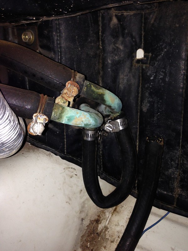

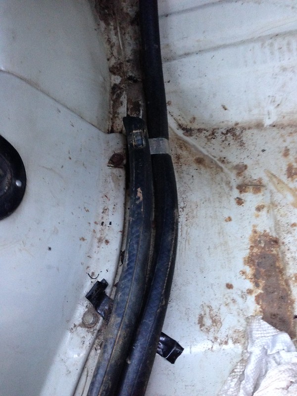

Here is my line. The issue is that the rubber end where it meets the copper pipe failed. It split. So I figured I'd try to bypass it. But now I may as well fix it right. These are all rubber, no copper in the middle. Being a 1-owner vehicle, I seriously doubt the PO even changed these. So I am guessing they are original?
chris- nope, I appreciate the suggestion. If I lived further north where heat was more of an issue, I would look for a better solution.
I cant get myself to put in hose Mike, green wont match :) I guess I need to see if I can find some high temp rubber- maybe mcmaster carr as some.
