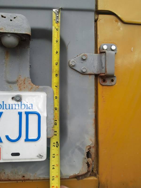

I get 15 3/8" from that crease midway down to the bottom.
That's with the dumb end of the tape slid up and jammed into the crease...if'n you follow that.
When I eventually get around to doing mine, I may adjust that length a smidge to fit my tub better. My rear sill is likely a little different from stock.
Might want to do a test fit before going too crazy with the zapper, those old aqualu tubs had some variations...maybe before they got the shop properly ventilated :lol:

well, stock plus rust..:lol:
I measured to a spot that looked original tho.
