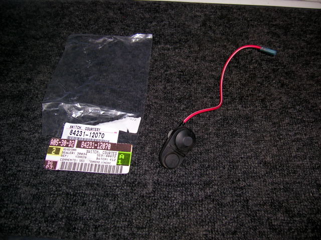

OK, I am new and this is an old topic. I still have not been able to find a definitive thread as to why these switches fail.
I ripped mine apart and clearly you have copper (spring contacts) that need a good connection with a steel (dissimilar metal will corrode) tab that is part of the switch base. So yes cut off the three plastic "rivets" and scrub the steel tab with sand paper (along with all the copper parts). Adjust the springy contacts by bending them outwards and reassemble. Rear door lights work again and the switch is "modded" (plastic "rivets" removed) for the next time service is needed. BTW don't bother disconnecting the wire, I did it with wiring attached.

I cleaned mine a couple times only to have them last shorter and shorter each time, so I finally broke down and ordered them new from CDan. Very inexpensive and should have just bought new ones the first time.
x3 I had three that didn't word consistently. One just failed in the middle of the day, without anyone near it. I know this because the alarm went off when it received the signal from the right rear door switch. Replaced all the door switches when I added George's LEDs. 1/4 :banana: job. It's so easy Toyota will actually give you a banana when you buy the switches.
It is a whole new switch you hook up the wire and bolt on. And you're done.
Read door switch bought from CDan

This will just fix the dome light not coming on. Some have successfully taken the switch apart, but for the price of a new one, It was just easier to replace it.
