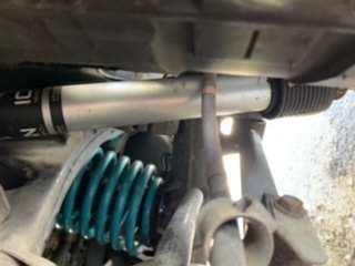

my setup is Icon 56550 extended travel rear shocks 17”/28.5” and Dobinson c59-675v rear coils that put me at 23.5” hub to fender in the rear. Proforged sway bar end links for extra 1” length. awaiting offset and extended non-adjustable rear lower link from Resz Fab.
The bottom of my bumpstop is at 3.5” to the axle using the “Measure” app found in the utilities folder on my iPhone XR.
Edit: Using a ruler, the actual distance from the axle to the tallest side edge of the bumpstop rubber is 3 7/8" (almost 4"). This is after the conversion to extended travel coils and long travel shocks. This is measured while sitting on my driveway with an empty gas tank and the third row seats removed. So, less than empty rear and hub to fender was at 23 5/8".

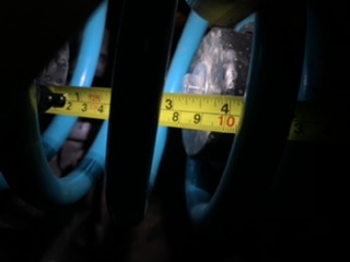

I just realized that there’s not much discussion on the rear upper spring cone isolator acting as a bumpstop inside the spring. I just measured the distance from the bottom of the upper isolator to the top of the coil puck inside the spring and it’s less than 4”.
So, it looks like we have two bumstops: inside the spring and outside the spring.
In my case, both areas are under 4” to make contact and act as a bump stop.

I ordered training hockey pucks for $3 each to install inside the bottom rear coil. This is to shorten the distance between the bottom of the isolator and the top of the coil holding metal puck by 1”. I’ll be at under 3” after installing training puck.

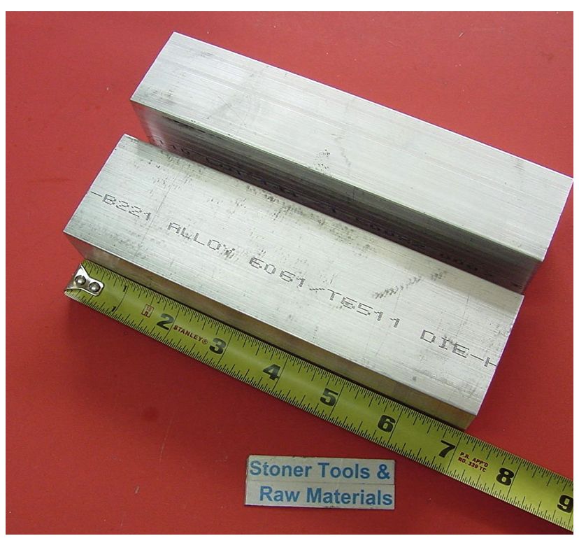

And I’m looking to build my own DIY bump stop extension aluminum brackets using 1.5” x 2.0” x 7” aluminum flat bars $28 total for 2. Drilling holes and attaching to my stock oem Gx470 bumpstops. This will leave me with about a 2.75” gap between the bumpstop and the axle.

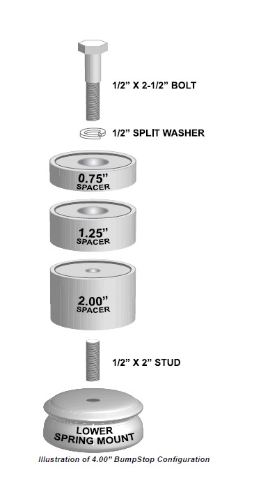

Just get a real bump stop and don't make a hard job of it. OEM 4Runner. Wheelers Super Bumps are actually nicer. Then use a strong bump extension to tune it to your specific shock length. That is why there is no universal option. Everyone makes different shocks with different collapsed lengths.

Just to clarify, if using wheelers super bumps with MT LT rear suspension and MT 3” bump stop drop, you should ditch the super bump mounting bracket and just run a 1/2” spacer between the super bumps/MT 3” drop?
Trying to get it tuned properly as it seems to bottom out prematurely and ride quality has suffered quite a bit. Plan on ordering a couple spacers from wheelers to get it dialed in before we start wheeling this summer.

I went out to my driveway and mesaured from center of eyelet to base of stem using a string. The distance measured 21.5" long. Per spec, my ICON MT LT rear shocks are 17" compressed. So, it looks like I have 4.5" before the shock bottoms out.
The distance from the stock oem GX470 bumpstop to the axle is about 3.75", so you would think I'm good even if the stock oem bumpstops were to compress about 3/4".
Also, the upper isolator is under 4" from the base coil mount. So, both the bumpstop and the upper isolator will make contact before my shocks bottom out. I'm not sure what a safe gap would be, but at least both items will hit prior to bottoming out.
