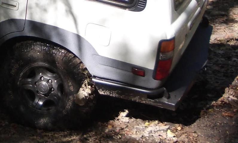

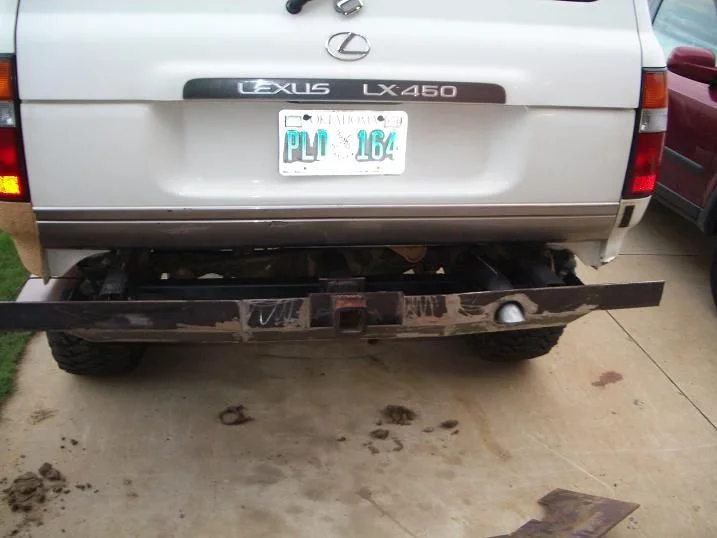

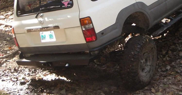

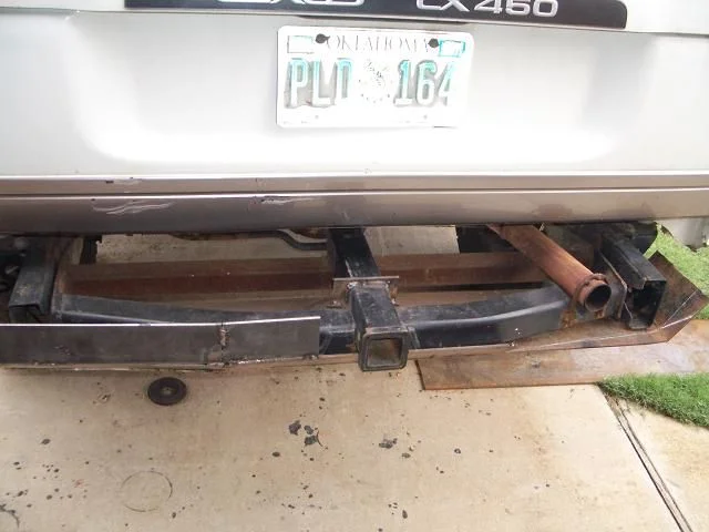

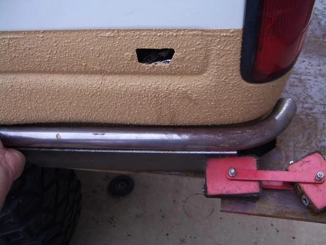

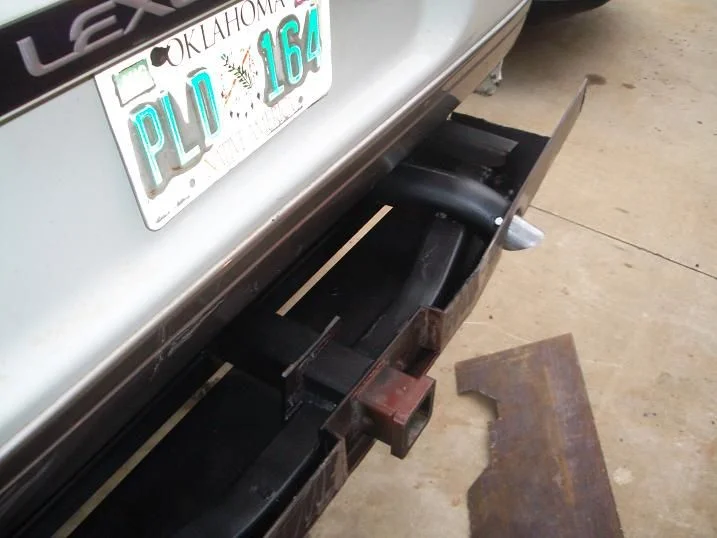

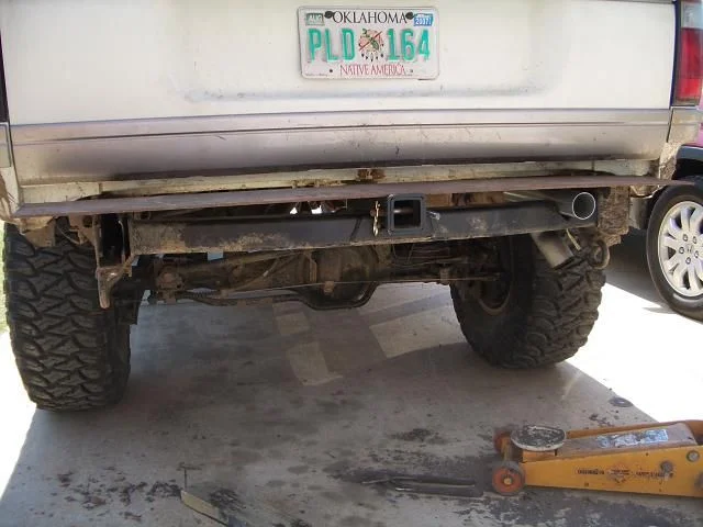

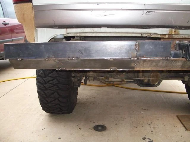

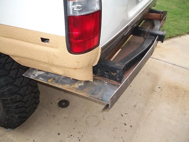

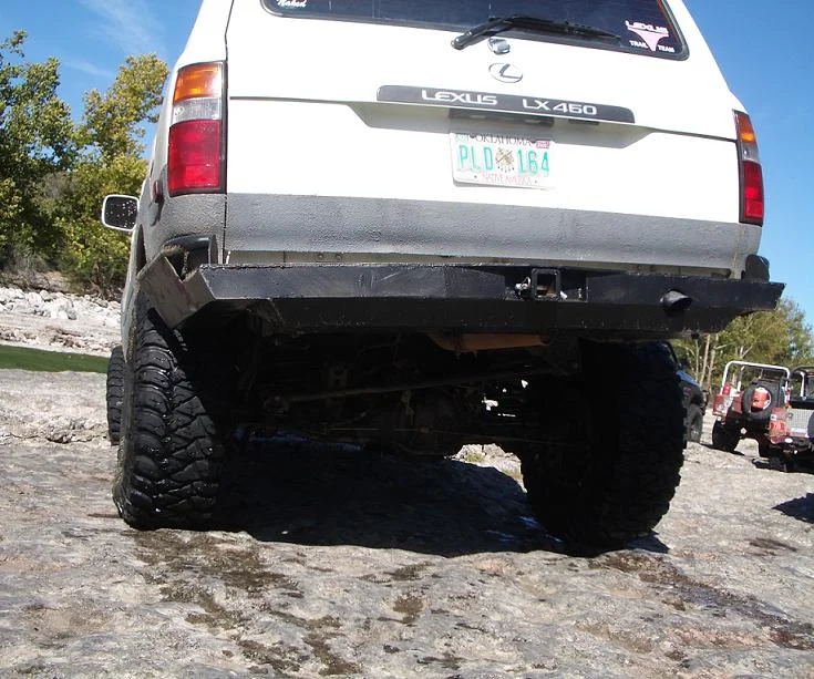

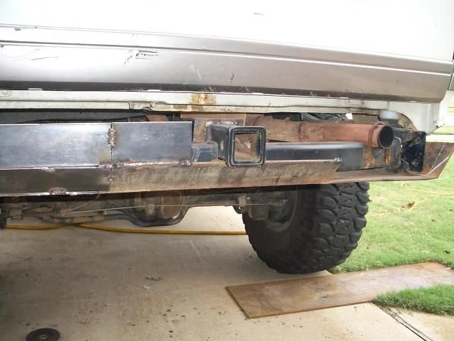

Some time ago I started on a rear bumper. It started after dragg'n the hitch one too many times. I took the rear bumper plastic crap off, did some looking and figguring, and cut the rear cross member and flipped the hitch. Flipping the hitch didn't 100% work cause it hit the tailgate when it was down. So I cut out the reciever part and sunk it into the crossbar. Added a 2x2x1/4" cross bar to support the reciever better than stock. Cut a notch to route the exhaust through what would eventually become a bumper.
