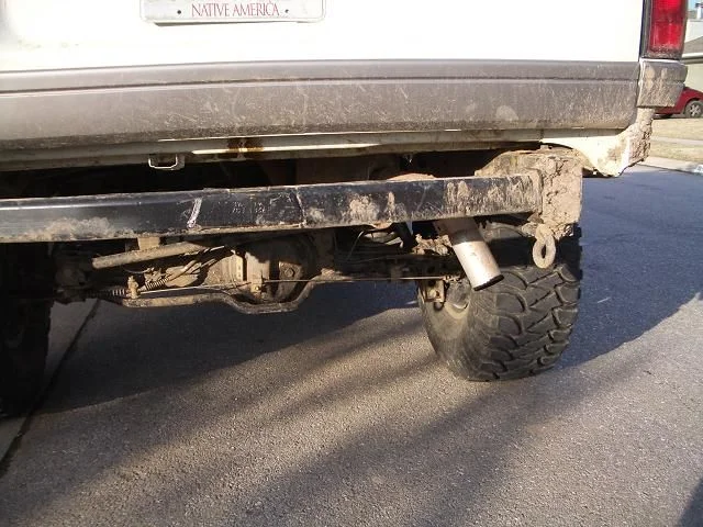

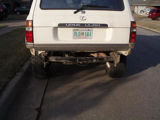

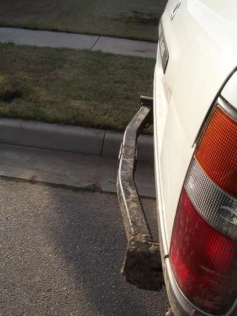

Mine is set back like in Lukes bumper.
https://forum.ih8mud.com/showthread.php?t=150024

How do I know all this for sure? I did it last weekend. Just haven't posted any pics yet. I started out just taking the hitch off for clearance. Then I decided to just take the bumper / plastic coverings off. Then I looked at it closer and decided to cut the rear cross member out and flip it. I thought the reciever part looked high, and when I opened the tailgate and slowly lowered it, it indeed hit. Could have just cut the rear part of it off and as long as the drop bars were short enough it might have been o.k., instead, I decided to go ahead and cut the whole reciever box off. I picked up a 24" one at Atwoods, and will be mounting it about 1/2 way through the hitch, with boo-ku bracing. I also realized that the routing of my tailpipe is such (not stock) that with just slight modifications, I'll be able to make it come straight out the back of the truck.
I'll take some photos of it tonight and post them up. I plan on using this as the starting point of building my own rear bumper.

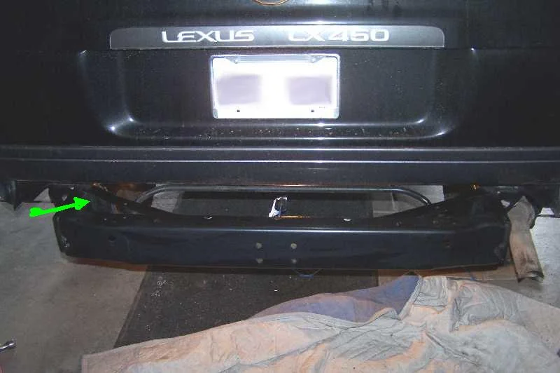

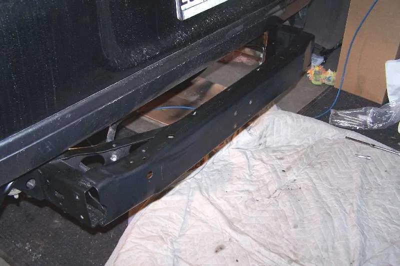

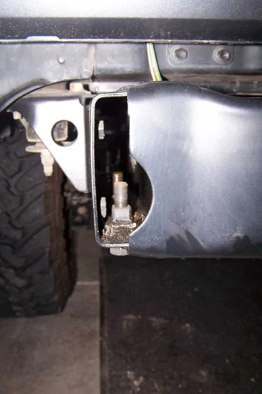

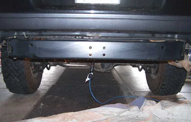

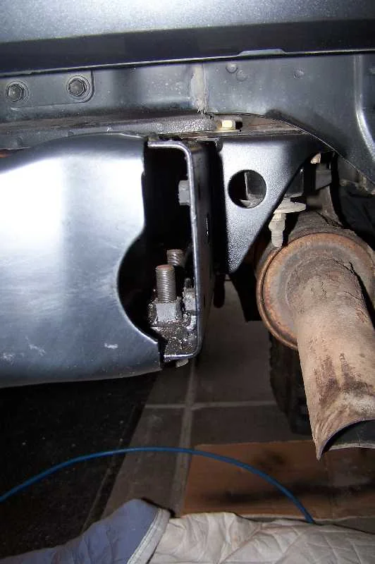

Some pics with the rear bumper off of a '97 LX450...Shows the rear crossmember for those that have never had their "bumper" off and are wondering what is behind it :cheers:
View looking into the DS and PS frame rails - You can see the bolts that would hold the hitch (removed before pic) and factory tow points to the frame rails.
Excellent shots - thanks to both of you.
