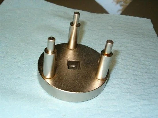

does anyone have a good source to buy the sst
the local stealership wouldn't sell me one and told me to try snapon
i made a butch one to get the job done but i would rather have the correct tool
Funny you ask, I just got mine from Dan today. Call him up, Im sure he still has some. Part No. 09509-25011
Does anyone have a picture off the sst?
There was a thread a few years ago with very good pictures of the SST and a wide variety of home-made tools to do the same job.
Try searching and let me know if you come up empty. I can probably find it with some time. Use the p/n supplied above. Maybe "OTC rear bearing" or "SST rear bearing" or something like that. Limit your search to the 80-section.

Here are pics courtesy of dclee via Cruiserdrew's post.
attachment.php
attachment.php
attachment.php

Took me whole day to dissasemble just one side I had to build that sst tool for bearing nut. :rolleyes:
