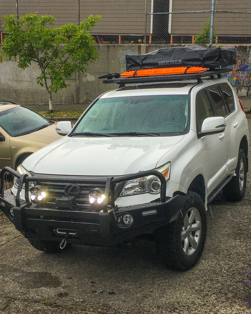

swimbody - Agree with the posts that suggest the truck doesn't need a full platform rack to support a RTT. Good bars are plenty - and a positive to keep roof weights in check...
Similar to the Rhino Rack system, I'm running Yakima (Australia - Prado 150) towers with HD bars that connect to the hard points (removed Lexus flush rails) currently.
Last summer I ran these towers with the Yakima Lock N Load platform and an RTT.

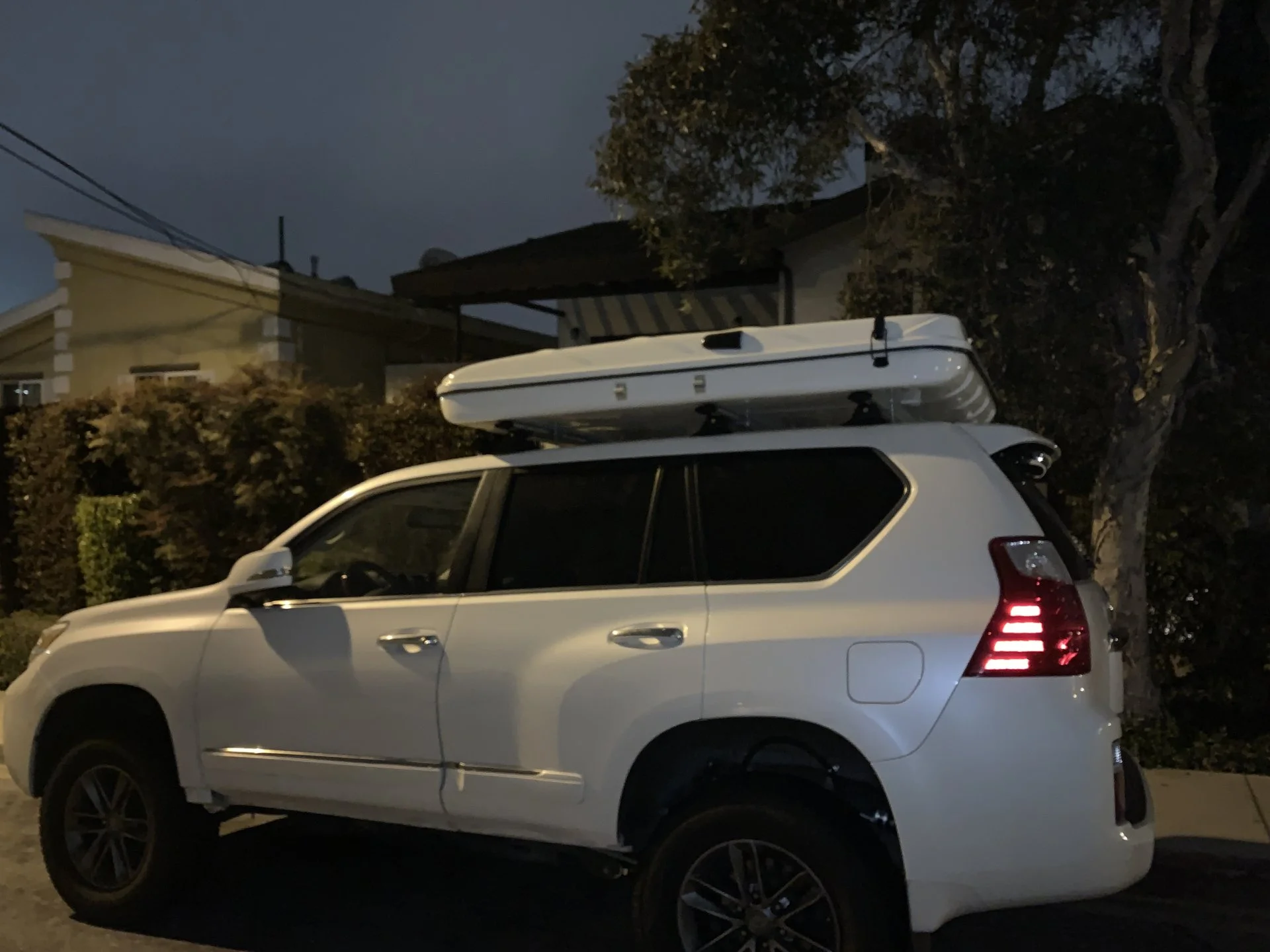

Still lov'n our iKamper RTT after over 4 years.
We spend anywhere from 6-12 nights/year. More pre COVID and hopefully more now everything is settling down again.
Our iKamper is very comfortable, many times faster to setup/tear down than a ground tent. It's also way warmer because the wall material is a much heavier fabric, the hard shell on inside has quilting, along with being off the ground. And not having to get these old bones up from off the ground, I just swing my legs onto the ladder and climb down from a sitting position.
Only real downside is if one is base camping for several days, with some trail exploring during the day, you have to always close it down for the day for your adventure and then pop it open again at night.
But in short my wife and I love it and as mentioned above may opt for a small light adventure trailer to put the RTT on.

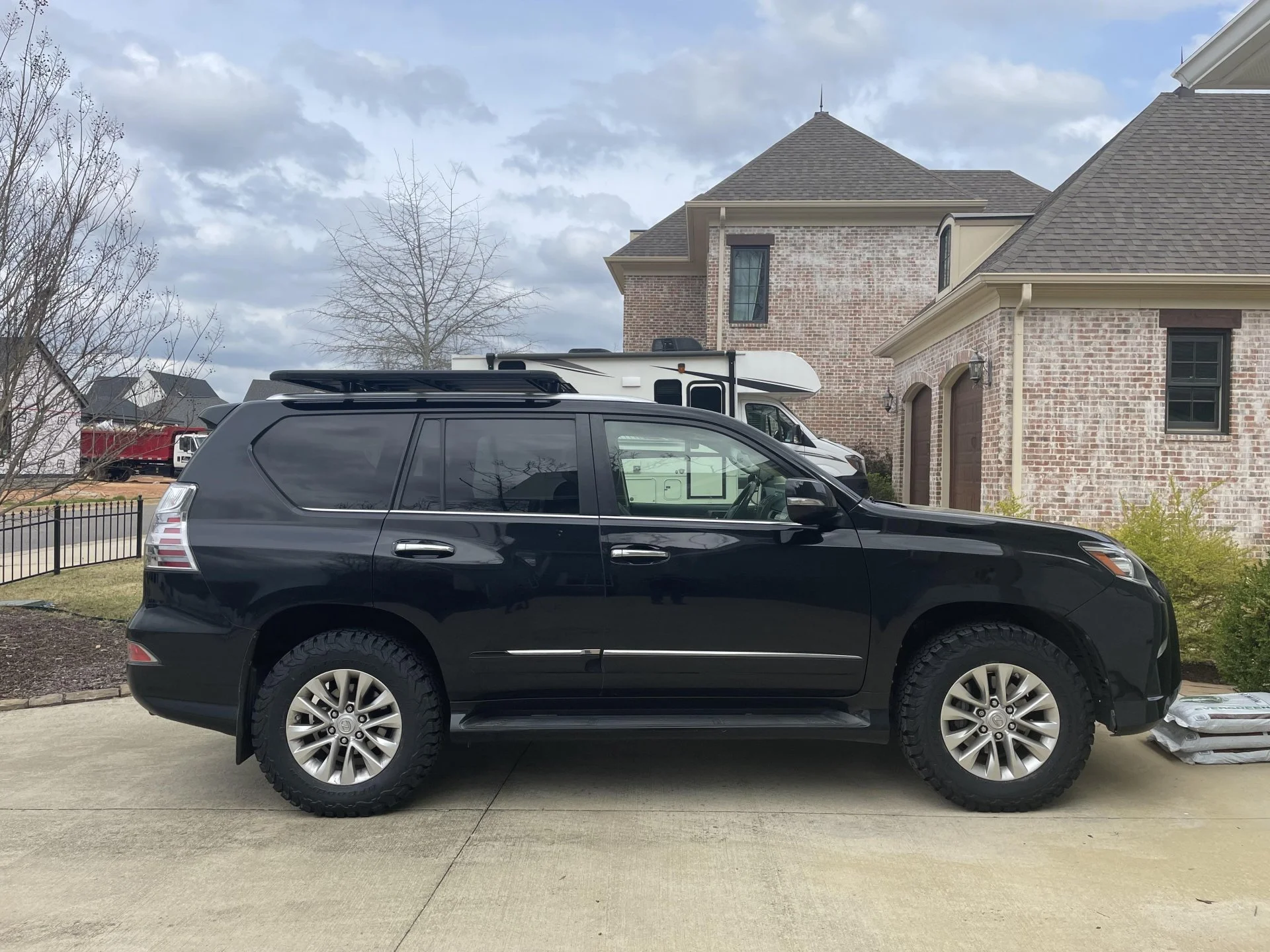

Well folks, I Installed the rack this weekend. Installed the wind breaks as well as it's beyond necessary. Drove it 4 hours to test it out visiting a friend's lake house. Was a little noisy but that's what that killer stereo in the GX is for coupled with Ozzy's Boneyard. Mamma and I were a little on edge at first with the new noises for the first 5 minutes on the interstate, returned home and installed the wind break... but I checked it three times on the drive to confirm proper installation. I really took my time to lay everything out before install, went very slow and in about 4 hours it was all up and it looks great. I got a 25% off coupon for Spring Camping over at Ironman 4x4 so I purchased the 150lb Nomad 1300 hybrid.
I am also installing an electric hoist system in the garage over the door (I have 2 ft of clearance in my new house...score!) to quickly remove and attach the tent for trips. The wife is OVER THE MOON HAPPY about the system. That 1300 Nomad only cost me $2100 with everything, tax, shipping, etc. It will be here sometime next week and should bother the crap out of me on our first trip with the hit in gas mileage, noise, etc.

For both HD cross bars and full LnL platform, cross winds seem to create some wind noise.
The LnL platform is robust, but in N config it is pretty heavy (near 100lbs).
I'm still tinkering with how I'll do a roof load... A full platform certainly overkill for all known RTT, but like having flexible rack space for other items.
The big step in my (limited) experience is removing the flush rails, and using the three sets of hard point mounts. Rhino may have the more accessible approach there (prado 150)

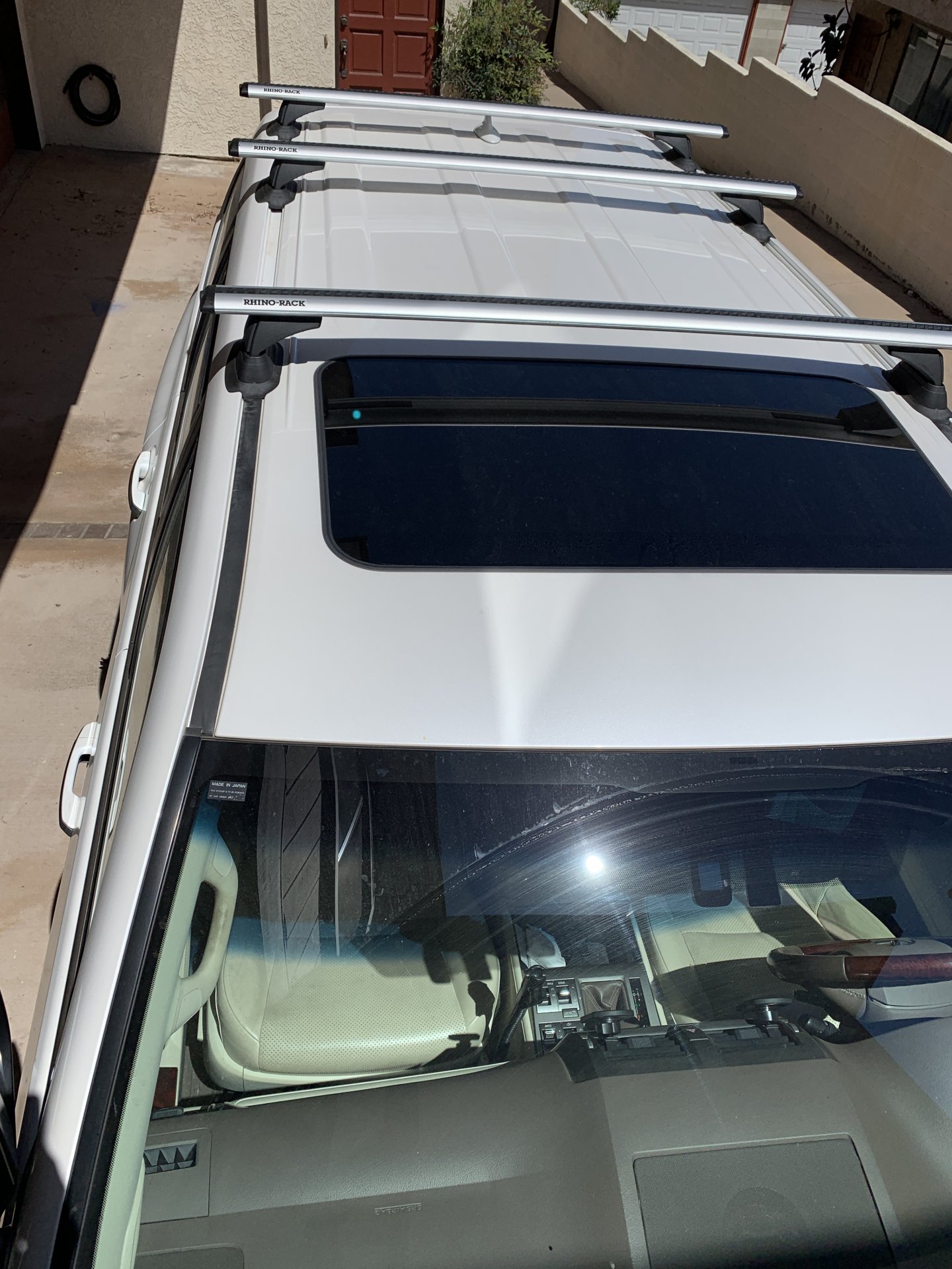

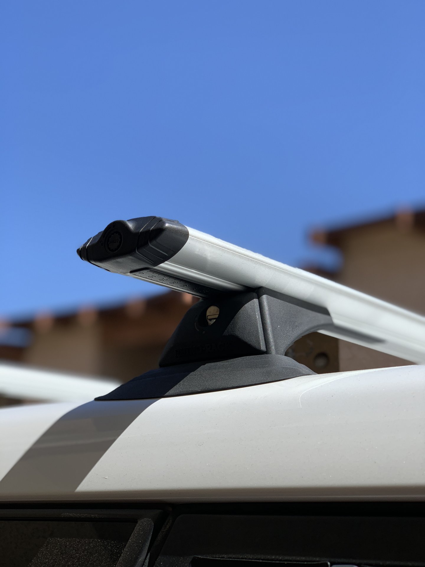

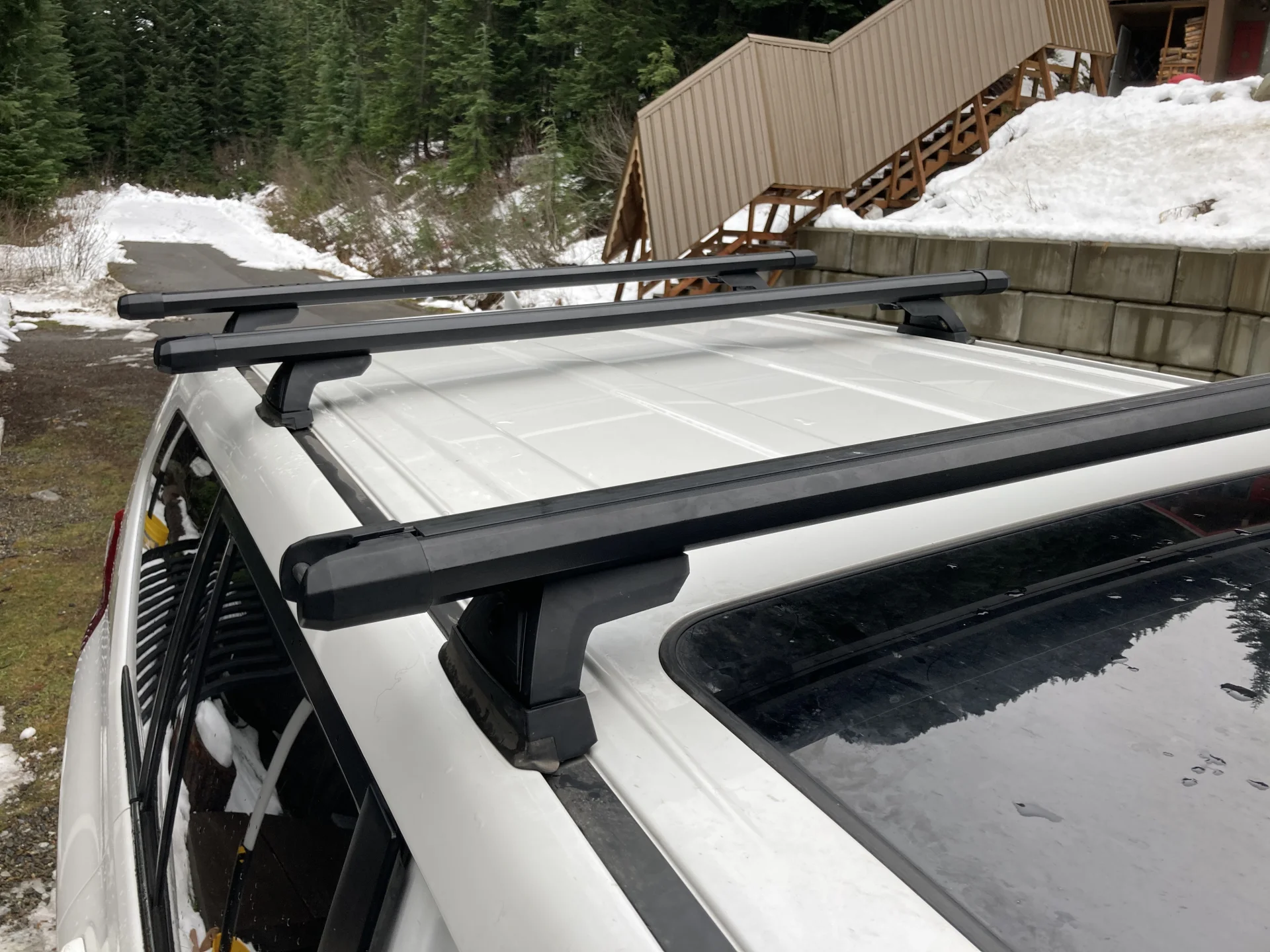

I used the Rhino Rack Vortex crossbars for my RTT install.
I removed the front runner rack I had installed, my RTT was originally mounted to the FR roof rack. By swapping the FR for the RR cross bars, I think this saved about 60 to 80lbs up top. The downside is that there's no easy way to install an awning on the cross bars if I wanted one. I think with a large RTT that takes up most/all of the roof space, like the James Baroud, there's no reason for a roof rack unless you want to add additional accessories like an awning.
EDIT: Added pictures of the crossbars installed on my 460 and clarified my post above.

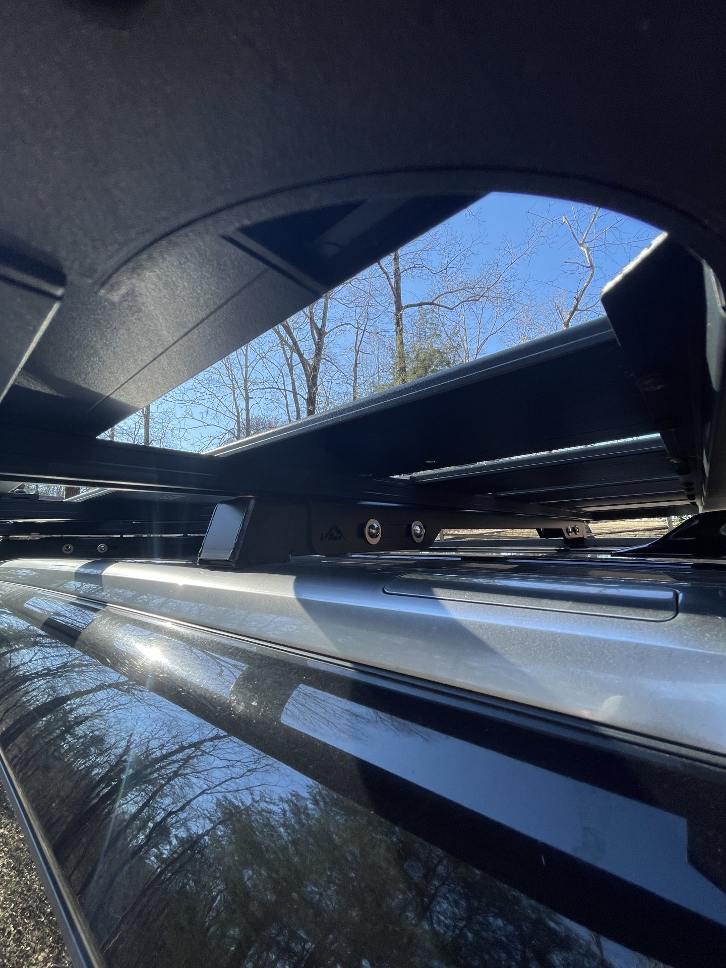

Agreed! Though the LFD Crossbars are great for mounting anything you want to your roof, such as platforms when you don't have a RTT on!View attachment 2968339View attachment 2968344
Thanks for posting the pics and affirmation for LFD. It appears you have the LFD load bars mounted to factory flush GX roof rails? Also how is the wind noise on highway with the bars? Lastly, I assume the load bars can be moved forward/ backwards within rails and removed without too much trouble, but your thoughts?! Please and thank you!!
Yes, I have them mounted to the flush GX rails! They can be slid anywhere on the roof with ease! LFD actually just revised the bars using 80/20 extrusion for what it's worth, so if you look for these, I'd look for the V1 bars. I also bought and installed the wind fairing that LFD manufactured for the bars. You can hear them, but it's not bad at all.
