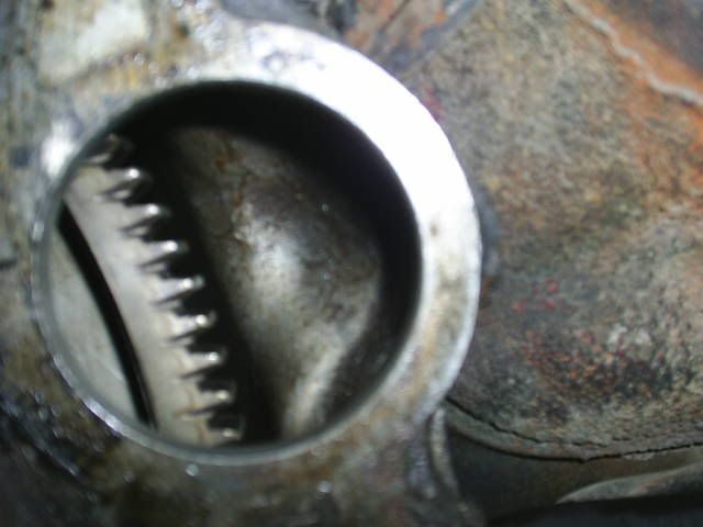

Here's a picture of the flywheel on the 93 LC. I'll try to get a video with the noise up on youtube in the next couple of days...

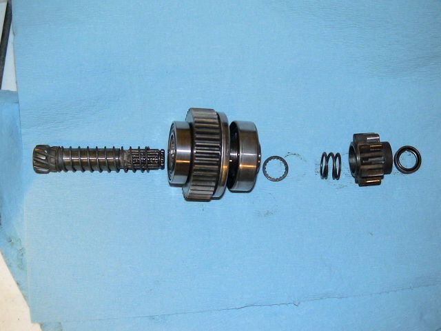

If this was just one starter with a history of grinding you might think it had something to do with the starter drive assembly i.e.: from a broken, weak, or even incorrect internal spring. That could leave the pinion gear sticking out after the engine started causing the teeth of the flexplate to grind against the teeth of the pinion gear until the pinion gear was bumped back out of the way?? With two starters doing the same thing, IDK. FWIW here's a couple of photos showing a partially disassembled drive assembly out of a 2.0kW Denso starter (28100-66060). The pinion gear is attached to the splined end of the shaft, held in place by a small C-ring.
You need to rotate the engine 360 deg to check the entire flywheel condition - not just the few teeth that you have in the picture. You need to do this.
