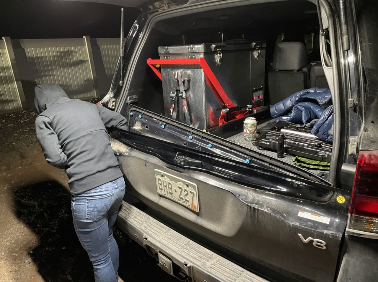

Ok folks, we’re back from wheeling in Moab, and I wanted to follow up on this. I don’t know exactly what caused it, but the latch was essentially in between states. It wouldn’t close all the way, nor would it open. Ultimately, we removed the trim panel on the tailgate which involves gently popping a few plastic trim pieces (I used a bottle opener because that’s what I had), and then removing the two bolts on each side to release the trim. Getting this panel out was difficult because we have drawers, so the room to work was extremely limited as you can see in the photo.
Once we got the panel out, my wife was able to get her hand into the driver side of the tailgate, and manually release the latch. Once she located it, it was easy for me to find the latch as well. With the tailgate open, I cleaned up the latch mechanism and put the panel back on. Good to go now, and going forward I’ll regularly clean the latch areas!
