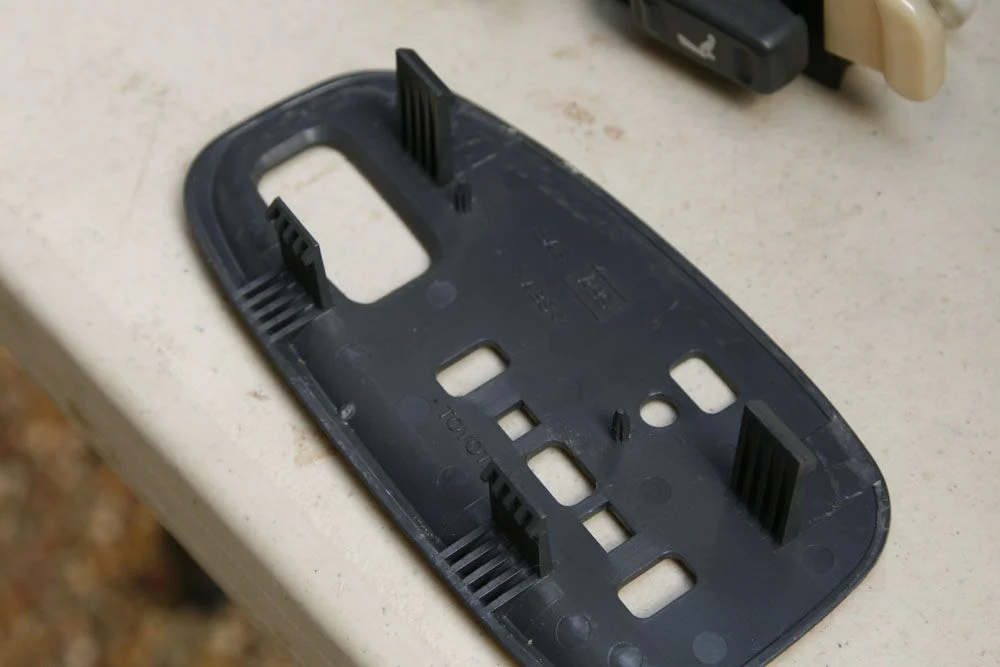

I'm trying to pry off that same plastic panel. I can see it's held on by 2 clips, but even using trim tools, it's really difficult. I can't seem to get them to 'pop'. Argh. Any helpful hints from you guys?
Thanks,
Muddy1
Push two of the prongs at the same time to release one side and then do the same to the other side. This pict may help.
