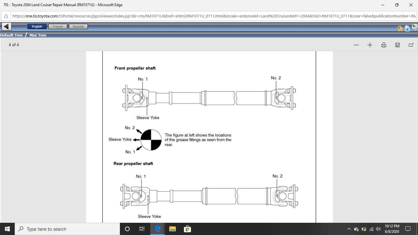

did you put your greases joints into the correct orientation? did you use all of the same color snap rings when replacing, same color snap ring same thinkness

Wheel bearings, needle bearings, and make sure they are at correct preload.

Good deal. Also when you had your ujoints replaced- they should have balanced the driveshaft and its customary to paint arrows or match marks on the driveshaft to yoke connection >-< so if you separate the two parts, you know where to line them up when you reassemble. Did that happen?
