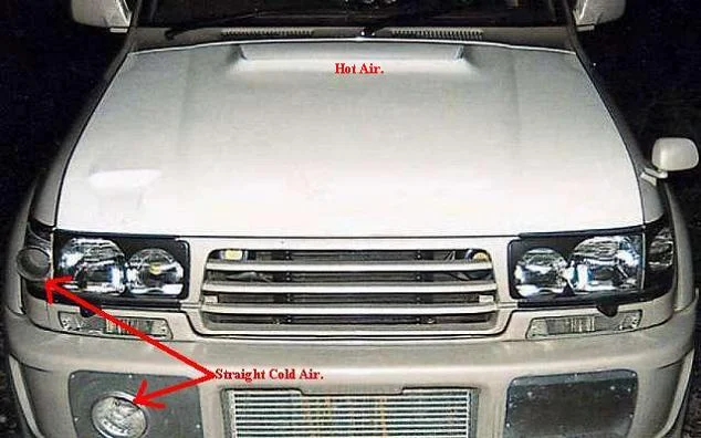

LX_TREME said:
I just realized that's a Cruiser! The hot air vent is a cool idea. As long as you could keep water out or diverted somehow. I'd like to see the underside of that hood.
