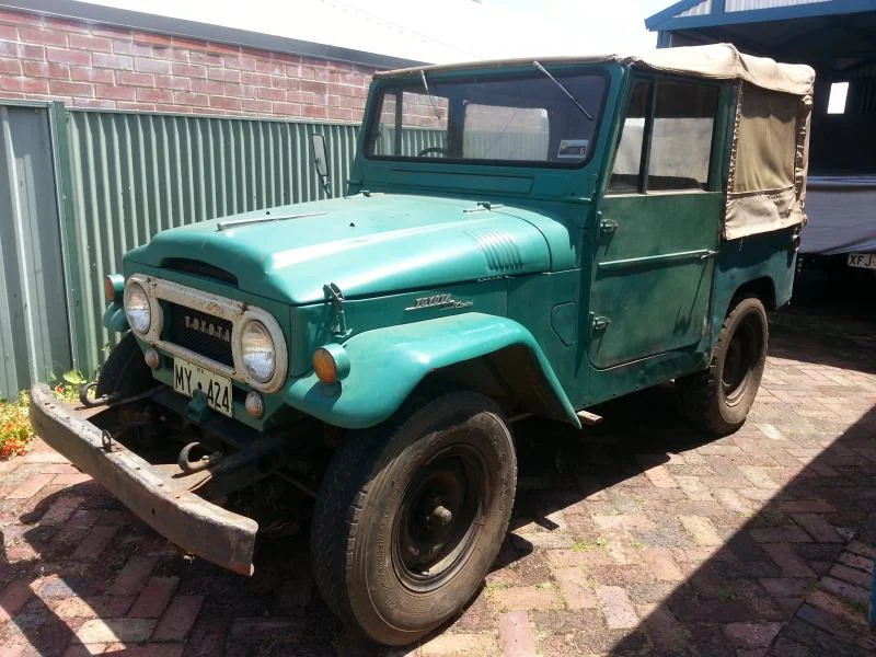

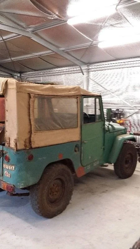

Oh so excited about buying this.
............and the (long) resto journey begins!!
Any advice from those that have travelled this path, with similar vehicles would be appreciated.

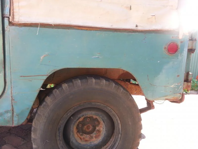

Brief details:
It's all original, matching numbers, and original bows and canvas!
I will be the 3rd owner. PO, purchased from the Widow of the first owner, bought it to restore but didn't have the time/money, it sat in a shed for years.

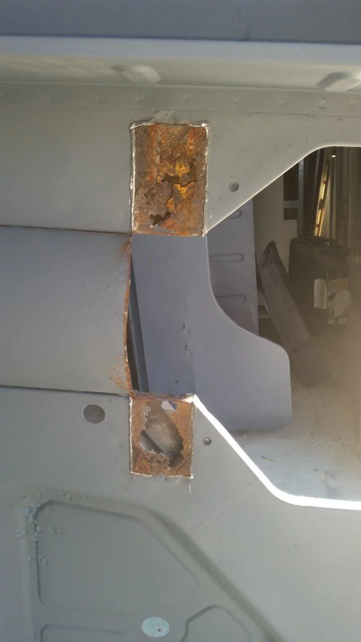

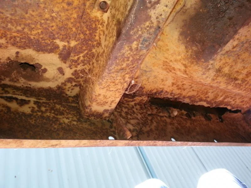

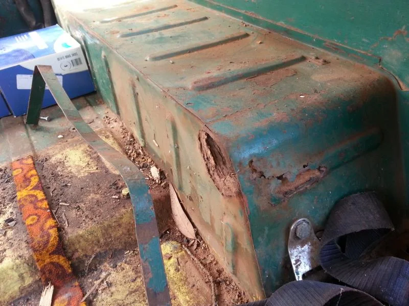

Rear 1/4 panels, sill panels, inside wheel arch are rough but fixable. Floors are good.

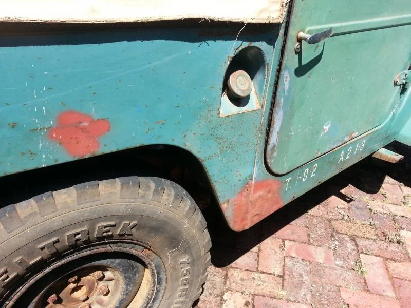

Trying to work out what the original paint color was? I think perhaps Horizon Blue?
Original owner painted over the top of the original colour Judson Green.

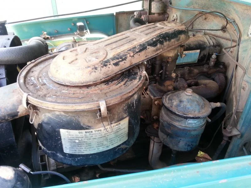

Tail lights are original .... Specific to early AU cruisers ... Quite rare ... There is a thread in the 25 section about them
You got the oem hand crank bumper mount on there as well ... Cool

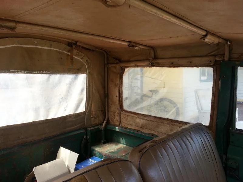

The oem top had the windows replaced at some time
The panels .... There are a few guys in USA who make um... Don't know of AU ... There must be somebody down there
You should check out the 25 section some time... Lots of early cruiser information you'll like
Johnny seems to have youretty well covered. I am curious of the model year? SOR.com has chart that should give you the production month by the VIN. Guessing late 64. Long running boards and emblems on the rear were 65 changes I believe. Dobster would be a good source for help. Those tail light looks very close to the ones used on the long wheel base pickup. If they aren't the same they may at leasted be used in place of them. The pickup lights aren't easy to find be would be much easier then the ones used on the Australian early 40s.

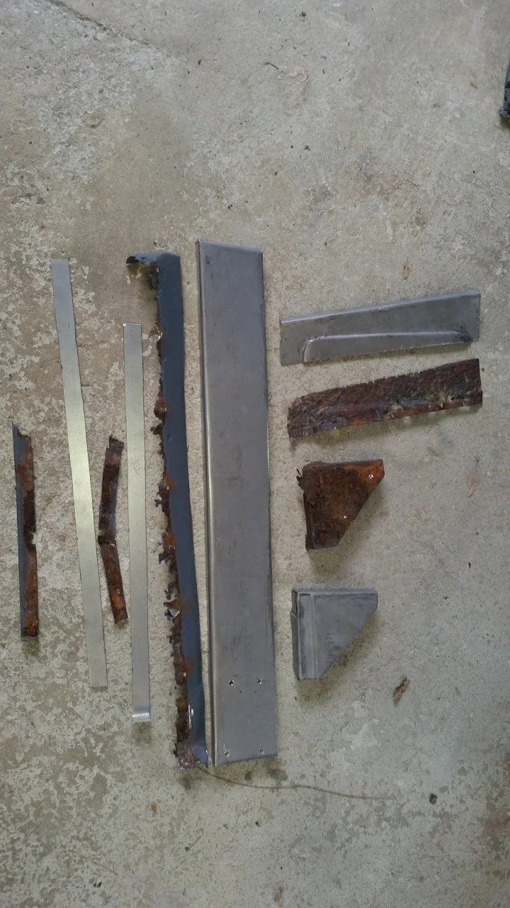

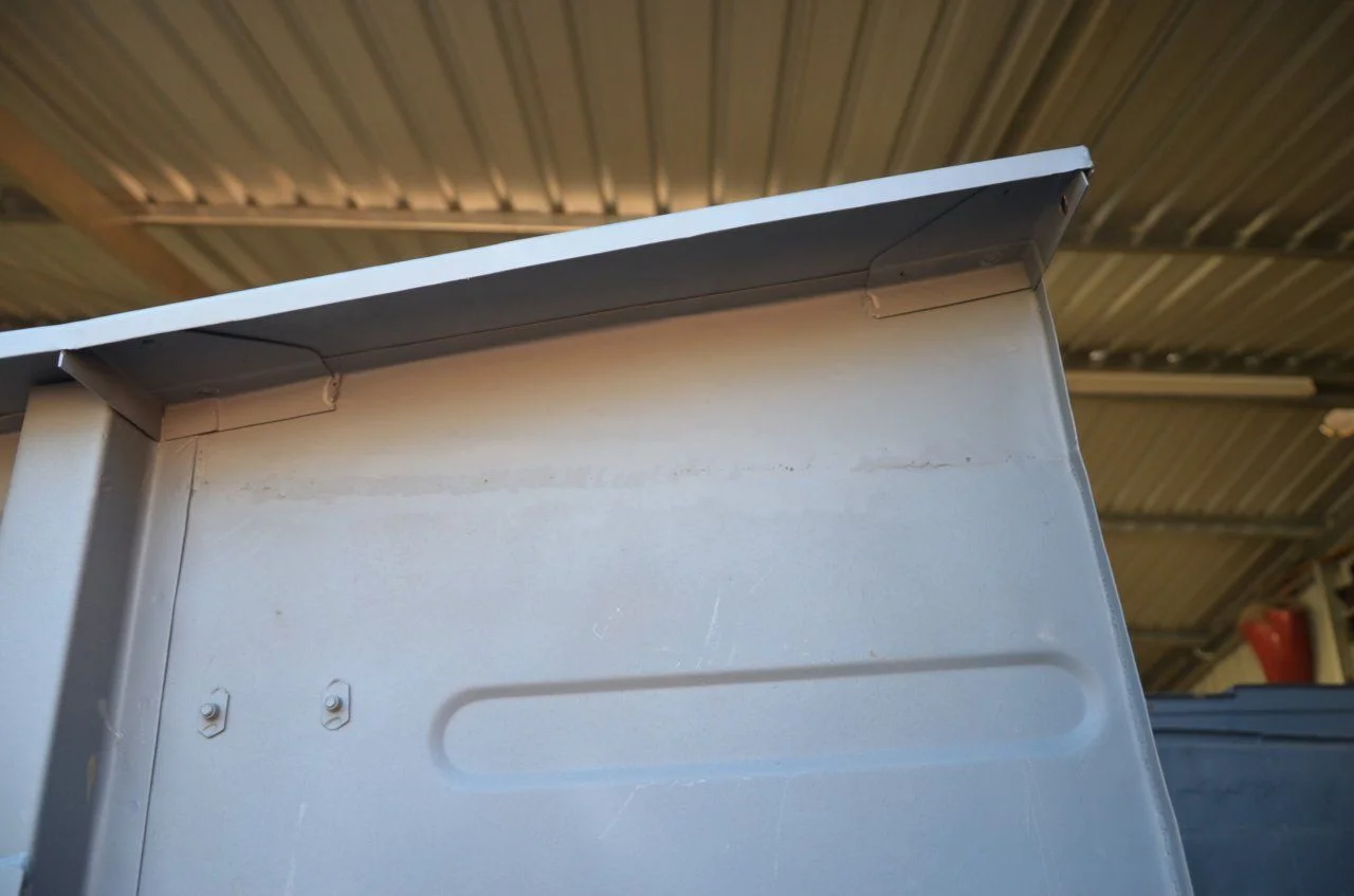

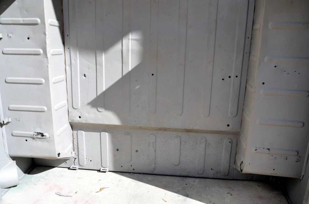

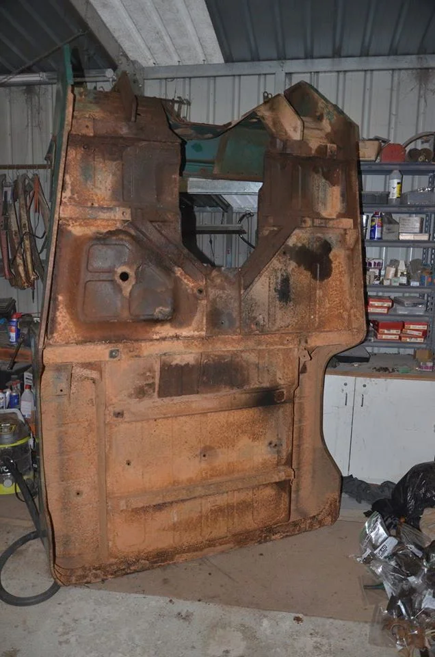

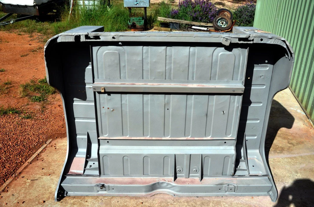

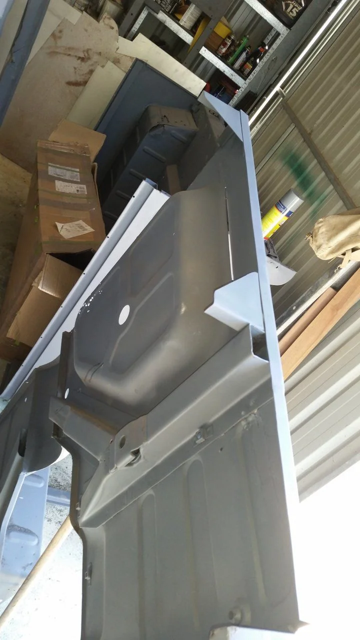

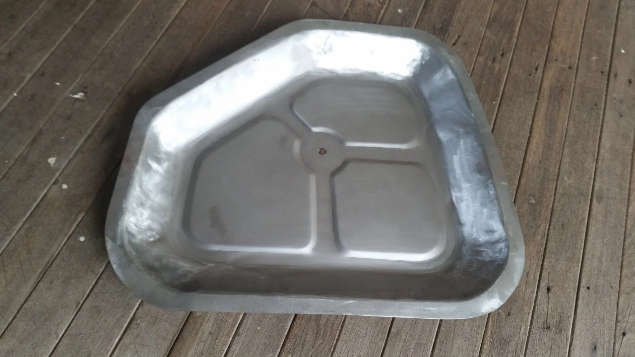

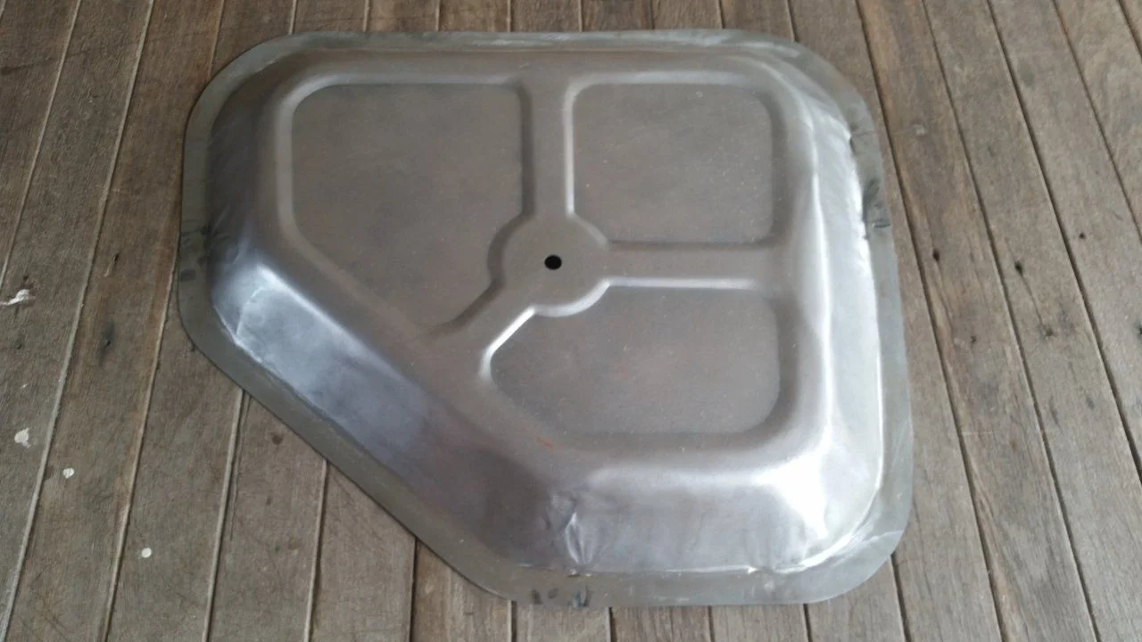

Purchased a few replacement Floor panels from Real Steel.
Not too bad.
The sub Fuel Tank panel requires a bit of work to get close to original before 'stitching in' but good value in my opinion.
The original Rear 'Main Floor' panel and the 'Mid Floor' Panel in the 40 are very pitted and rippled ( see above photos). Thought it would be easier, given the Rib pattern in the Floor to purchase these Panels to get a cleaner look in the back.
