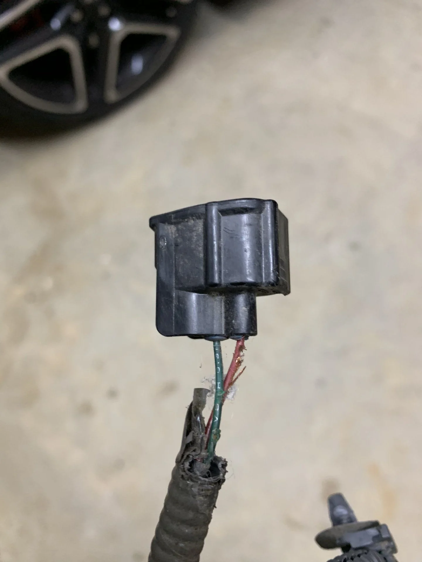

I picked up a Veloster N to play around with & my 200 has been sitting more than usual. After about a 2 week sit I drove it & got a CEL, check VSC, & 4lo flashing. I pulled the code & got P033D. A quick google took me here: 2008 Tundra 5.7L Code P033D Knock Sensor 4 Ckt High Bank 2, Traction & VSC Lights on
Sure enough I popped the hood & insulation from the engine cover was shredded. I ordered the wiring harness for the knock sensors from EBay (82219-0C020) & pulled the intake manifold. Sure enough there was a nest on the drivers side rear & a chewed wire. Took about 2 hours to change the harness, Tundra guys said dealer charges $1300 or so & their comprehensive covered it. To hopefully prevent it from happening again I sprinkled a little used cat litter where the nest was & where I park it. Wife is cleaning the garage to park it inside too.
TLDR: If you leave your cruiser parked too long rats like to nest under the intake manifold.

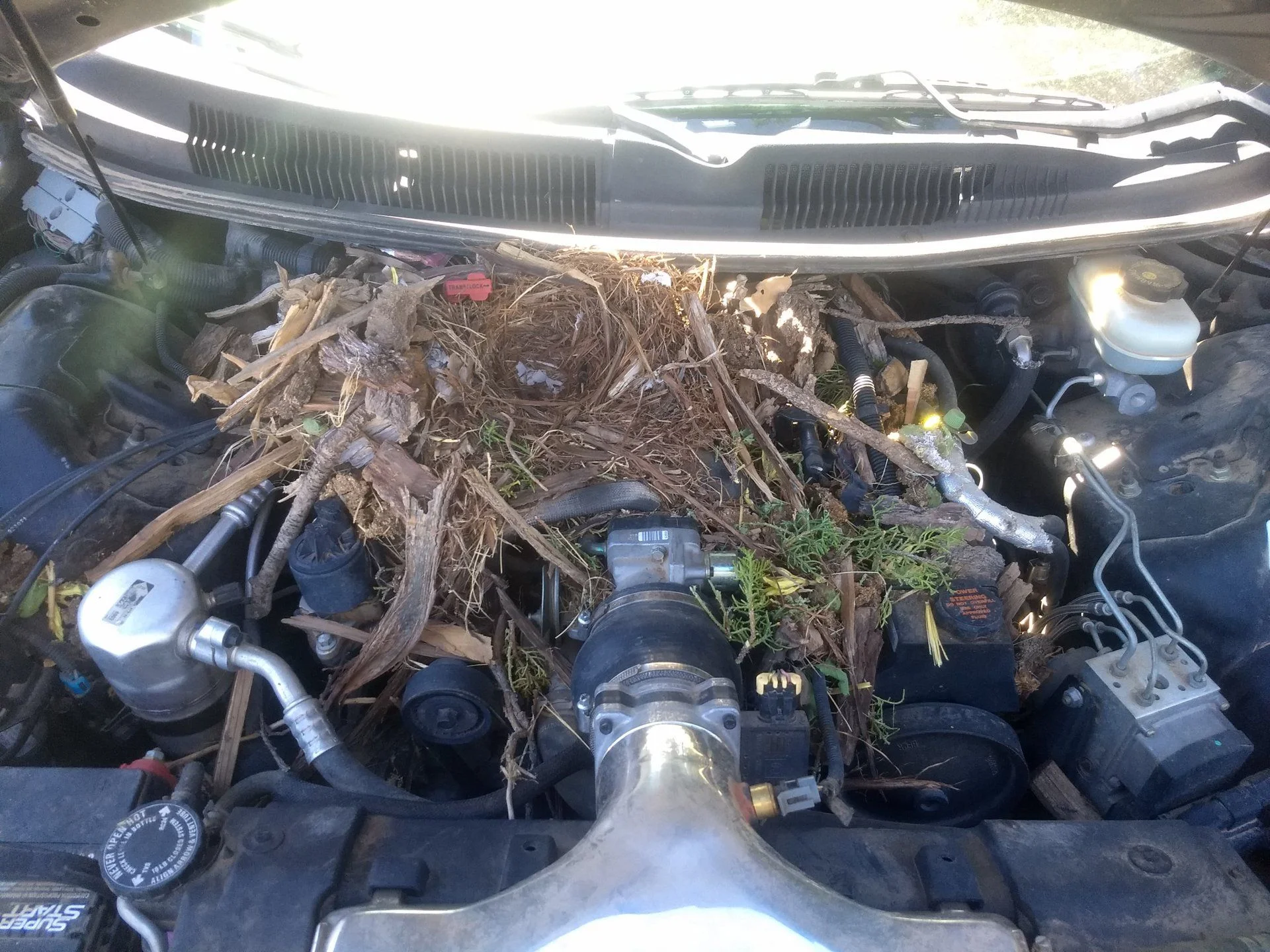

Here is under the hood of my Trans Am this summer. Our big tom cat dissappeared and this is what happened. Got more cats now.
