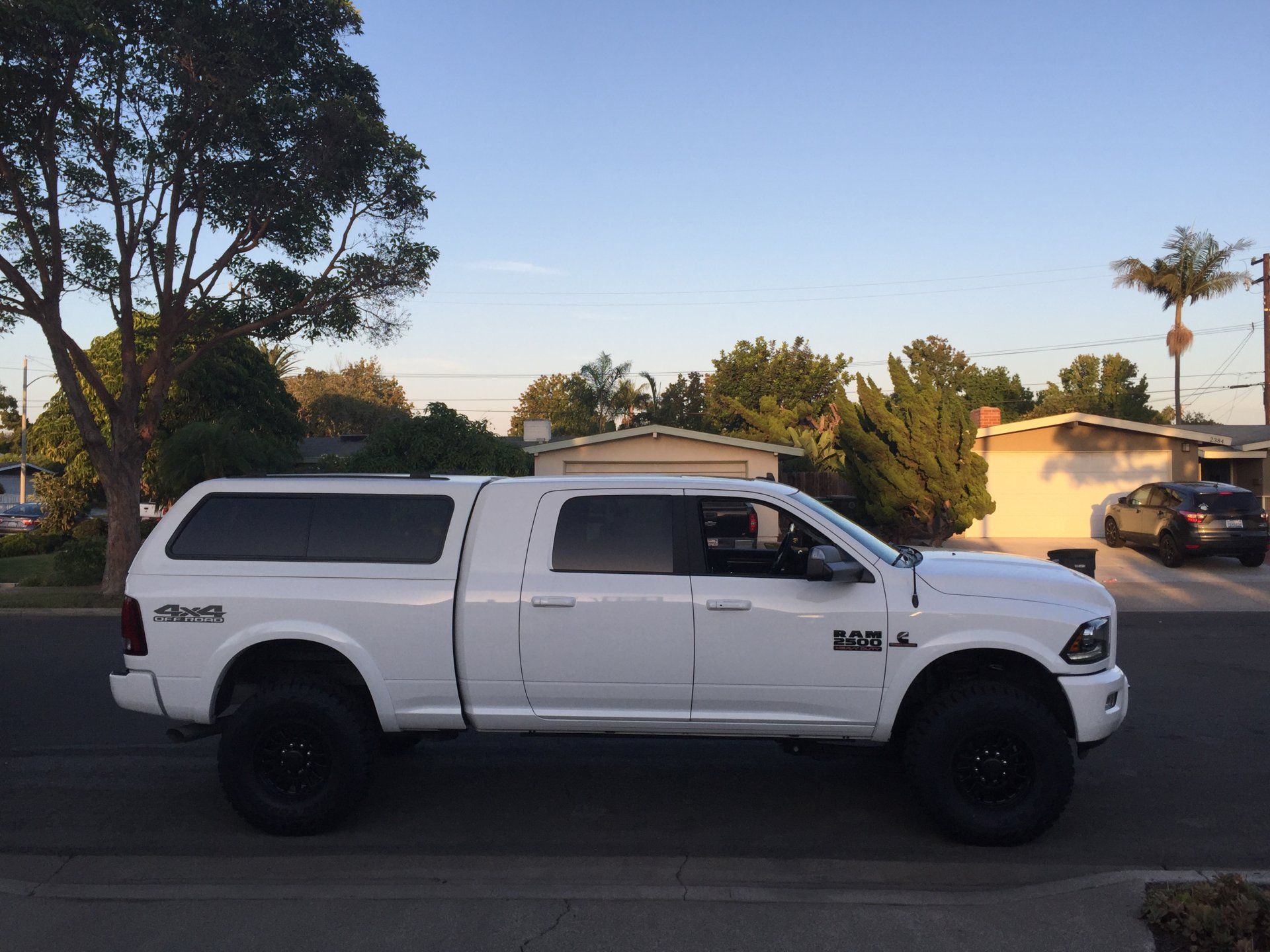

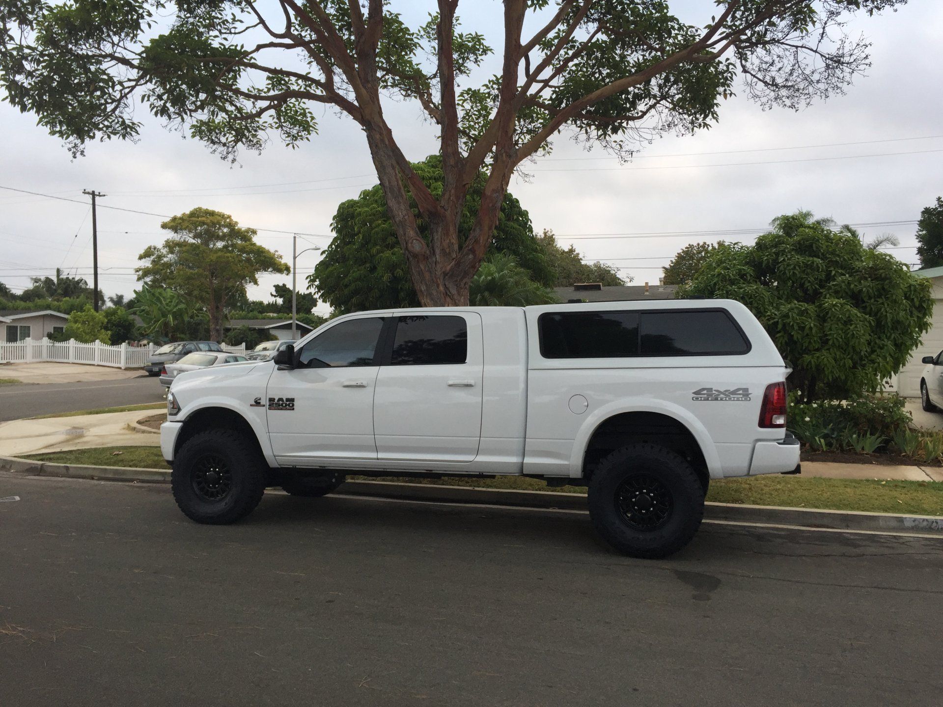

Here’s the show...
And here's the tell:
2018 Ram 2500 MegaCab 4x4
6.7 Cummins Diesel
AEV 3" Dualsport Suspension Lift
AEV 17" Salta HD Wheels
37" Toyo RTs
ARB Twin Compressor On-Board Air (CKMTA12/24)
Snugtop XV shell (Sportsman Package, Yakima rack, pet screens, fishing rod holders, clothes hanger, 12V light, flip down window with slider, keyless entry, and USB chargers)
