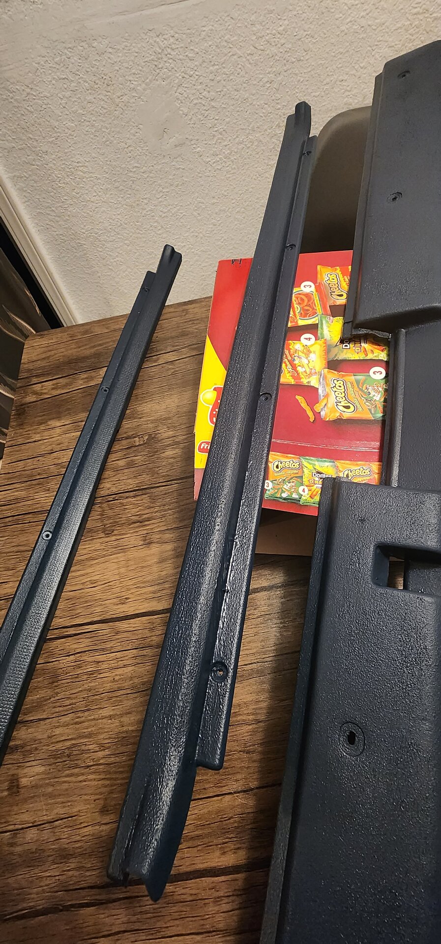

Just thought I'd share. My rear top trim on my tailgate and my lower plate were in need of some refurbishing also my side plates but I thought that if just used sem on these parts since it's a higher traffic area they would peel or flake.

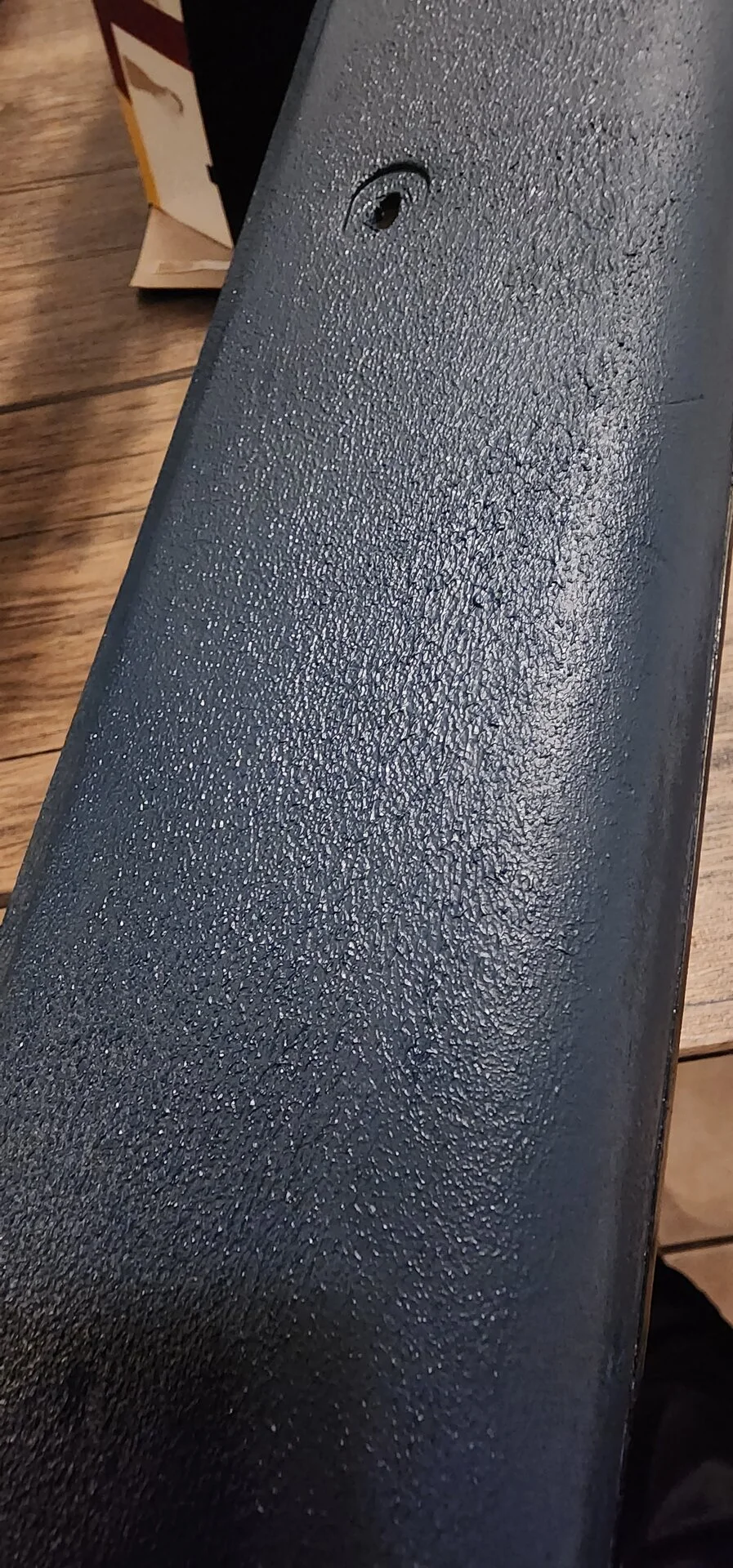

I decided to mix some shadow blue sem with raptor liner tintable and it came out pretty good.
I sprayed some sem directly into the liner mixed it and yes it did come out lighter then I wanted after mixed. Then I rolled it on the panels and bit it with a coat of sem . I figured since the raptor was still wet the sem would fuse with it. Anyways this are the results

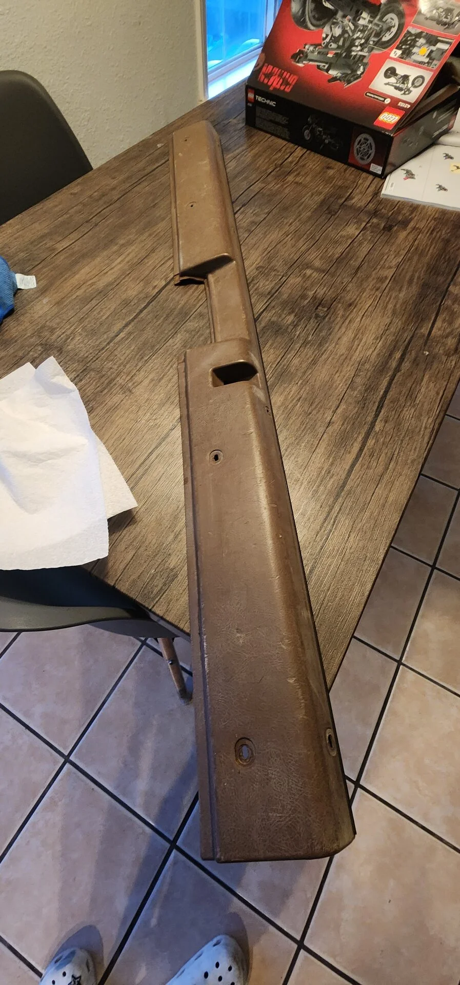

* the trim was brown because I had pulled it from a junked 86 last week.*
