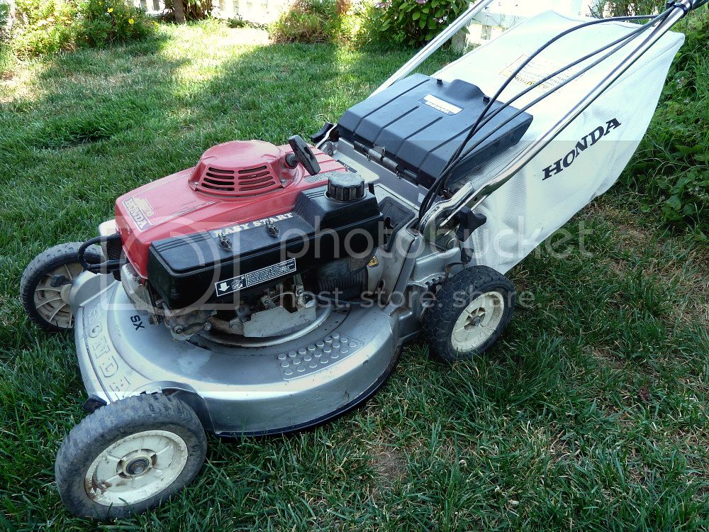

LOL I bought Teri a new Honda mower, it was so gutless she took it back and demanded a John Deere, wouldn't leave without
the take back and deal. That JD still runs like monster.

Not really much help Keith..... The picture was a nich touch though.
