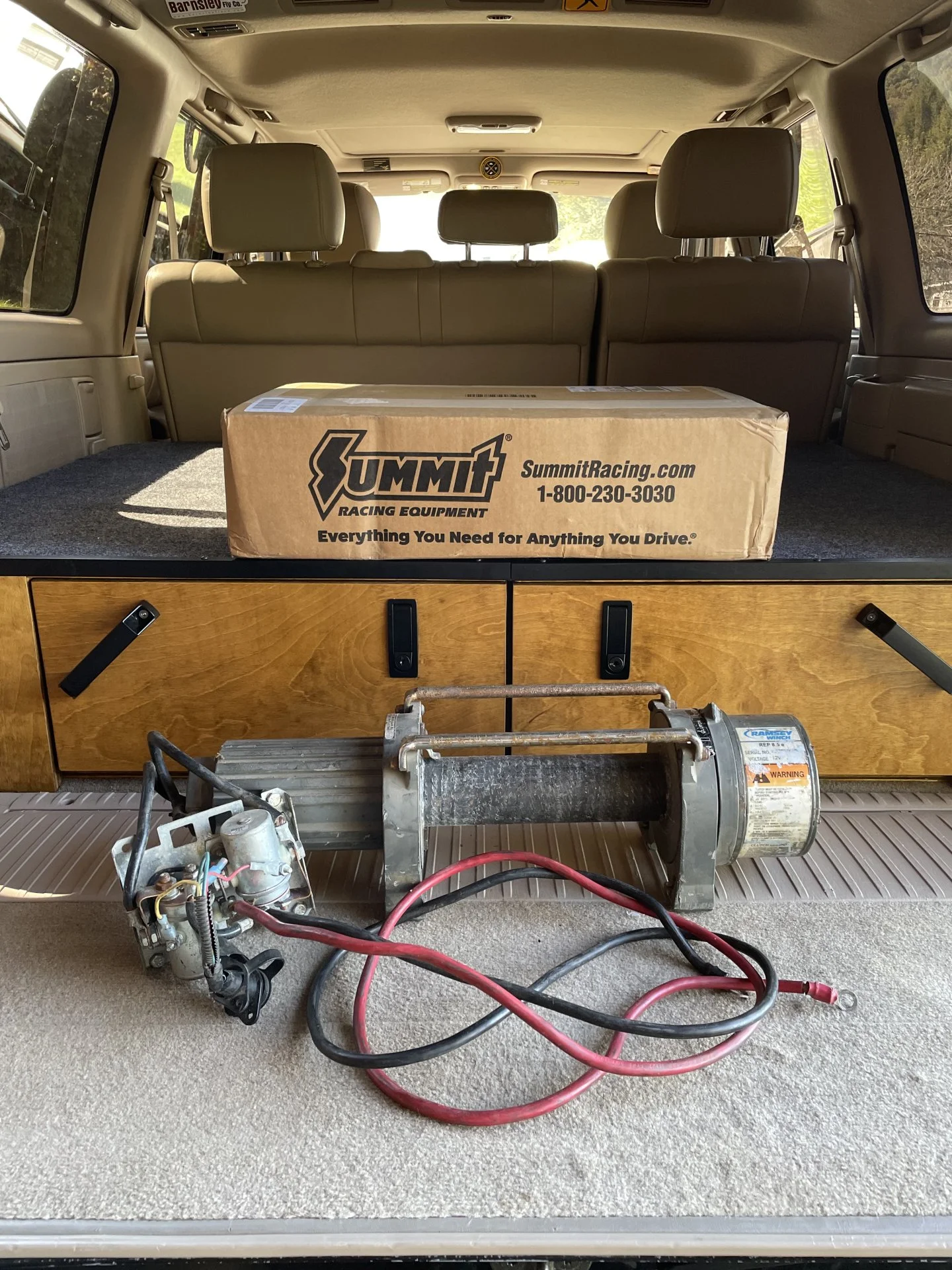

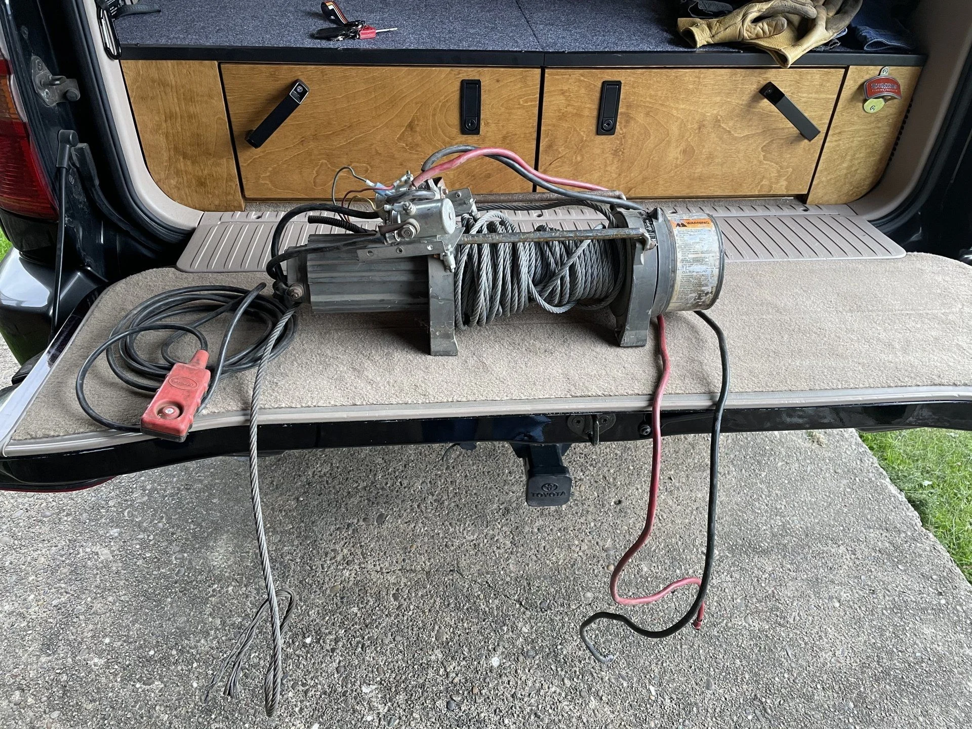

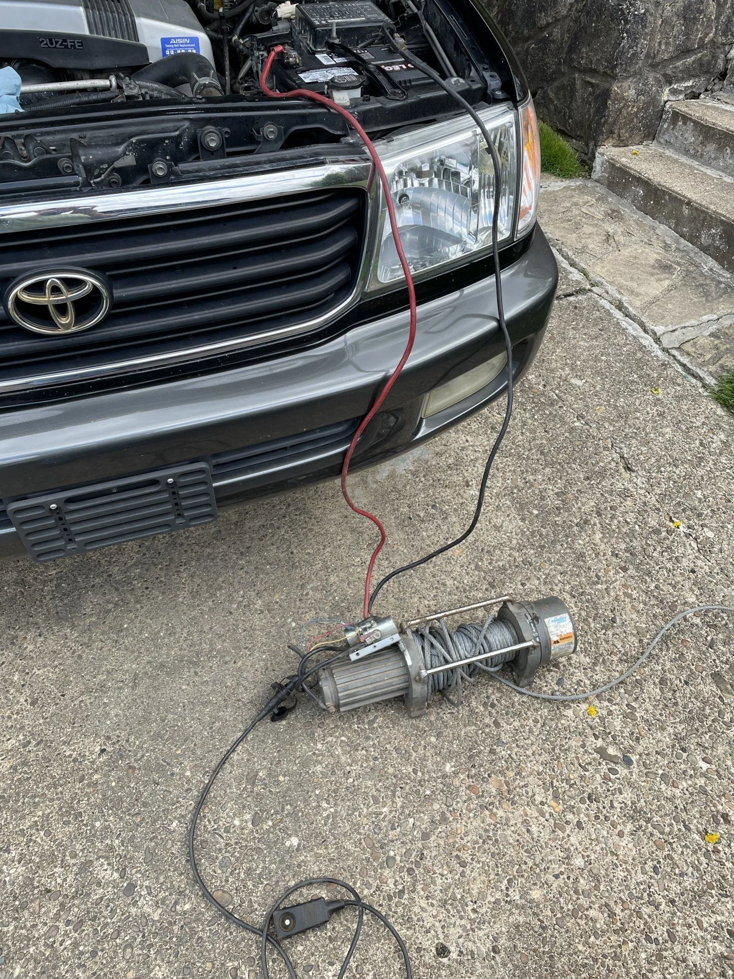

Finally got a chance to pick up the winch yesterday. Hooked it up briefly today to confirm function. As expected, it's got a bad solenoid and only runs forward. Also stripped the old cable off as it needs replaced for sure. Should be a fun project and hope to have it ready by the time my ARB arrives.

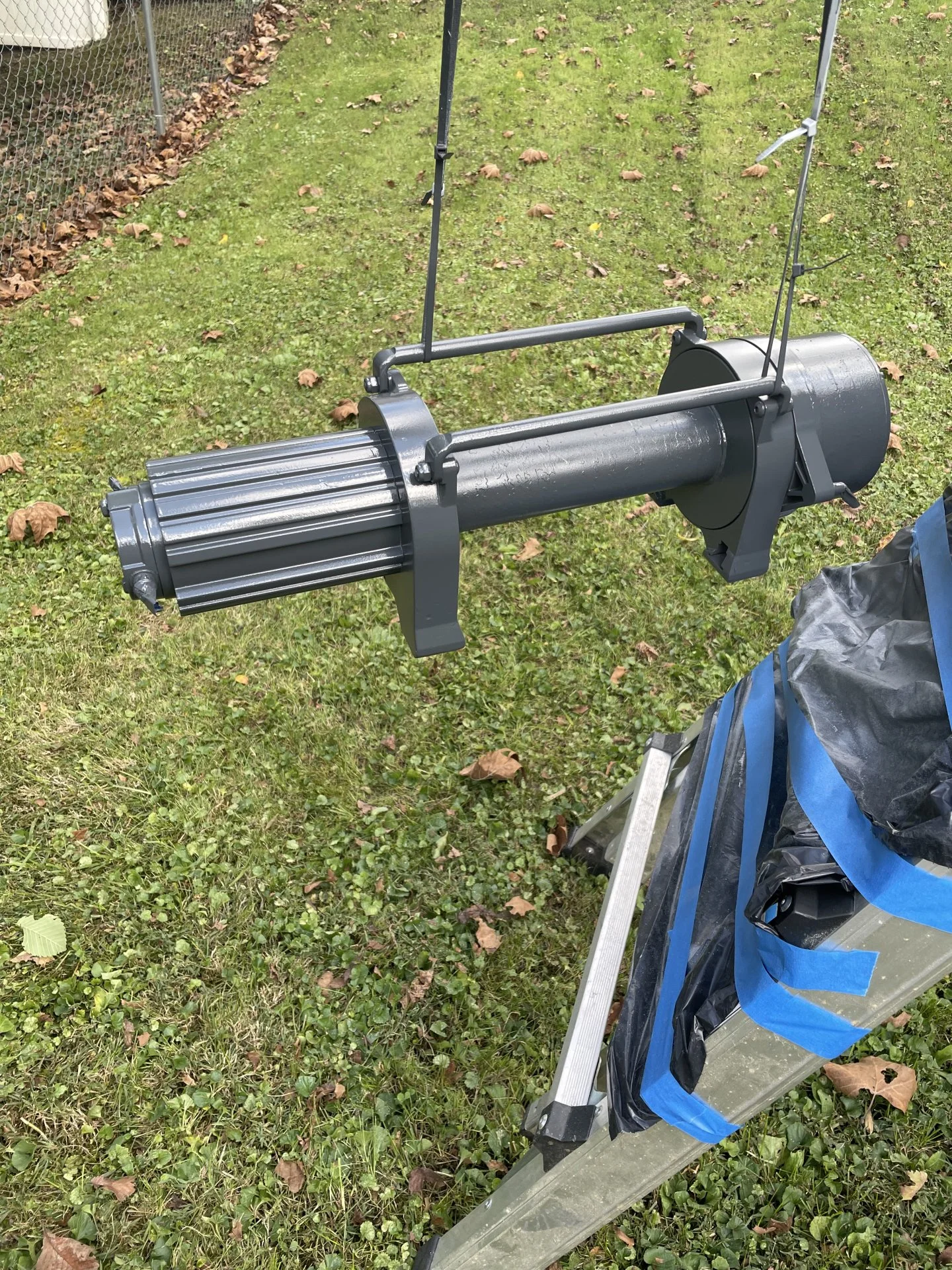

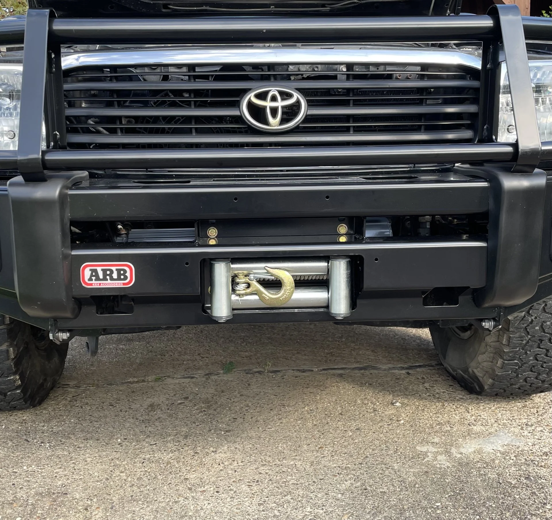

Finally wrapped up my rebuild. The Cam Ring was broke and handle missing so I replaced both of those. I used the opportunity to clock the gear box for my ARB bumper. I also cleaned it up and primed then painted with Rustoleum gloss charcoal gray.

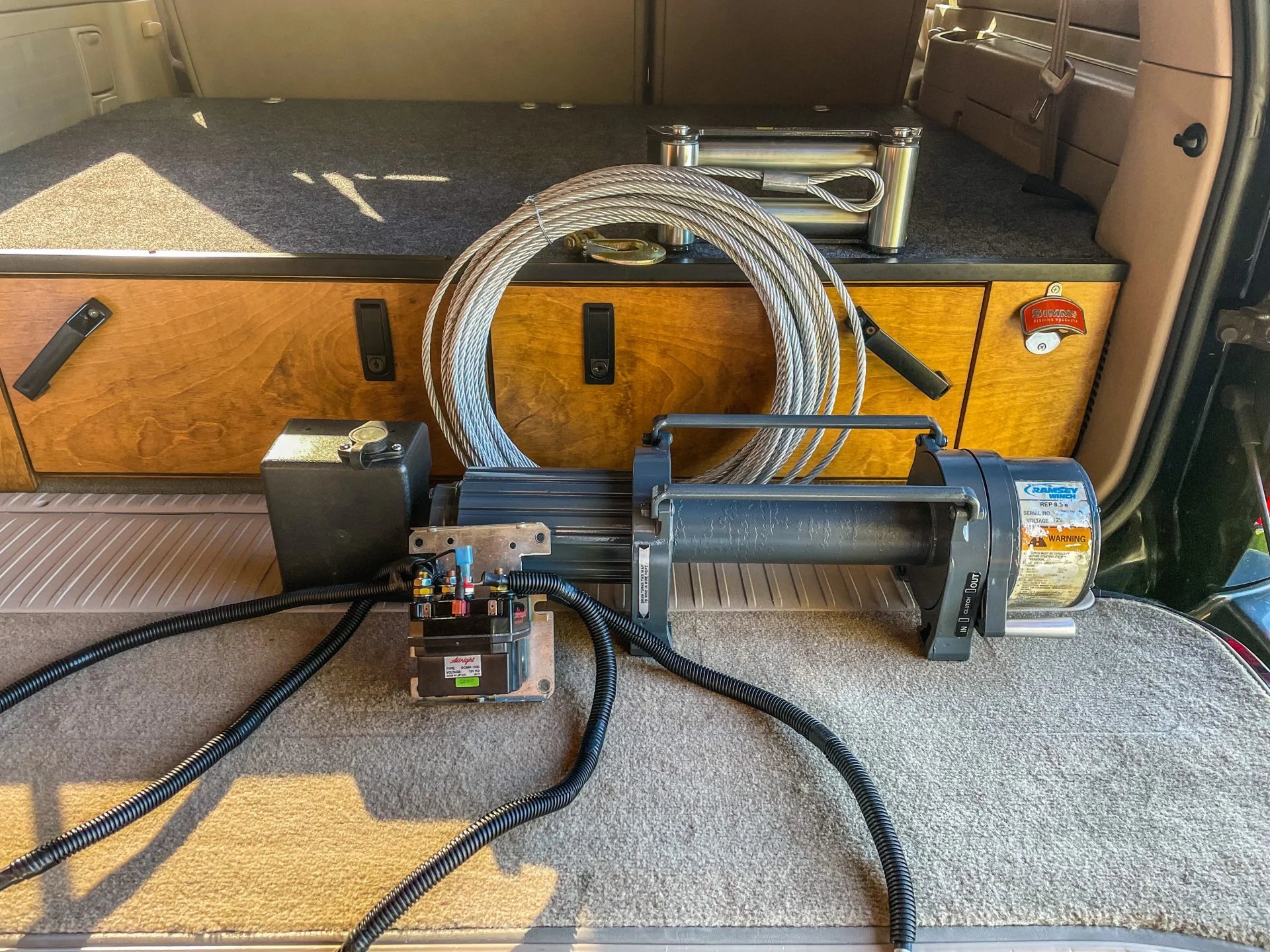

I seriously considered going with synthetic rope, but went old school steel cable this time around. I was able to pick up 100' of 5/16" with hook for $58 from Summit Racing. That's half the cost of even Harbor Freight synthetic. We'll see how it holds up and if I get a year out of it I can replace it with synthetic without much of a loss. I had to use 1 1/2" bolts for the lower two instead of the recommended 1 1/4" due to the extra thickness of the fairlead

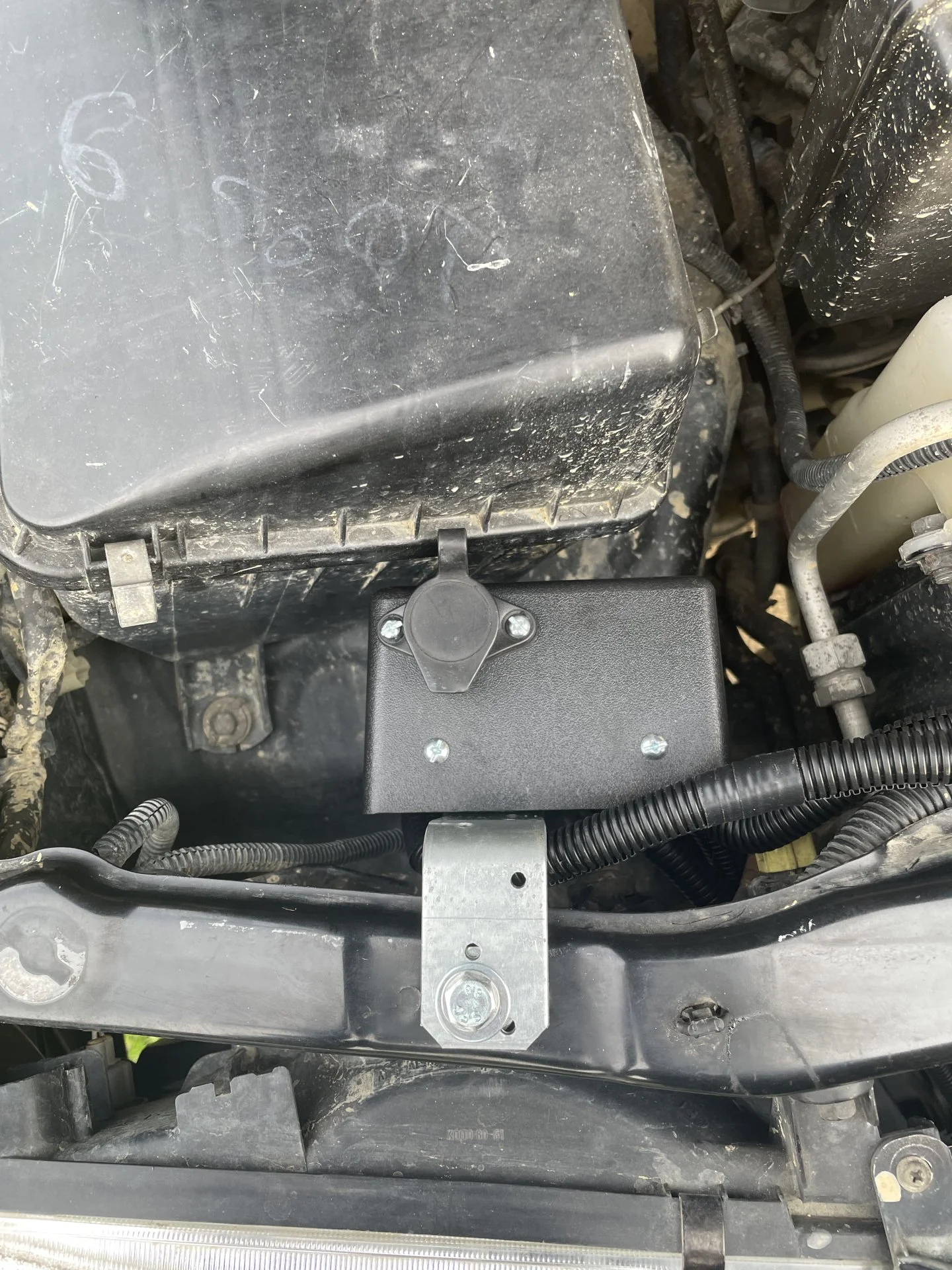

One of the solenoids was bad so I replaced both with an Albright contactor. With a little modification it all fit in the control box. The extension cables that came with my ARB were along enough to allow me to relocate control box behind the passenger side headlight.
Only step left is to tension the cable and add in a BlueSea disconnect on the positive cable.
