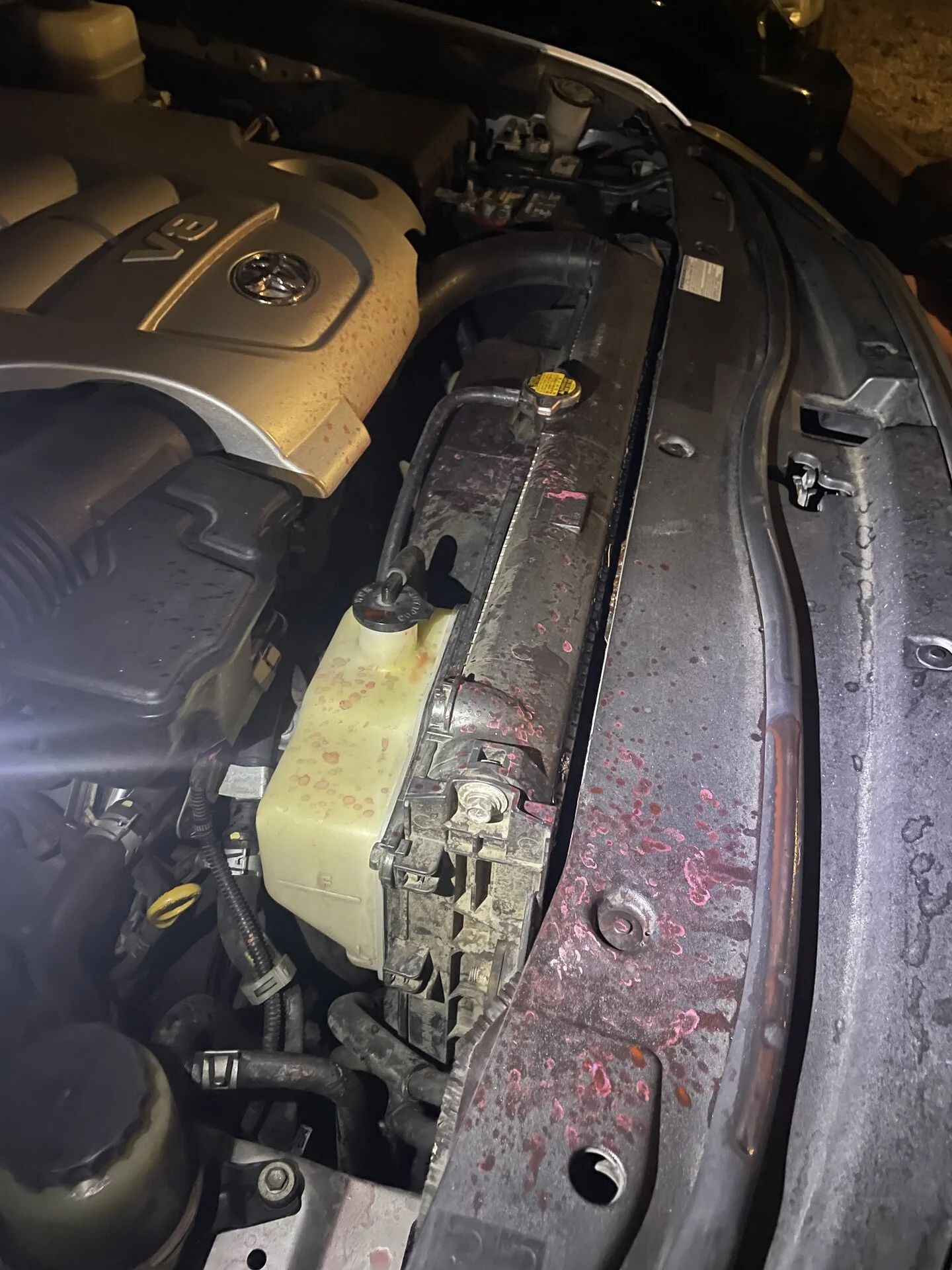

I have a 2013 Toyota Land Cruiser. Noticed that I’ve been leaking radiator fluid often on for a while. Been filling reserve tank, have had no over heating or any lights come on. Anybody out there have any issues with that? Recently I noticed splattered Radiator fluid on my bonnet and top of my radiator and elsewhere. Thoughts, recommendations, fix?
This leak seems to be in an atypical spot..
Though yes a new radiator is the fix.

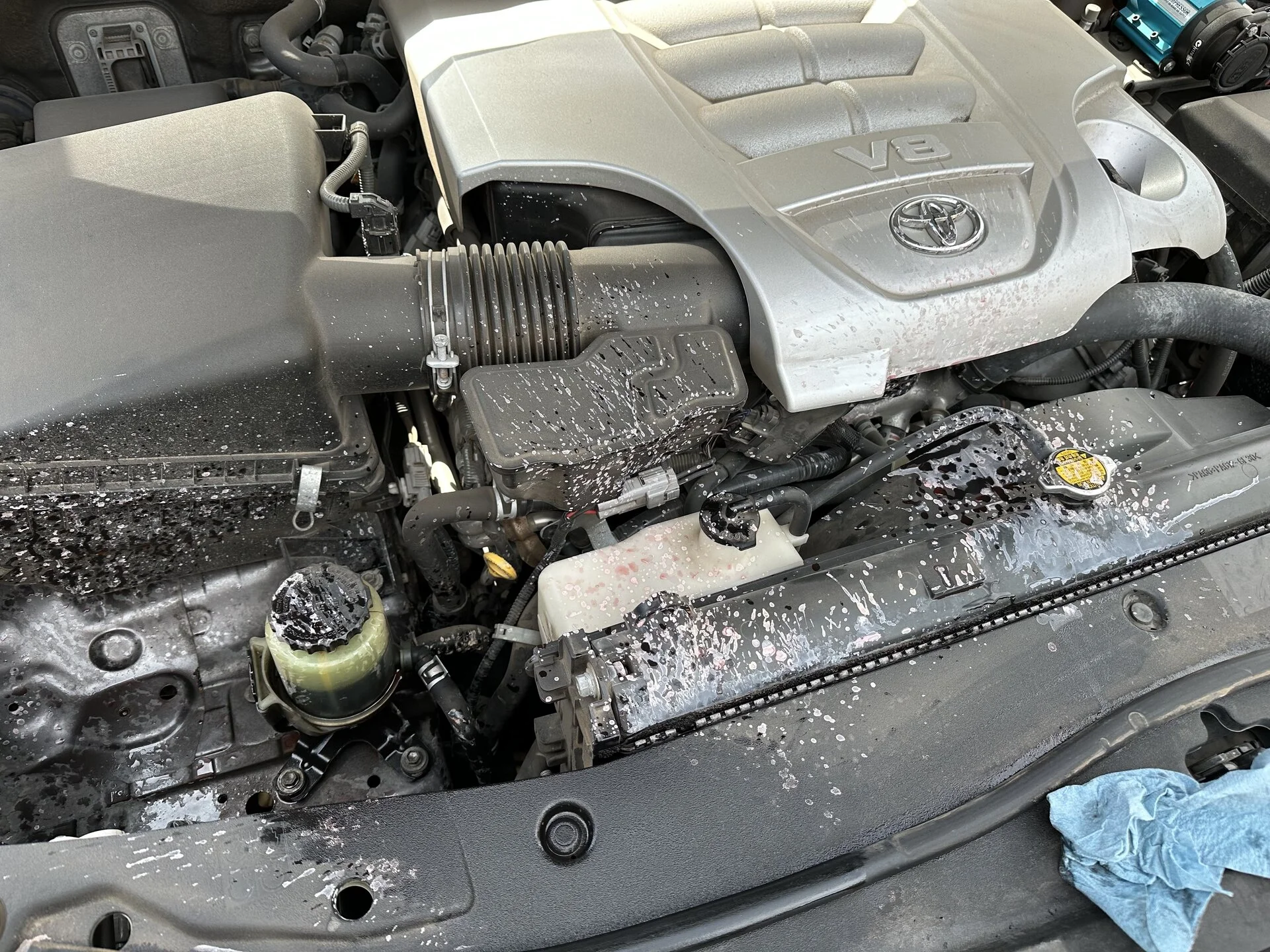

I also had some similar leak just this week. Apparently radiator crack. Replaced at local dealer.
This was right at 125K miles.
