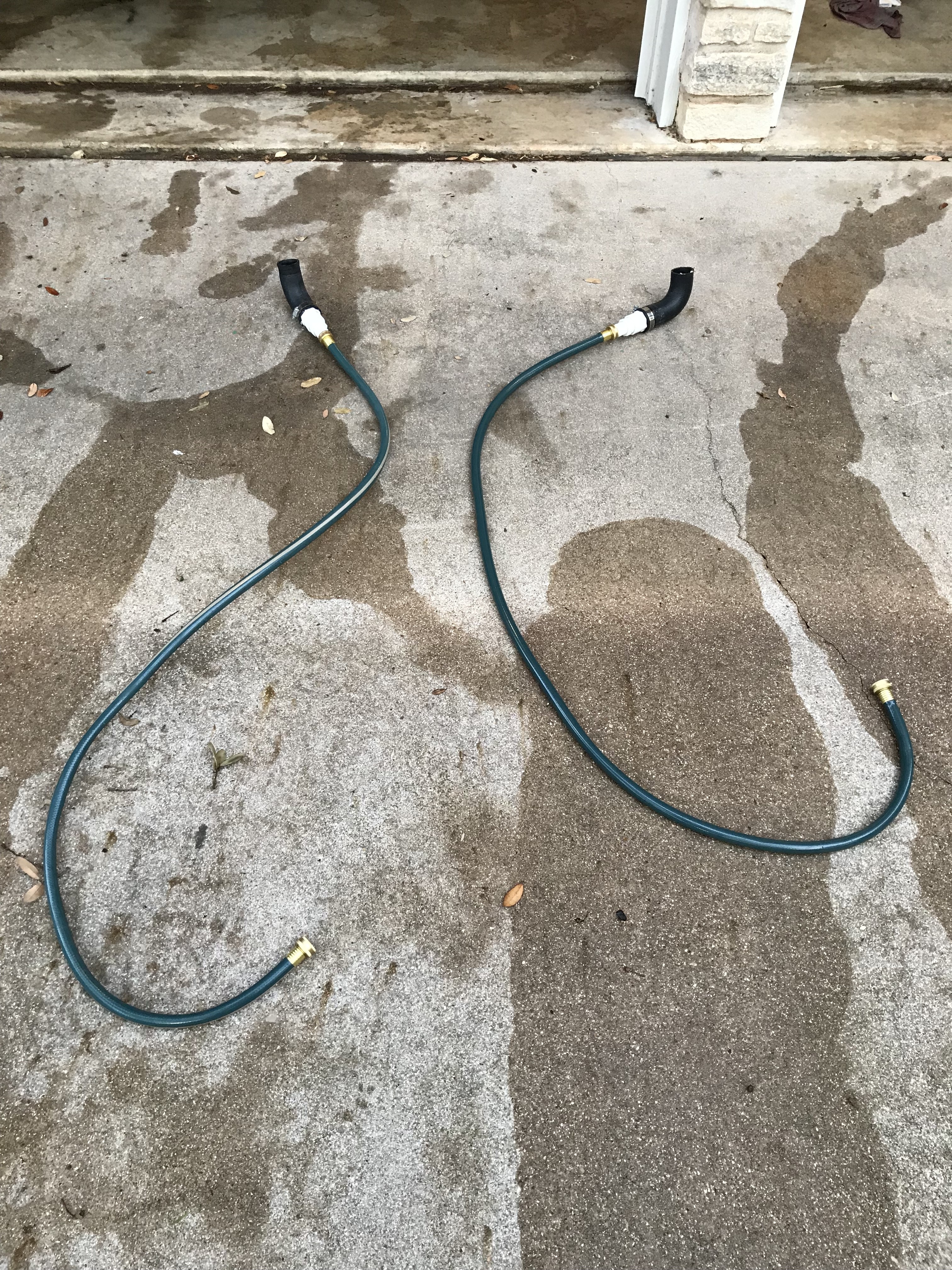

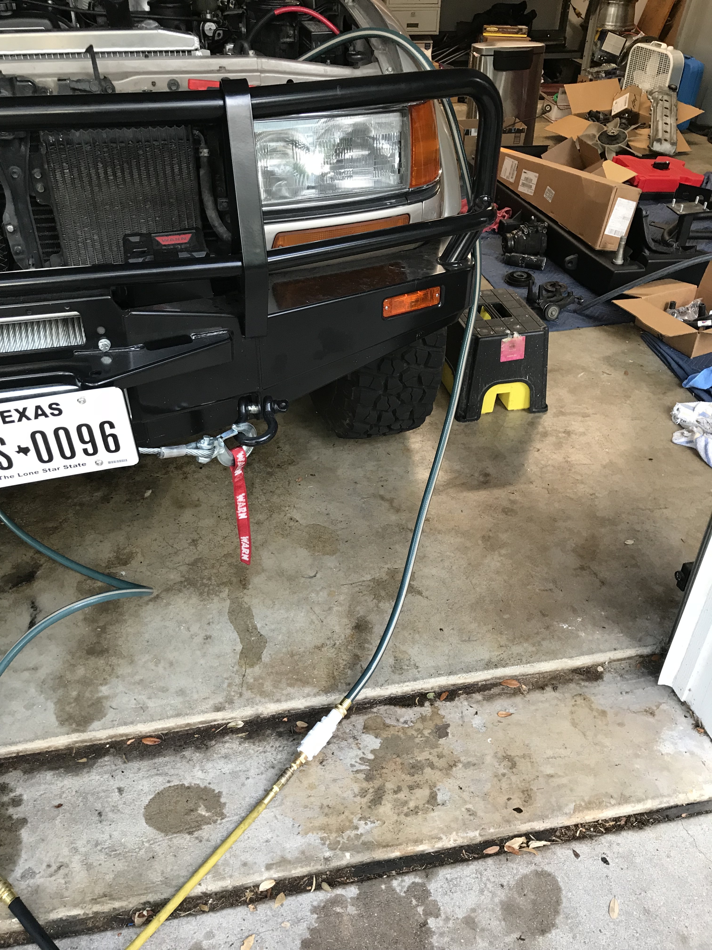

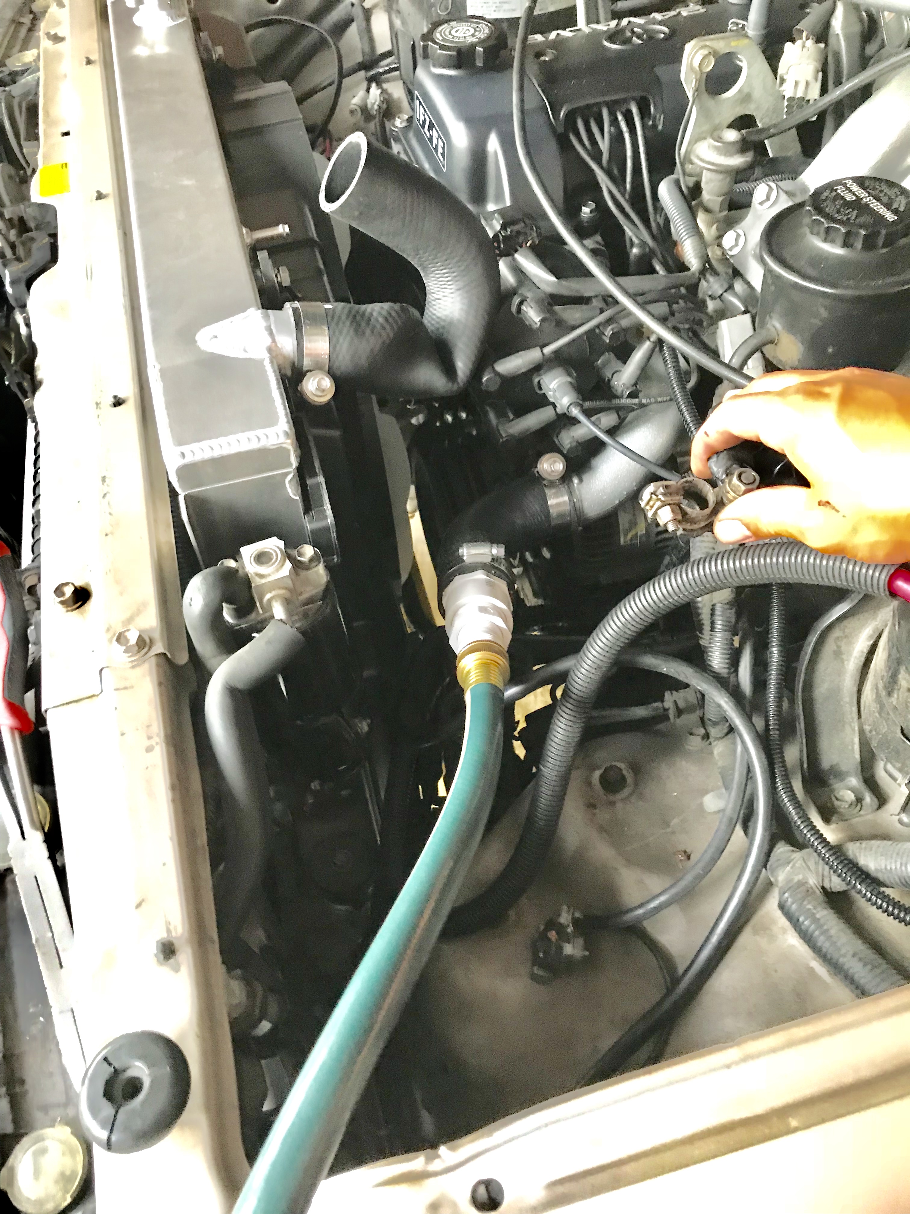

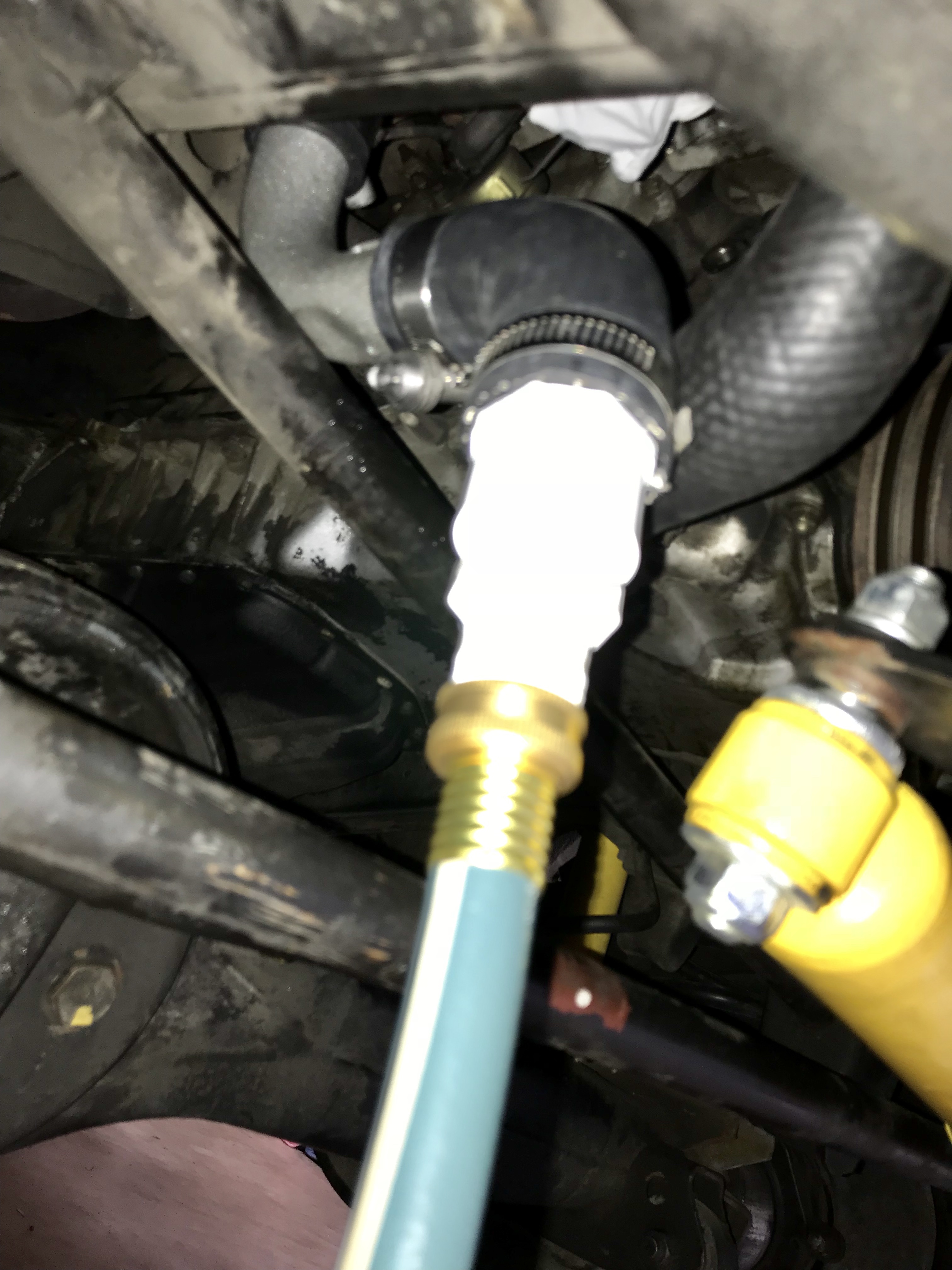

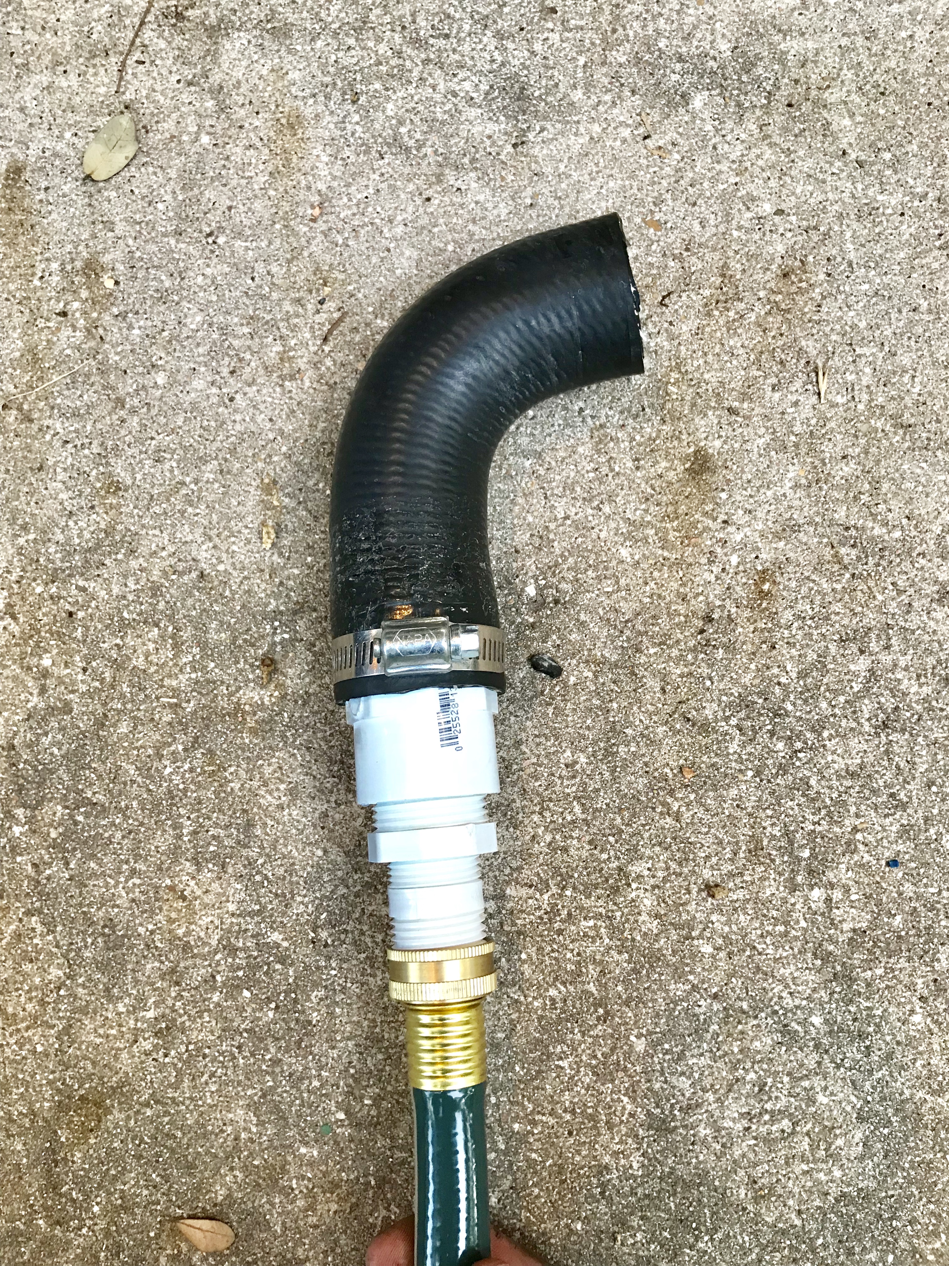

I made up some adapters to make radiator flushing easy. Just remove your radiator hoses (upper & lower) and replace them with the adapters, screw on your garden hose, and let it run. They are for loan just PM me arrange pick up.

My set up above is just for the radiator but with the radiator disconnected the rest of the system is easy to flush.

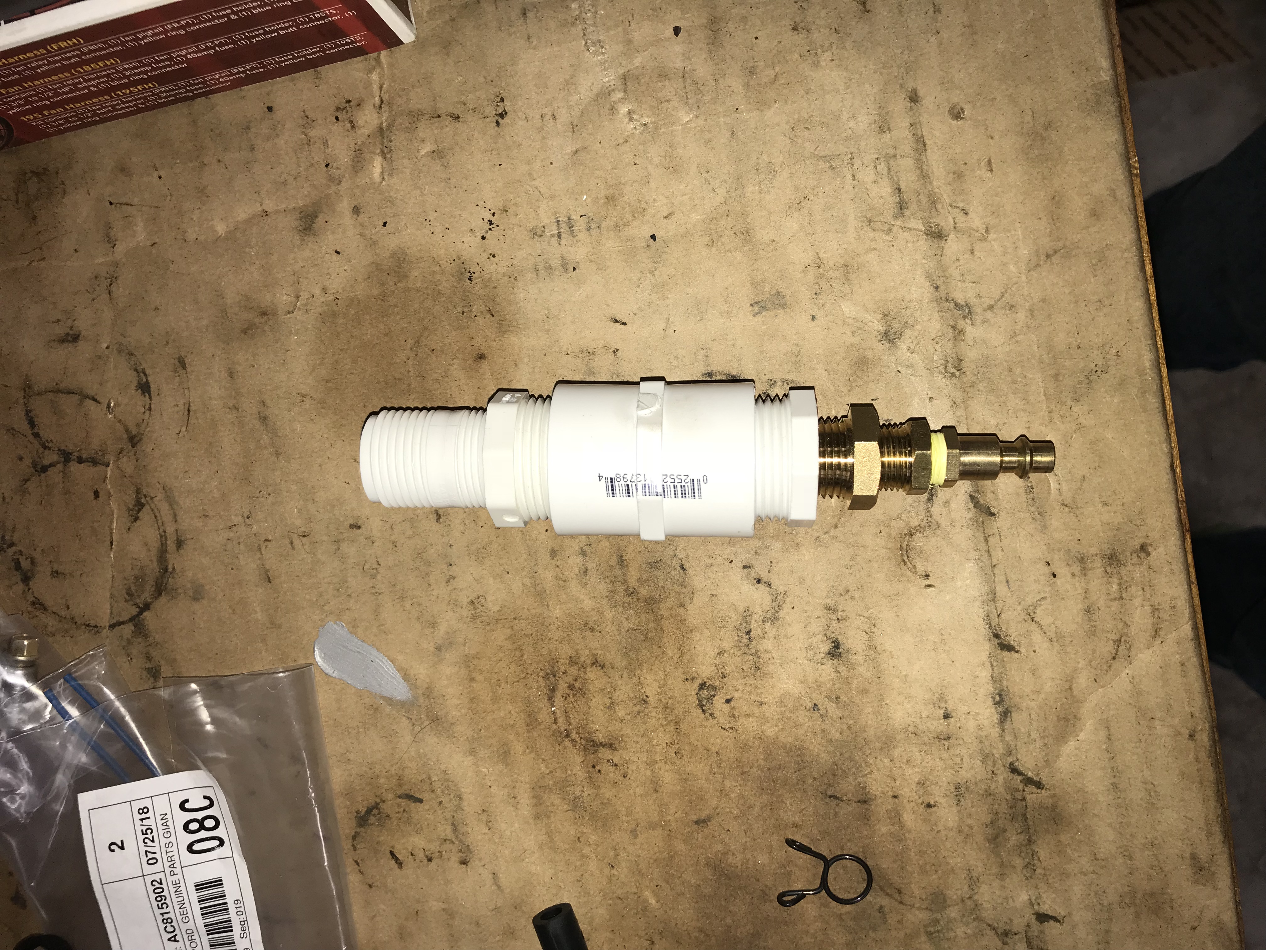

Reviving an old thread. I’m going to flush my coolant system to convert to Toyota Red. I’d like to make my own kit, so I have it at my disposal. Do you have the specs on these adapters? What size radiator hose did you use? What size PVC adapters?

My adapter are buried somewhere and with 110° temp Im not looking.:( A quick trip to HD with a radiator hose in hand would be my choice.
