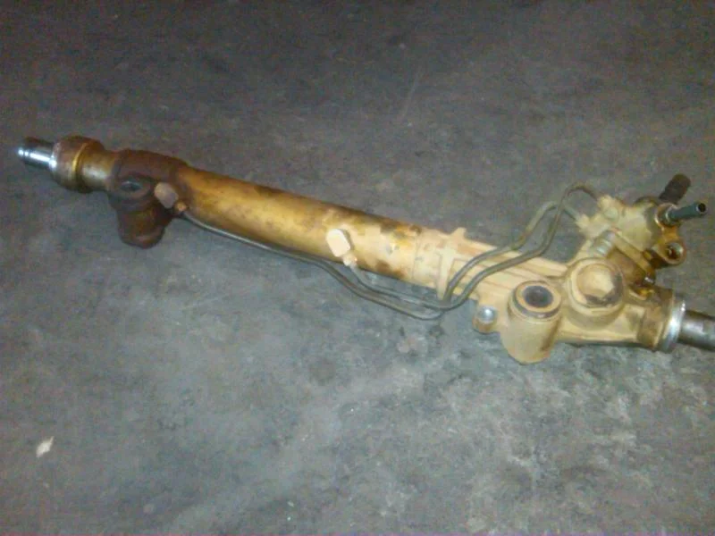

Looks like I'm replacing another rack and pinion next weekend. The original was replaced Aug 2011 with stock Toyota part. I'm losing power sporadically (independent of RPMs). Sam, my Toy parts guy, says they don't have any serviceable parts available, so straight up replacement is all I can do, to keep my daily running daily.
Pic from last time I yanked it out (only 30K miles ago). Surely, this didn't kill it...https://forum.ih8mud.com/showpost.php?p=8412048&postcount=420
Yeah, I don't really think anything I did there would have tweaked it - we did make it 1000 miles back without any indication of a problem.
This weekend I'm gonna break down the rack to see if there is something clogging up the plumbing. I've got nothing to lose (but time) and about $700 to gain. The new rack has already been acquired, but if I can return it unopened... as Wooderson says "it'd be way cooler".

I think you have a good idea to go fishing for some debris that might be in the lines. Just takes a real small part to mess up hydraulics from the inside out. Like if someone used thread tape on a fitting. Real small part of tape loose in the oil can get'cha.
