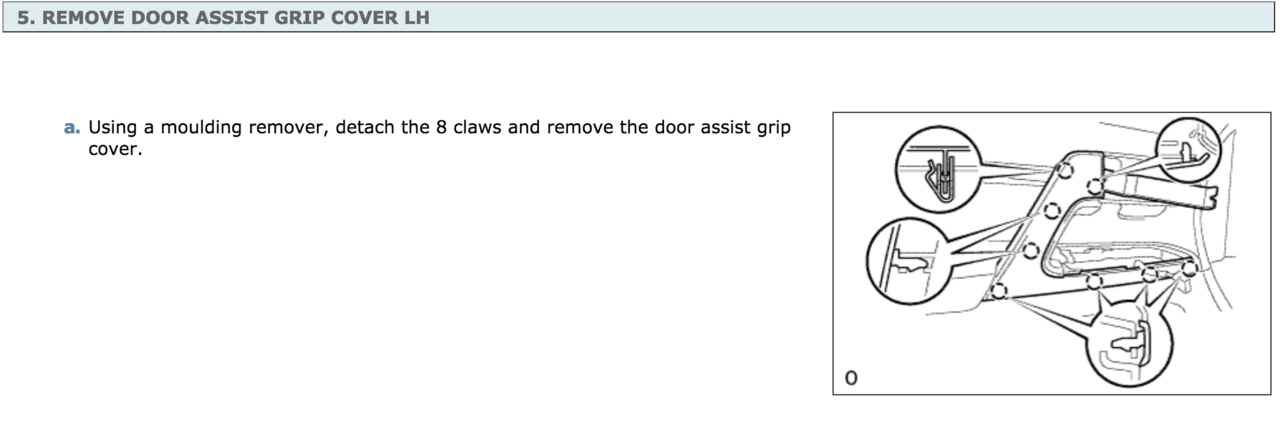

FL: 74611-60060
FR: 74612-60120
RR: 74645-60040
RL: 74646-60040
Just work your way around all edges.
It will sound terrible—like it’s breaking—but it should pop out fine.
