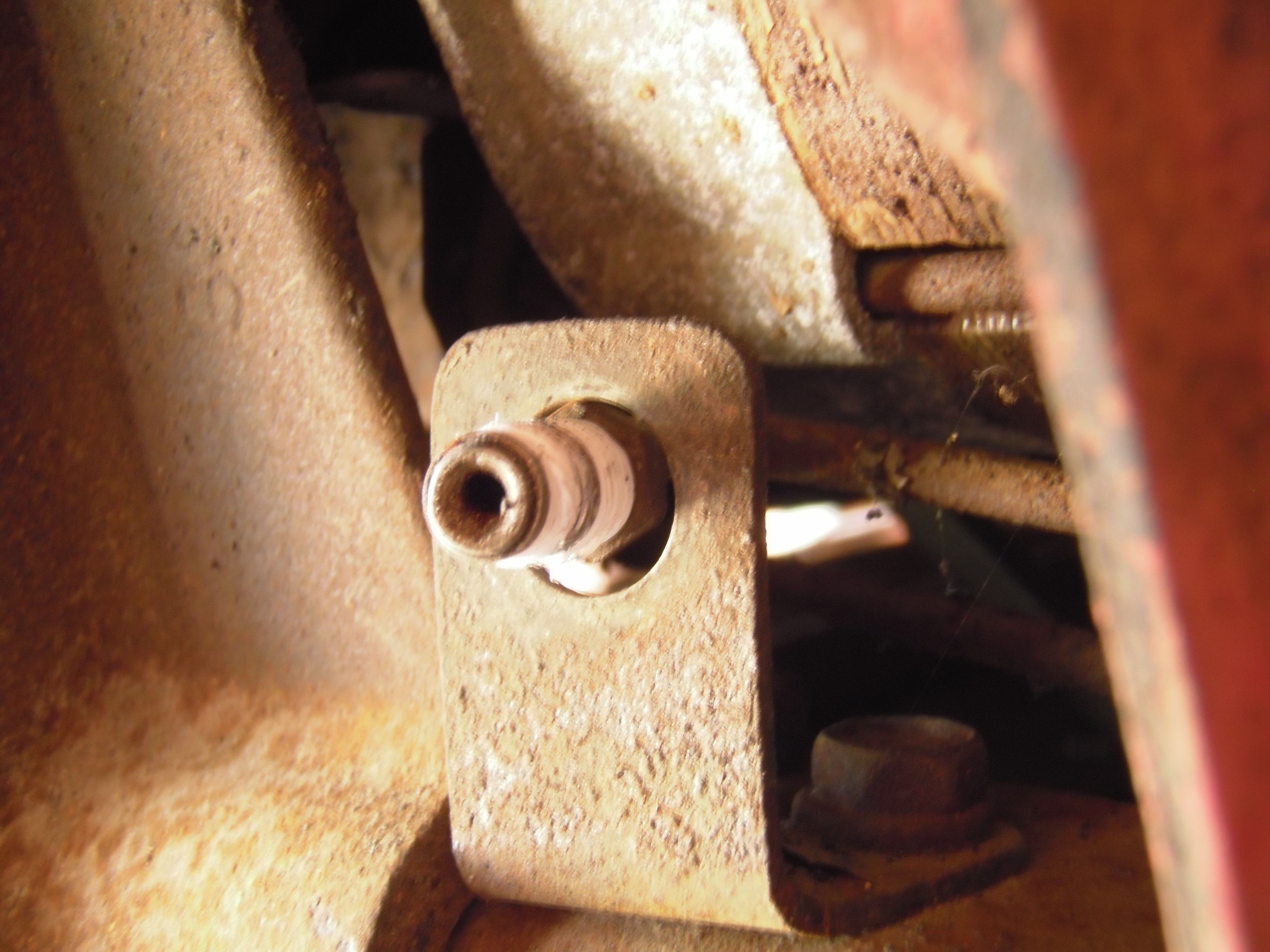

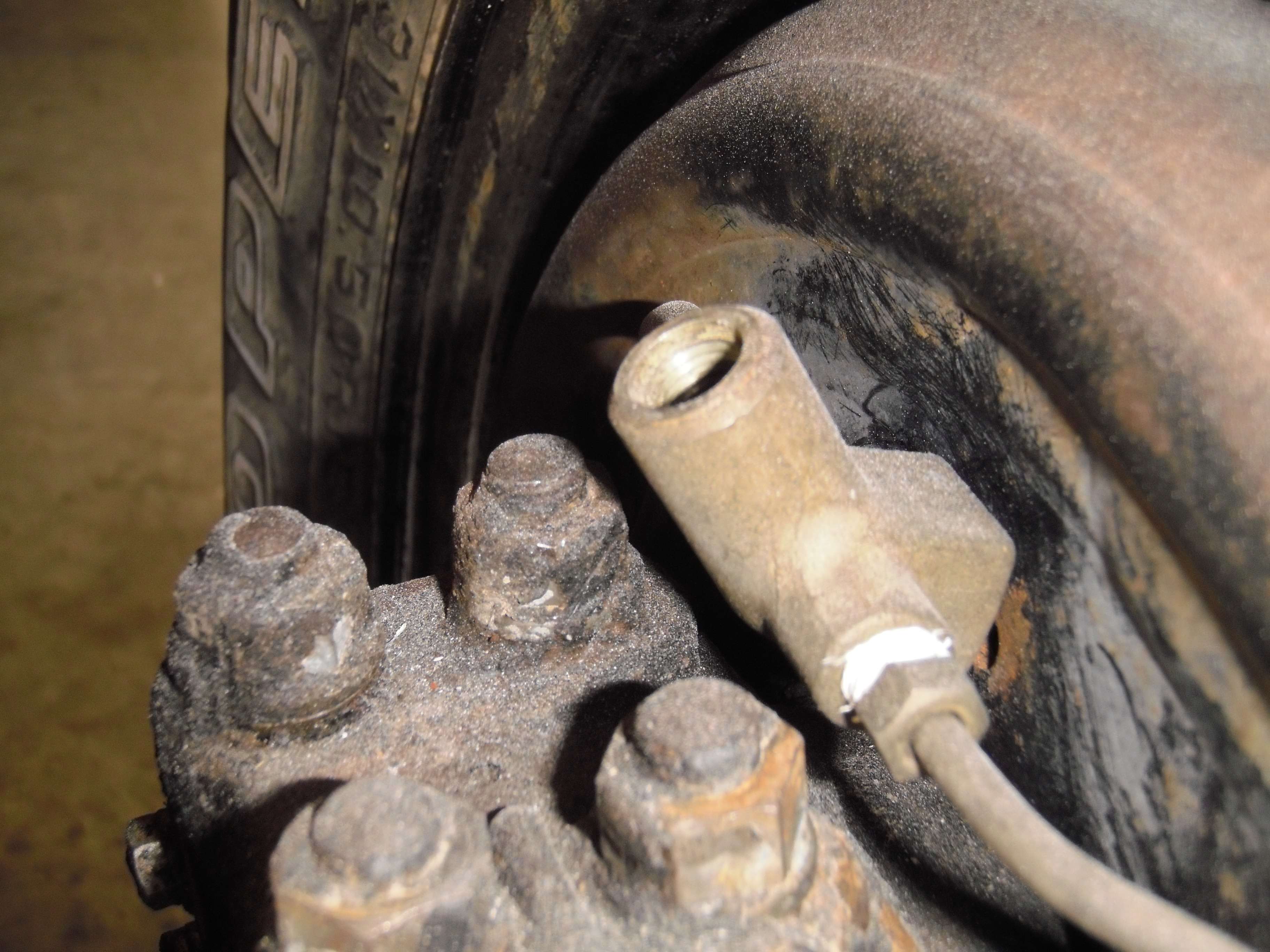

Here's some pics of the front brake stuff. It appears I have 9mm hard lines and 10mm junctions at the drum backing plate.
These lines and junction are off the passenger side front and appear to be stock. It's the bronze colored junction I've seen on others pictures.
This junction appears to be non stock.
Hard lines at the frame.

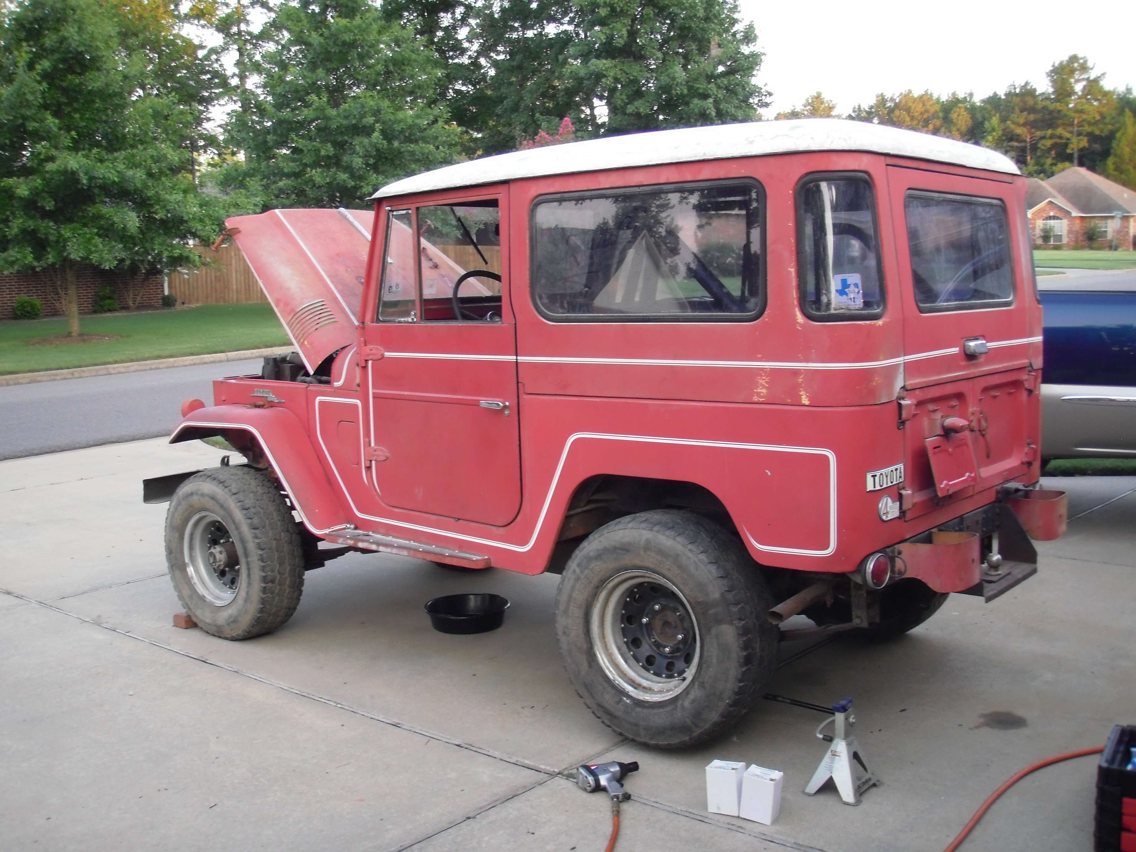

And an overall shot

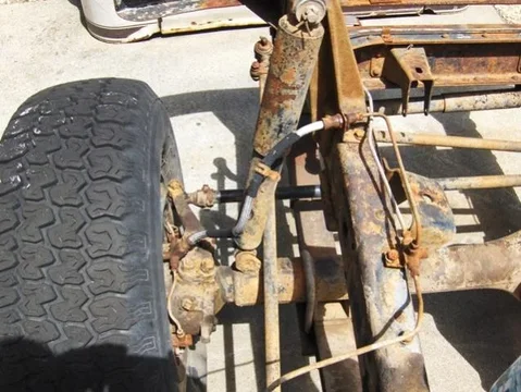

65 front lines
Here is a shot of the front lines on my 65. if you need better detail let me know. As you can see the body is off so they are easy to get to. By the way I haven't replaced my soft lines yet, that's why they look so ratty.
