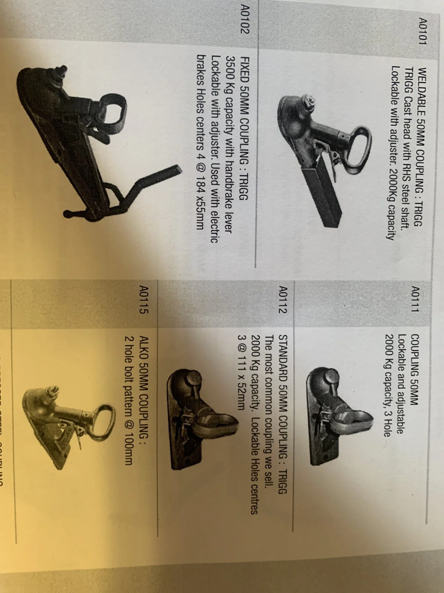

I believe it is these Treg couplers that are being asked about: https://www.tregtrailers.com.au/shop/treg-poly-block-couplings/treg-p-b-weld-on/ For whatever reason they are not available in the US.

Trigg casting is an AU manufacturer , I am currently using a Bulldog Collar loc
Getting parts for my new project, noticed some interesting cast couplers made by Trigg.
Hum, never heard of them. Not a surprise given their normal market.
What's so special about these other than they lock onto the ball in a unique method?
Trigg is really old school. I had one on a 1965 Campomatic. Didn’t weigh much. Would trust it
off road. They wouldn’t meet legal standards of new anymore maybe, I wouldn’t think.
They are a lift, turn, couple kind of thing. It was neat. That Tregg is a completely different animal.
