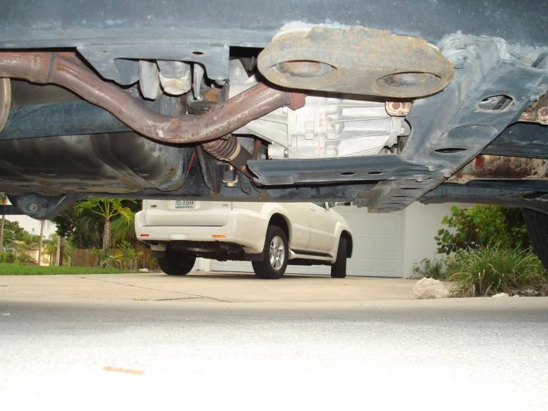

Two questions for the experts. What is the attachment under my LC that looks kind of like an old school phone (see picture)? Also, do I need it? I just removed the running boards and don't really like the sight of it from the passenger side. Thanks.
First post and most will tell you about the search function as this has been covered in great detail numerous times - it is a vibration damper, but several have taken it off with no adverse affects.
For some strange reason, although I do not like its looks either, I left it on as Toyota spent the money to put it there, perhaps it's function is worthwhile. Of course, it could be stopping vibration caused by the running boards????????? Then the last laugh would be on me.

While I agree with BMWSTOY that MUD helps those that help themselves, in this case, not knowing what this thing is, what would one use for a search keyword?

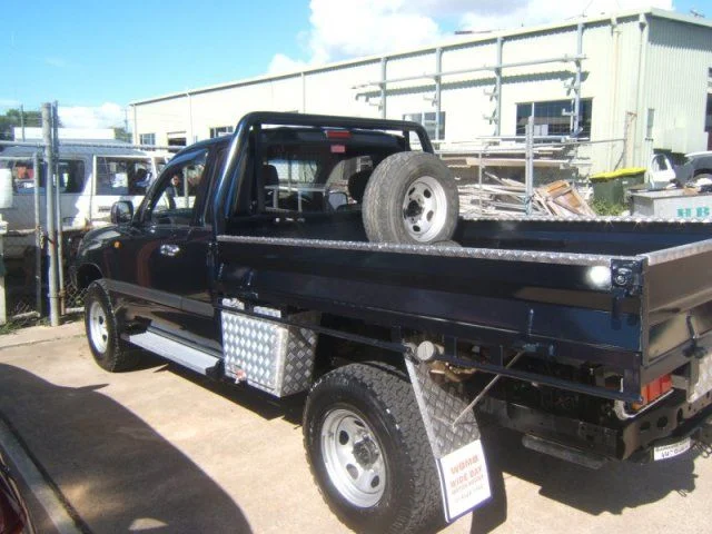

Hi all, I spend nearly everyday of my working week under 100 series cruisers and have never seen one of these on an Aussie model, not even on a Lexus!
Thanks for the information. I have been using the search function, but could not find any information about it. Now that I know what it is, I'll check into it. I just bought my LC a few months ago and have been loving it. It's a 2000 in good condition that has about 78k miles on it. I'm more into boats than cars, so I didn't want to spend a lot of money on a vehicle, but also wanted something that would stand the test of time. I think I've found it. I'll probably put some BFG tires on it, but not much else. My list of needs on my skiff demands my attention first. Plus, I've still got the 90k servicing to deal with. I would love to add sliders and a lift, but I'm not doing any rock climbing here in Florida and just can't justify the cost.
Wreford, saw your conversions page. Nice work! You should start your own thread. Make mine an extended cab tray back please :grinpimp:
I second the request for a new thread on these conversions! :eek:
What creates the market for these ? Are standard dual cab pickups not available ?
It stoops vibrations!
I just happened to be looking at the Technical Service Bulletins section under FAQ and saw a TSB for it:
EXHAUST BOOMING AT IDLE
Service Bulletin : 00304 - FEB 20, 2004 NHTSA Item #: 10006142
MUD Notes: Some 1998 – 2006 model year LC/LXs may exhibit exhaust booming after reaching operating temperature. To correct this there are various procedures for different vehicles. Installing a "Crossmember Damper Weight" (cast iron/rubber device on frame rail) or exhaust pipe dampers tuned to different frequencies. Credit to 100TD.
Like most on here I removed the cross member dampener after yanking the running boards. Fast forward a couple thousand miles and I was always slightly annoyed about a rumble/vibration in drive at idle at about 500-600 RPM. I reinstalled the unit after putting on sliders (you can't see it anyway now) and it definitely reduced the vibration. Just to add to the conversation. I know I am reviving an old ass thread, but its in the FAQ so...
