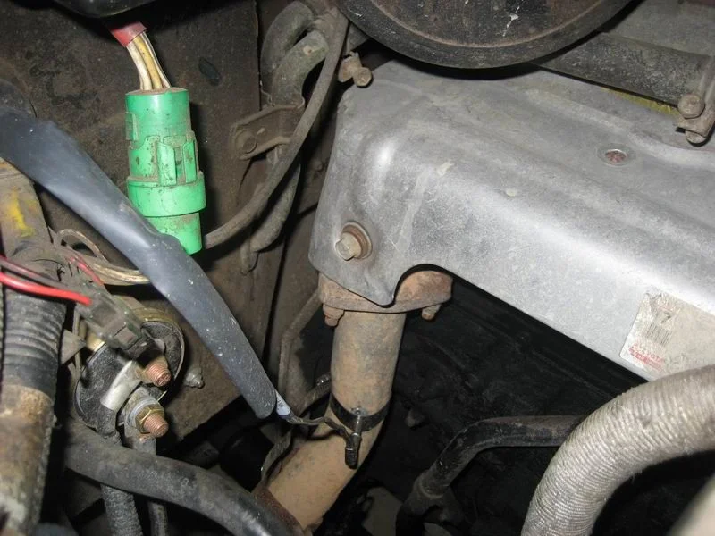

i've been trying for the last 3 hours to solve this, even with the gauge directly on the battery and thermocouple, sometime it wouldn't work sometime it does..Then step by step i reinstalled the extension. I am now sure the issue is the ground when i have the negative wire of the gauge in hand and touch at different place to get a good ground, sometimes it work but usually not. Seems like i need really good ground. I've been for 3 hours looking at the same spot under the hood and never ever notice that huge flaw mostlikely causing my problems!
Can you see the problem in this picture?
attachment.php
Look closer.................:doh:
anyone know the size of the bolt that goes there?
In case you don't know it is the block to frame ground!
Er, yup. You can just see it on the original picture if you know what you are looking for but I didn't see it, just suggested you take a look though. The missing block ground is not good and fixing it will probably solve your issue. You've got an incidental ground from frame to block but who knows via what path.
Give both the block and the ground strap a good clean (remove oil & grease and wire wool or lightly sand) where they join to get a good ground. The use of a star washer between them will also help as this will "bite" between the cable ring and block.
If you cannot find an appropriate bolt by trial and error, I'll go pull mine and let you know. It'll be a standard Toyota metric bolt, probably [edit: M12 x ?.??. Looking at my vehicle M10 x 1.25 doesn't look beefy enough. If you don't have a thread gauge, buy one, they are indispensable. This bolt also holds an exhaust pipe clamp on my truck. I'll have to move a bunch of stuff from around the vehicle to get to it.]

Been looking for a bolt that fits there, found none. It is about 1/2" so about be M14. but i'm not sure, it is not M12 for sure. I'll check at toyota tomorrow but i doubt they will give me thread size, but just a part number to order..
Yeah i need a thread gauge..
I will temporarily install a other ground from block to frame until i find the bolt that goes there.
BTW mine doesn't hold a exhaust bracket at least not this specific bolt.
ANYHOW! that was my problem i used a vise grip to hold it in place and the pyro works numero 1 (number 1).
Sabretooth don't remove it yet unless toyota cannot give me thread size.

Just for clarification in case others read this thread with a similar problem, the thermocouple (probe) does not require a ground per se (it has two wires and that's all that is really needed), it just needs to have the exhaust manifold and the gauge ground to be about the same and not fluctuating. (It's has to do with the input circuitry for the gauge. All input circuits require a reference of some sort or another or are usually voltage limited and if the frame of reference (offset) keeps fluctuating, that is just bad for measuring sensitive instruments).
The missing block ground strap in eleblanc's case meant that the manifold ground and gauge ground were not referenced to each other. When the vehicle is revved the relative ground shift between the two points will likely vary and this effectively masks the very small thermocouple signal and renders the reading rubbish.
