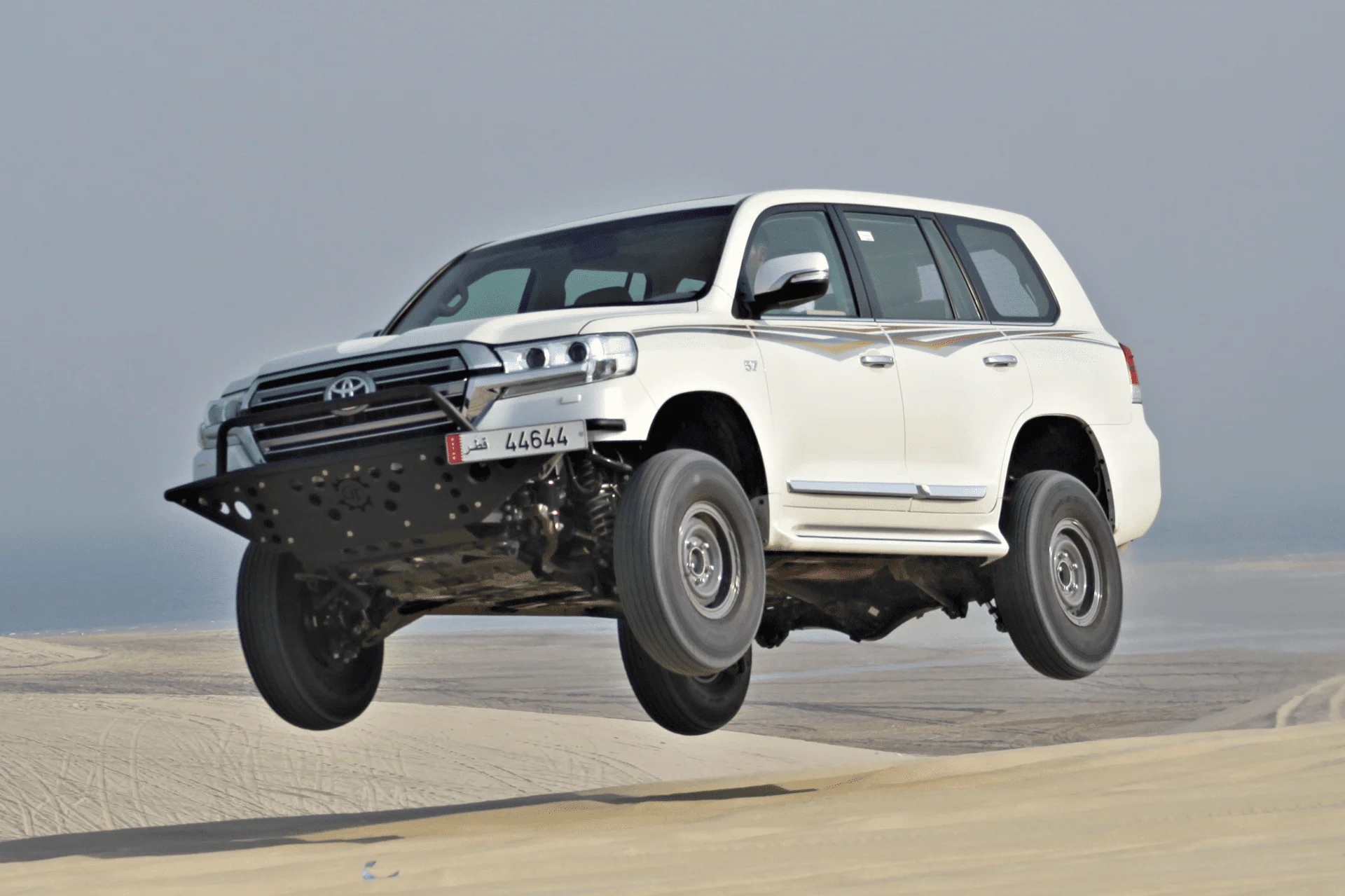

The steelies you see in my setup are 17 inch, they are manufactured by toyota mainly for the 70 series line up. We like them because of their offset position. They are inside meaning extra uptravel, no hitting the body + steel bends unlike alloy. I can just hammer it back.
17" steelies are exactly what i'm looking for. I can find 18's easily here but not 17's. Do you happen to have a part number so I can try and find them here?
it appears you have forged rear lower control arms? Where did you get those?
Just a skid plate that came with the secondary ICON shock kit. Nothing special. I like the stock lower arm. Never had a problem with it, lighter then other brands.

Looks like your LC has integrated sidesteps like LX570s have int he states? Rather than the separate side sill and steps?
Love the aerial acrobatics. Who would have thought that she could take flight so elegantly. Lighter is really better. Even on a big girl.
Do you have any problems with the stock front bump stops? Or are you using something else entirely?
Having been under my truck they seem somewhat flimsy given what some people are now putting them through.
Stock bump stops work fine. I tried running King bump stops (2inchs of travel) and they did not work well since the lower arm had just half an inch of gap. This made it ride unnecessarily harsh.
