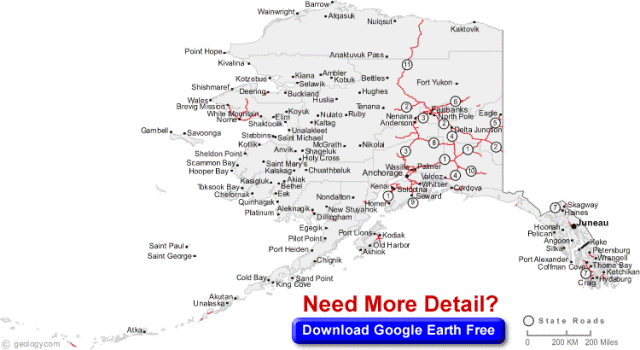

2mbb no worries about the goegraphy about 866 miles from Anchorage to Purdoe bay, one way. I am in Anchorage. Dalton Highway is basically middle of nowhere proper aka gods country. Gas and little else is what I understand about whats available. Hope that helps you understand the challanges.
map in case it helps going from anchorage to the north end of highway 11
