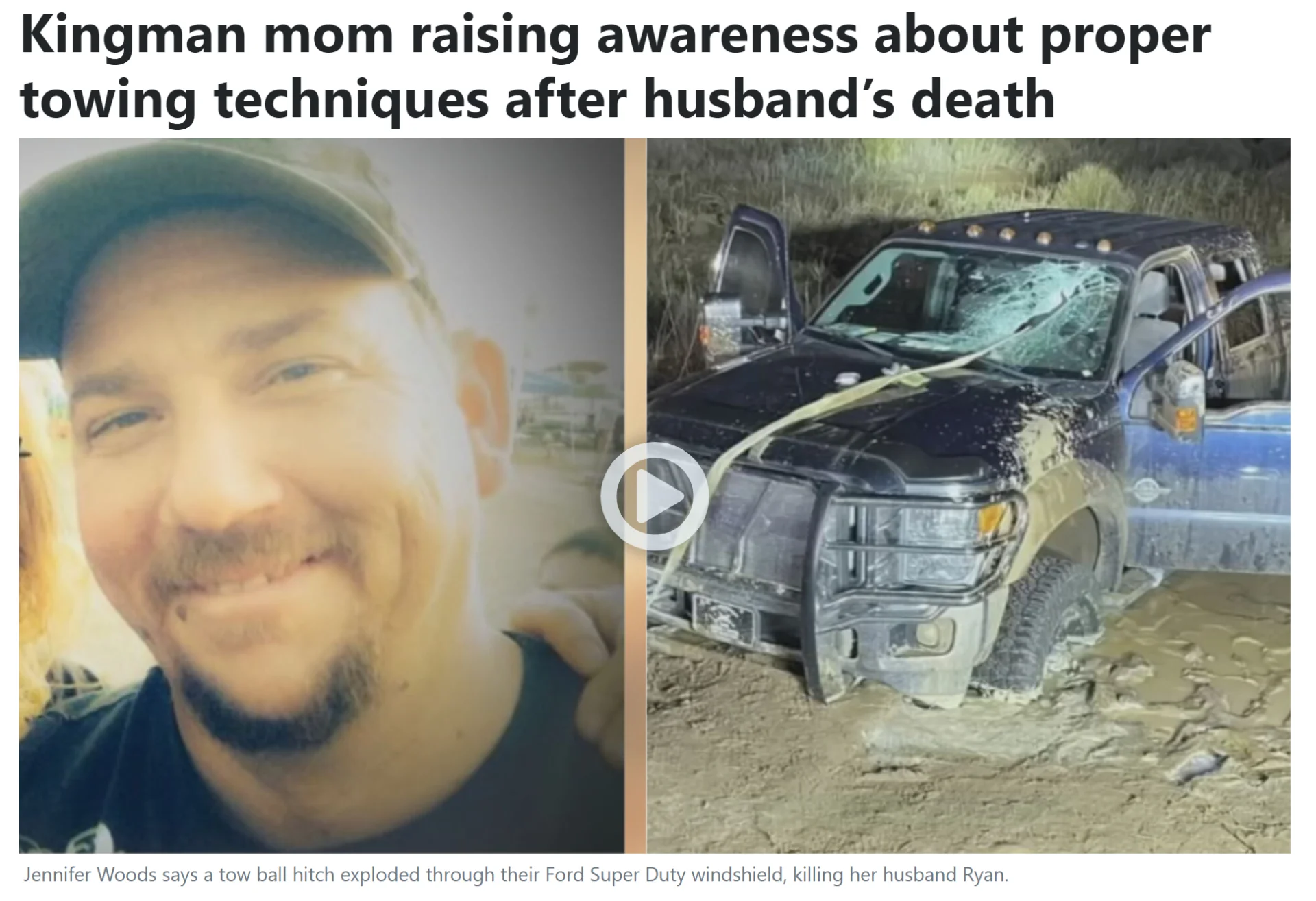

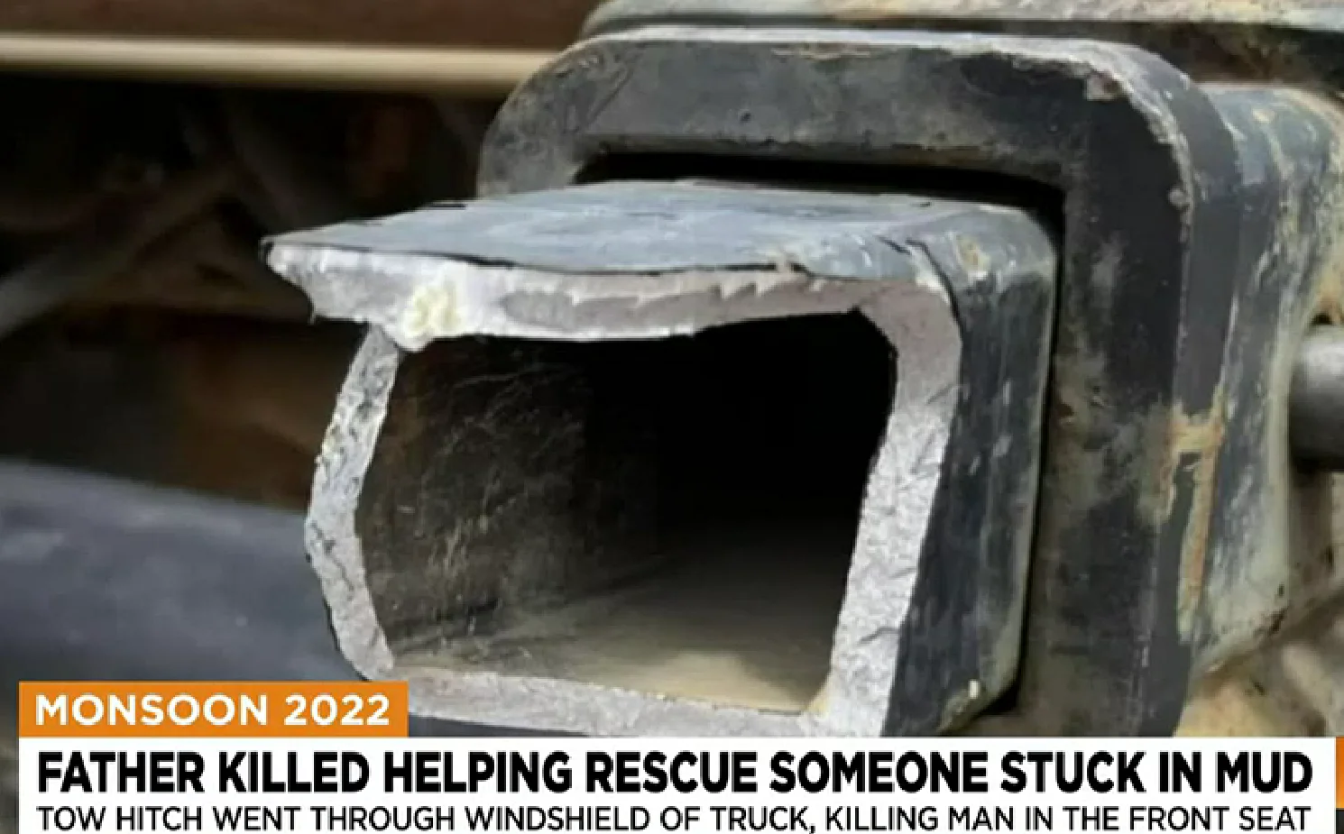

Saw this on the news last night - the drop-down style ball mount broke apart with a fatal result.
This happens way more often than people think. I have seen it a few times, but never more than property damage. Anymore I leave when big diesel trucks get the chain out...

@Stepmurr, you should post this on the main forum as well. This is another reason that when recovering a vehicle, you should but a heavy blanket or drape something heavy over the line and, more importantly, raise your hood. Don't know if it would have helped much though, I think the ford hoods are now aluminum.
A blanket or jacket should be draped over steel winch cable (or chain, if you roll that way), to slow the cable if it breaks. A blanket isn't needed on synthetic winch rope or straps, and won't help much if there's a chunk of metal attached to the end no matter if it's strap, rope, chain, or steel cable. Above all, make sure any metal you attach to or with will not break loose- whether it be a D-ring (shackle), attachment point, receiver or bumper, or whatever random car part you think you want to attach to if there's no recovery point. (I prefer axles or suspension arms- never a factory tie-down, sway bar, or anything else that's not meant to take a lot of stress.)

I finally watched the video and see the length of the drop hitch that snapped. Between that and size of truck and how deep it was in the mud leverage played a big part is why it broke. Have have no plans on switching to synthetic line. My issue with that is it's life span. Had a government job and was OHSA trained to death. Anything from hard hats to safety harnesses had a five year life and were suppose to be replaced. Very sad what happened but even synthetic rope would have not prevented the hitch from breaking. This was a job for a heavy duty tow truck. At the very least a effect should have been made to dig the truck out of that mud or waited for the ground to dry out. Using a spring shackle and synthetic rope would not have gotten the job done.

I don't think anyone is suggesting that synthetic rope would have averted catastrophe in this example- it's very clear that the drop hitch was the failure point, and why. We're just expanding the discussion to include 'best practices' for recovery. You can certainly use steel winch cable, but you should know how to mitigate the risks if it fails. Personally, synthetic line offers so many advantages over steel cable that it's worth ~$100 to replace it as needed, and there are ways to prolong its useful life quite a bit, such as not leaving it exposed to sunlight when it's not in use.

A stretchy rope like the yankum could have helped but the main issue is that drop hitch like @-Spike- and everyone else mentioned.
