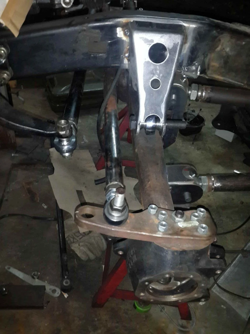

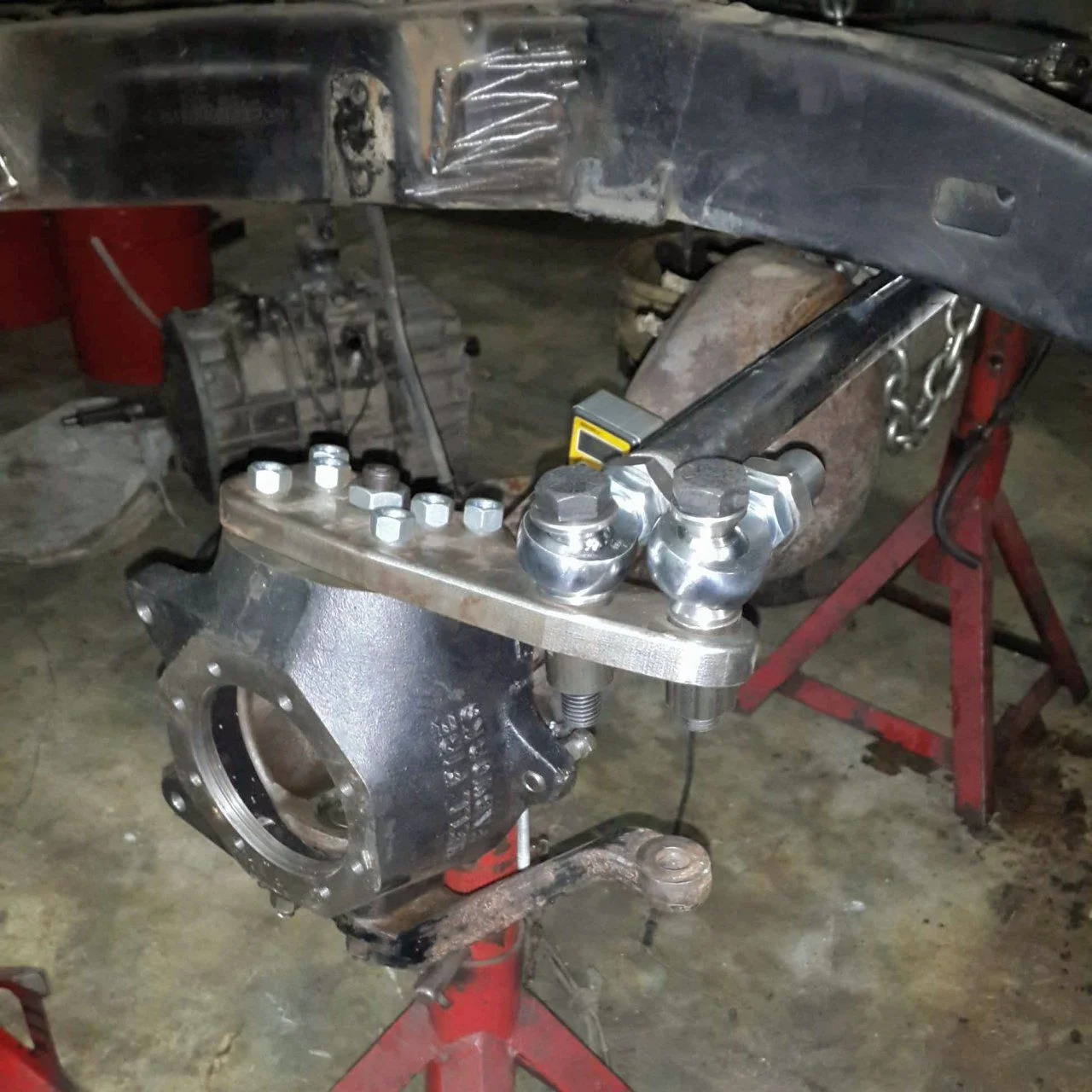

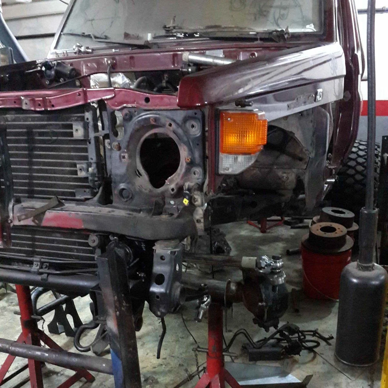

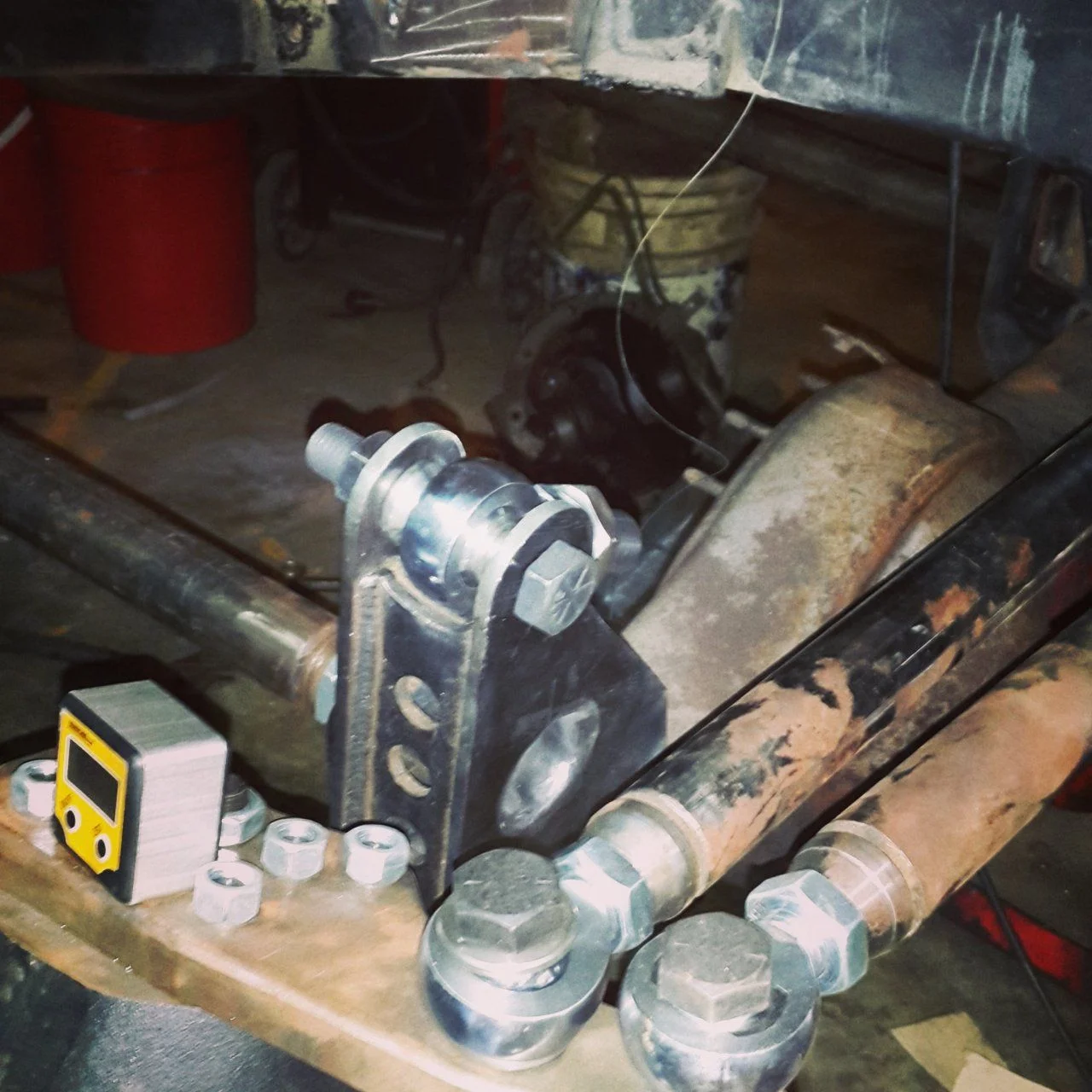

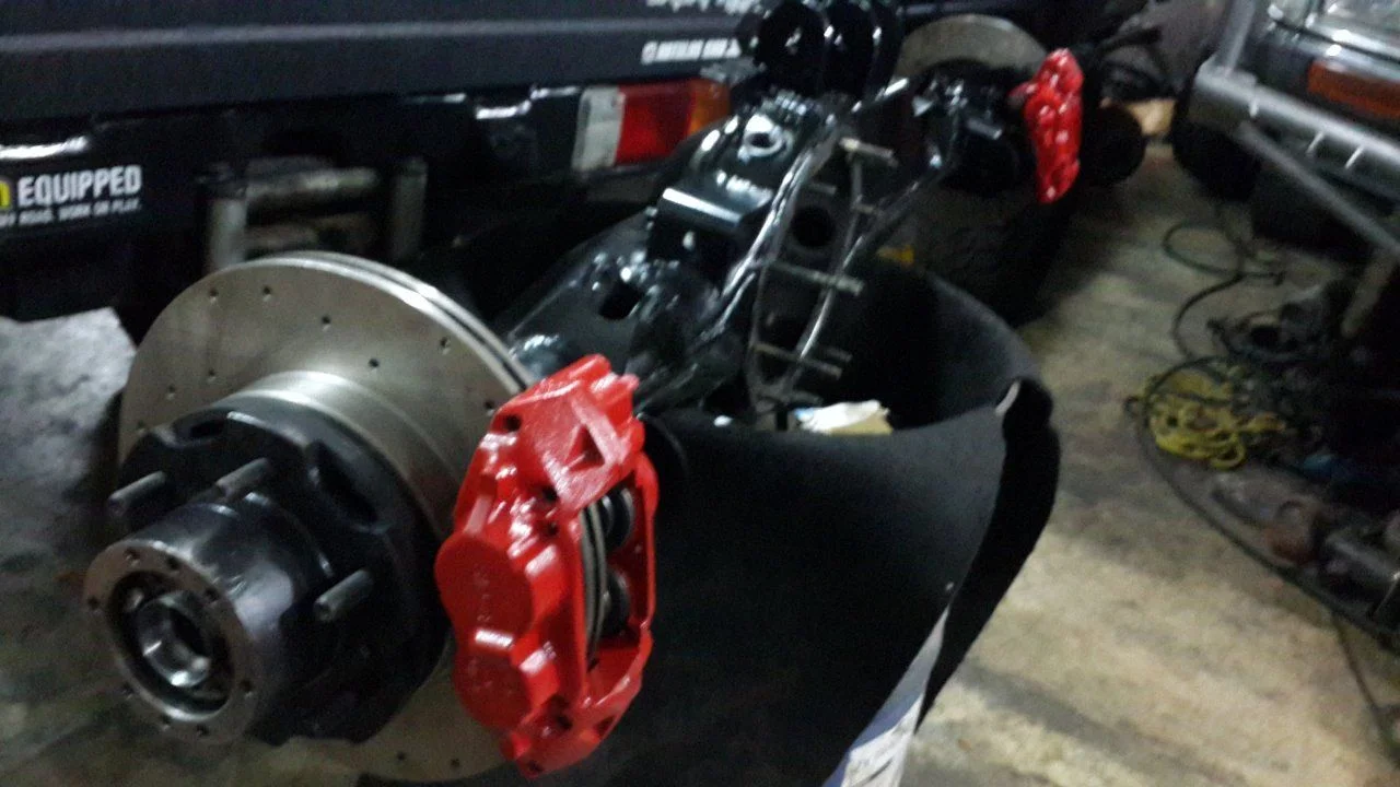

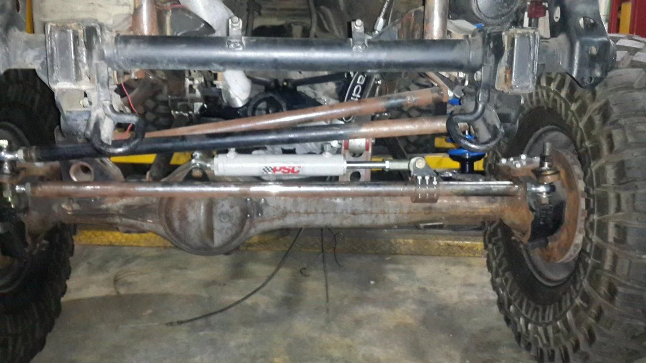

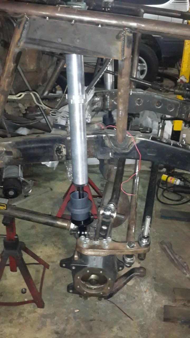

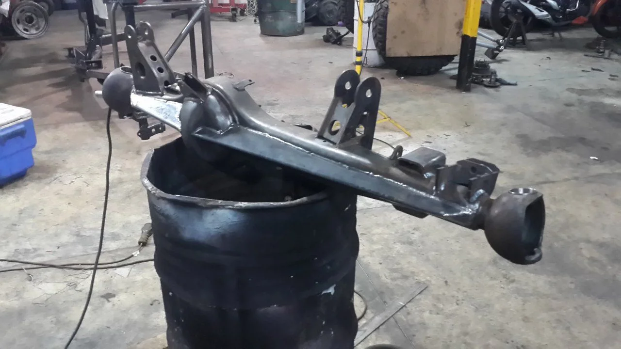

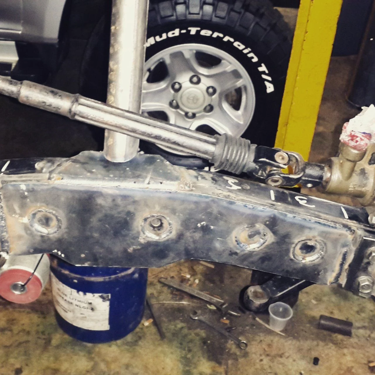

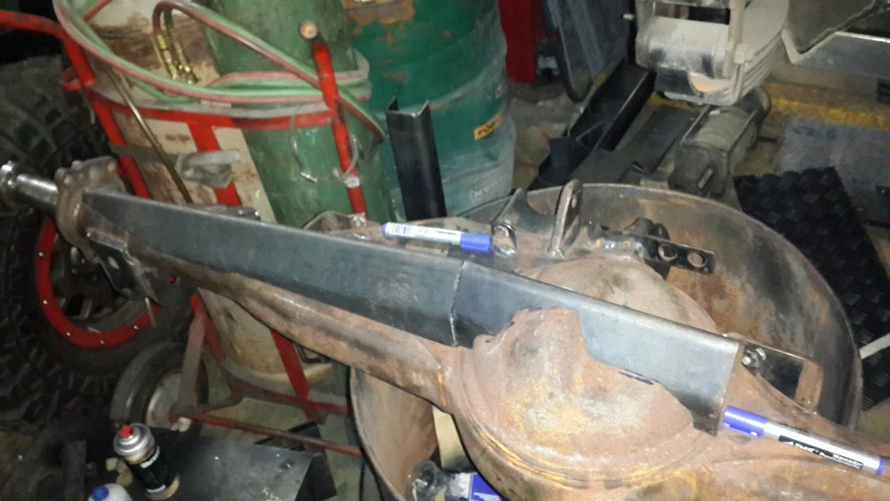

cleaning up front for star the fron 3 link suspension. fzj80 front axle with hell fire ends... problably will change for a custom 9.5 front with fzj80 end.. but for right now its ok. steering kit from ballistic fab
Oh man this thing is cool.

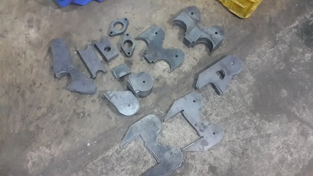

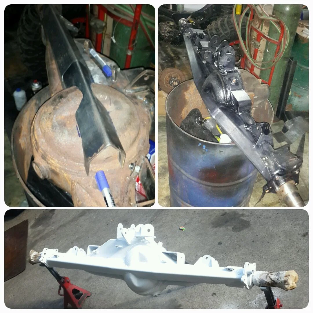

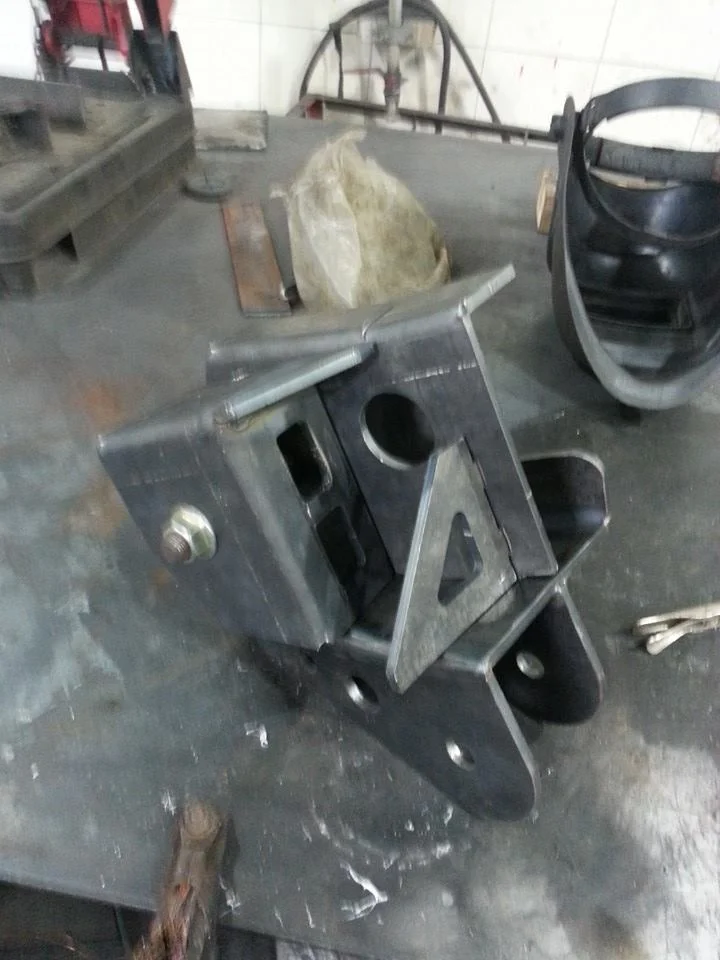

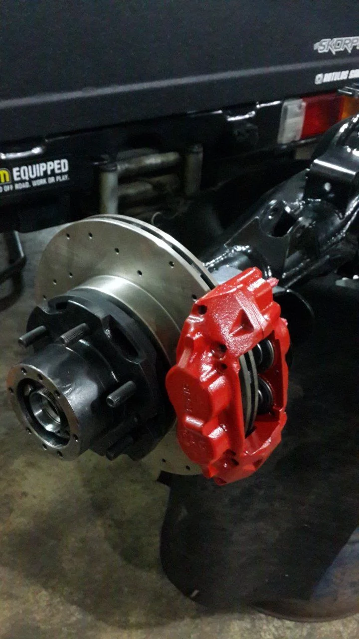

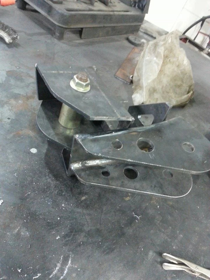

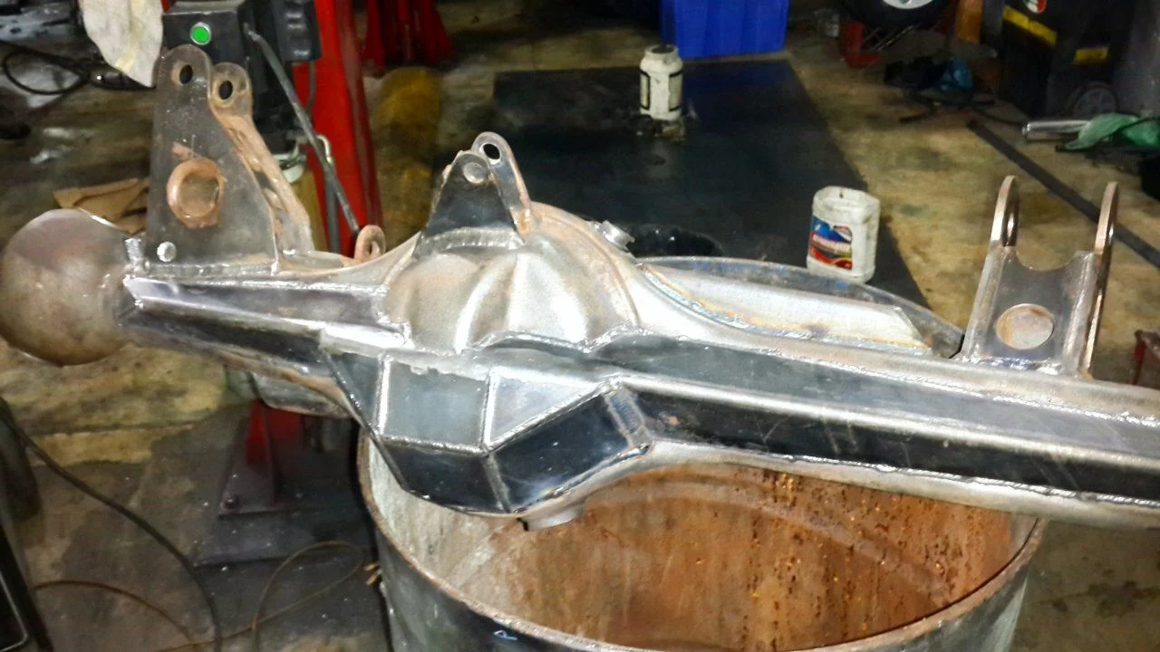

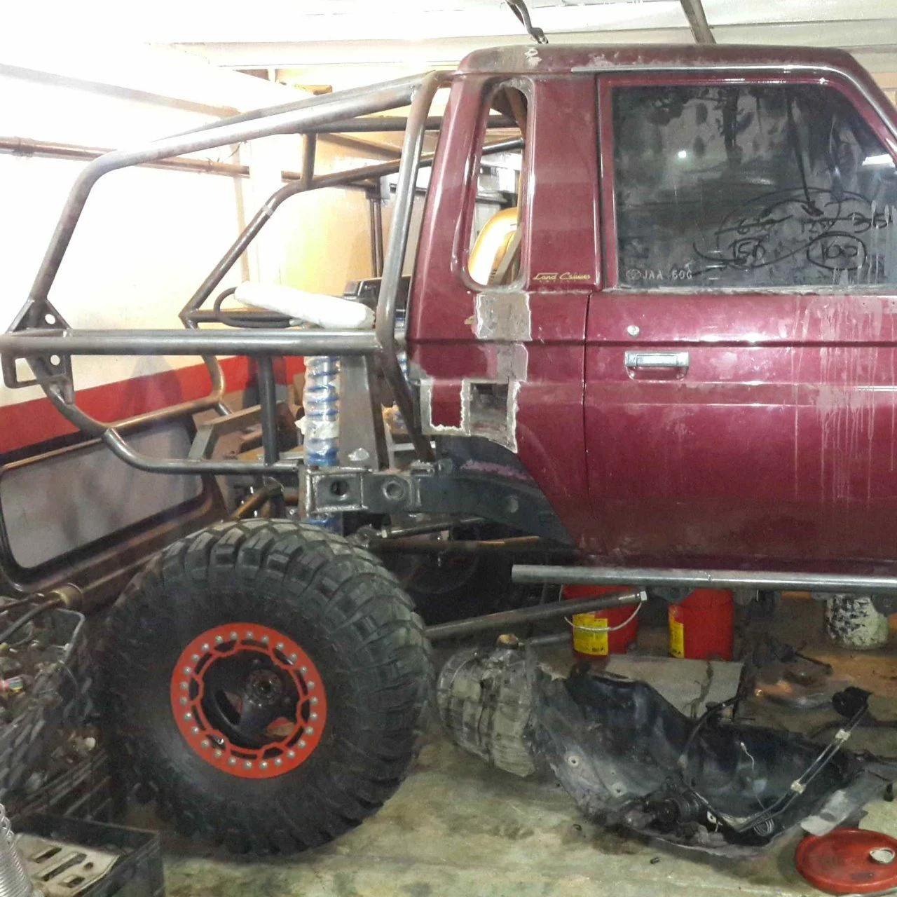

fabricating parts... here we have to do all.... no kits for ours landcruiser !! I didnt know the diference between 70 series axle an 80 series are weird... its 15cm wider .. in the rear is 7.5 each side wider but in the front I thought it would be the same... nooooo shame on me... Had to design everything ... its almost the same side de short part as the 70 series and the other side is 13 cm ...

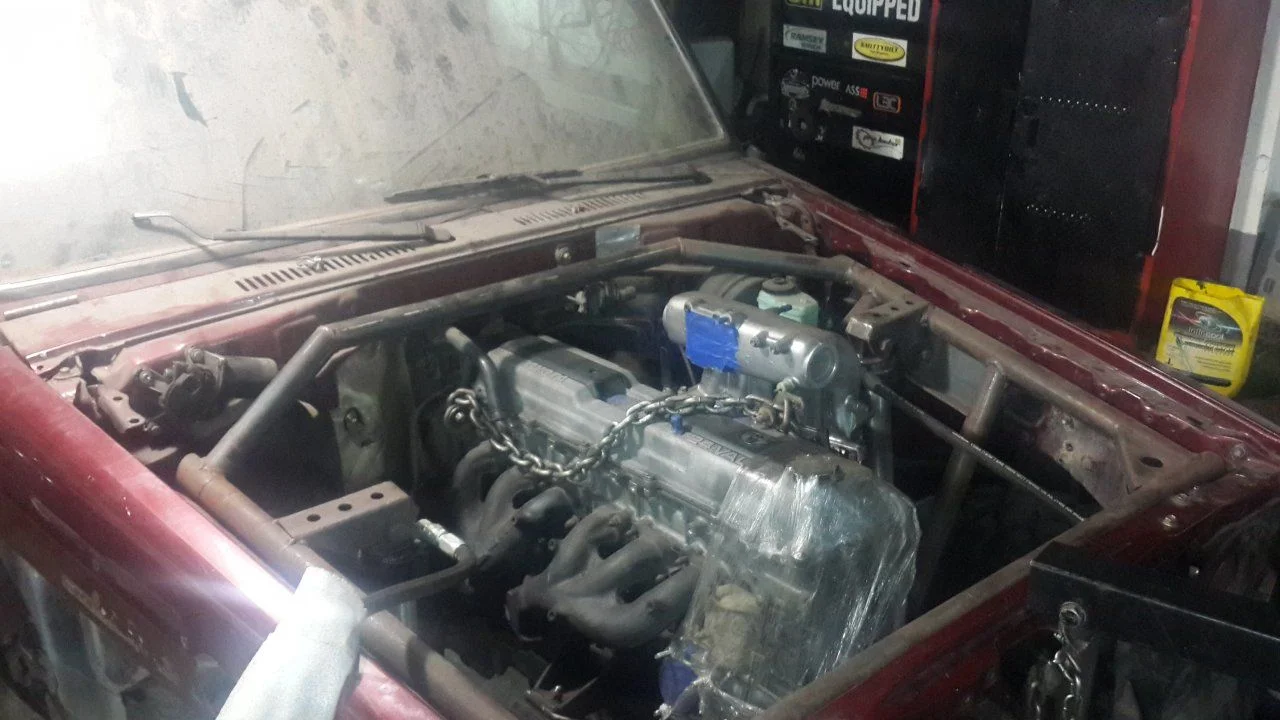

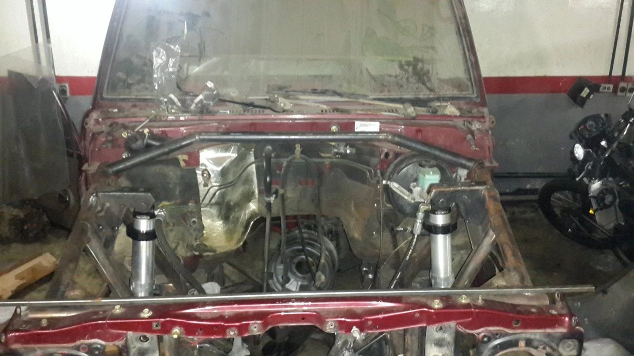

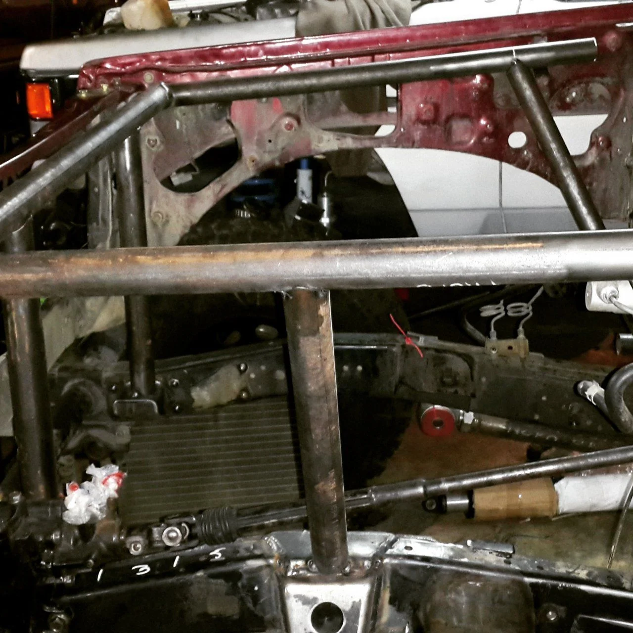

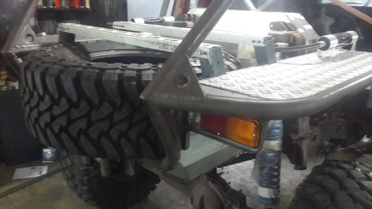

I think Im going with a engine cage ... the coilovers are too long... and I dont think it will be a good idea to make just a hoop ..

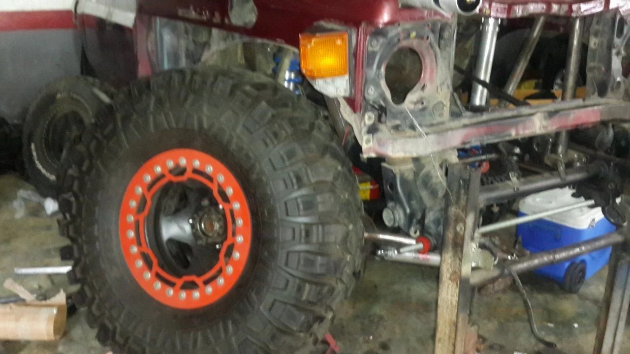

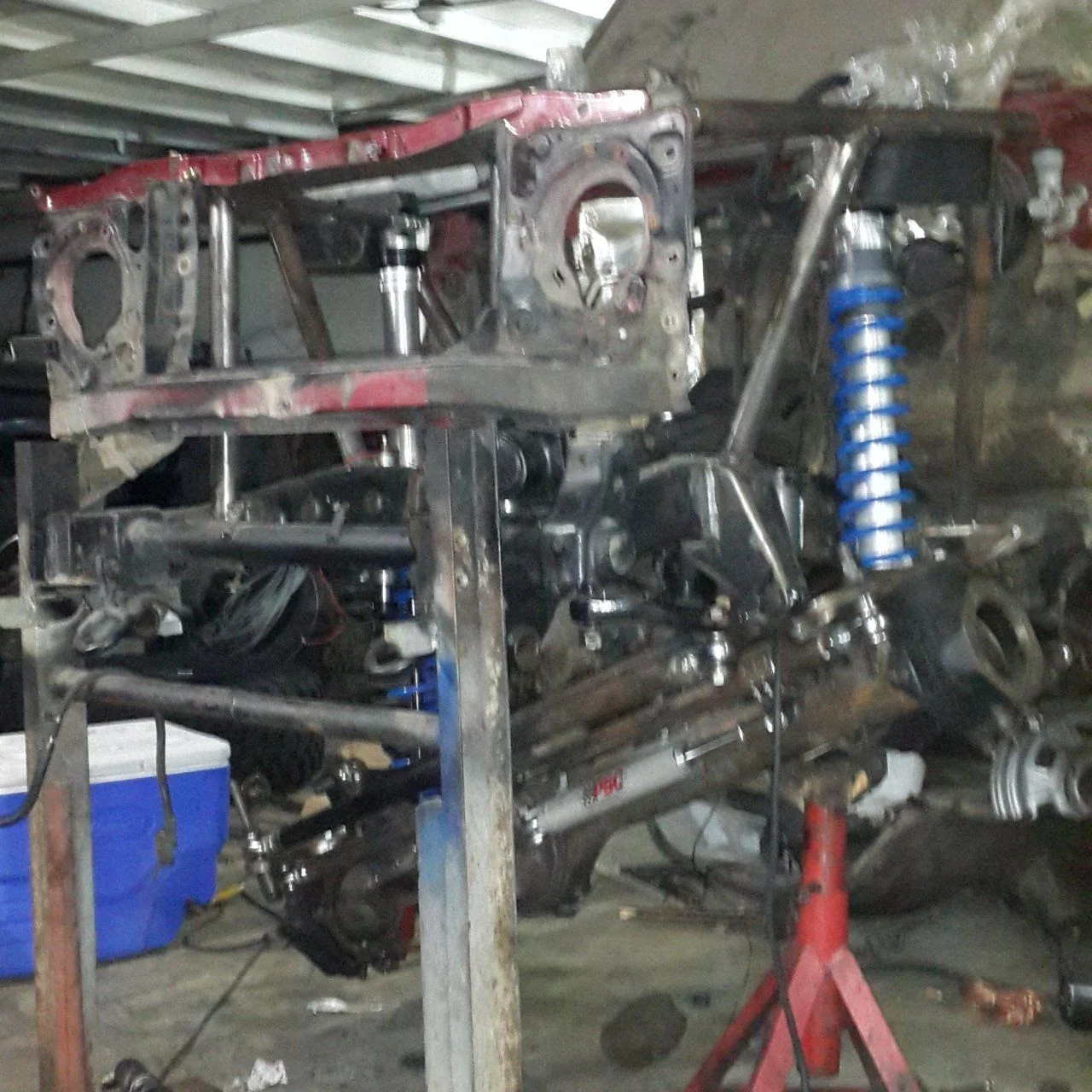

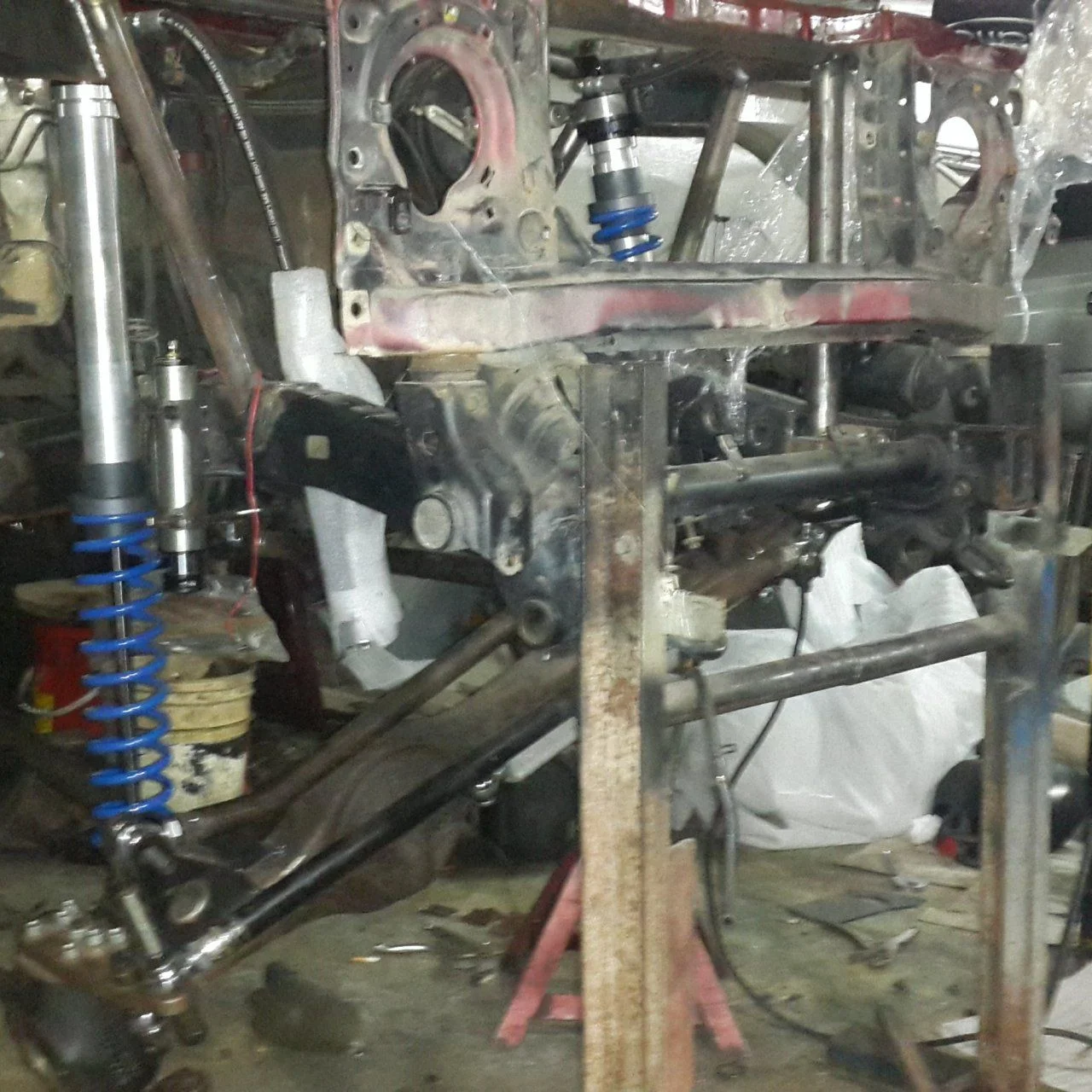

yes thats what Im looking for.... but have some doubts I took the weight of the car.. and the number get me on 150 over 250 lbs coils overs... but i get scared because me driving it hard... so I went with 200 over 300 but still little bit scared... probably need sway bar

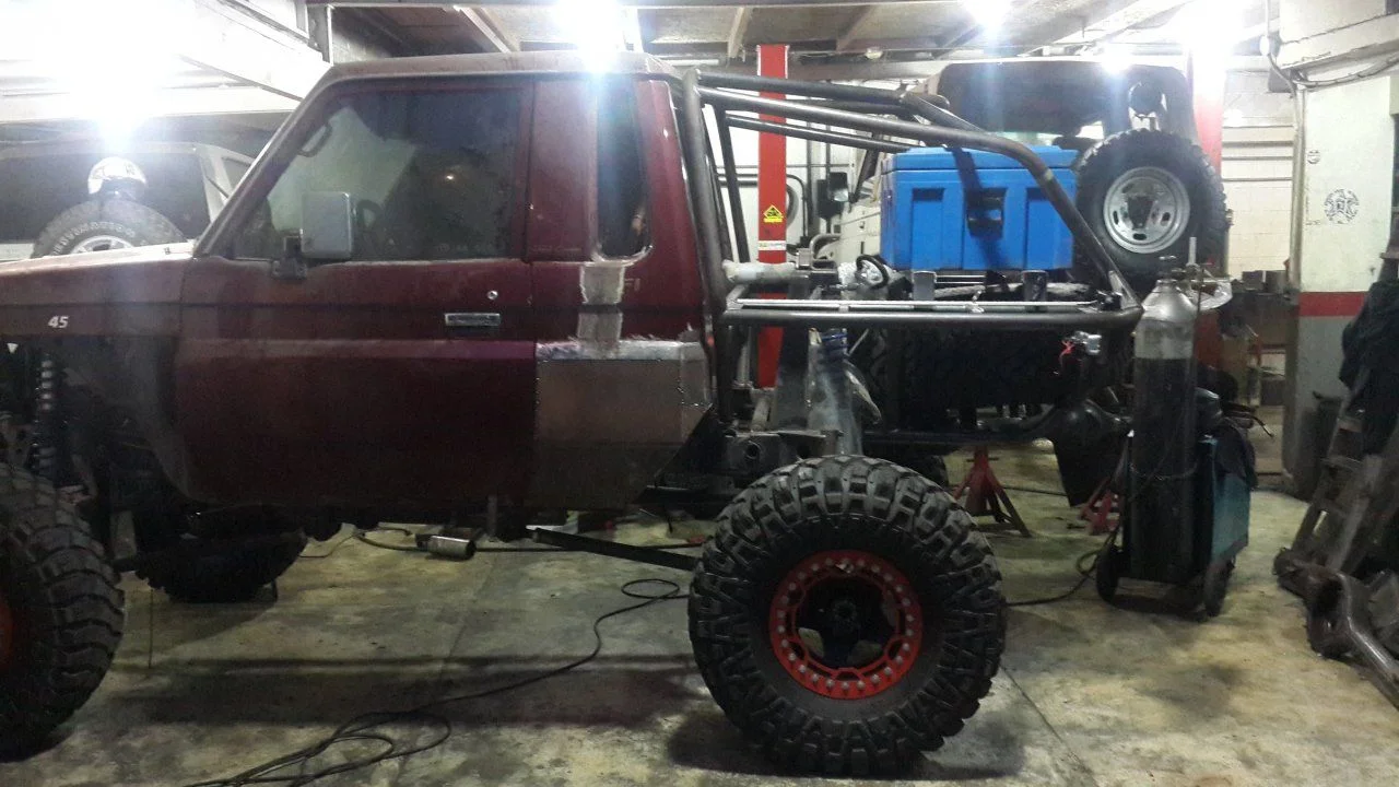

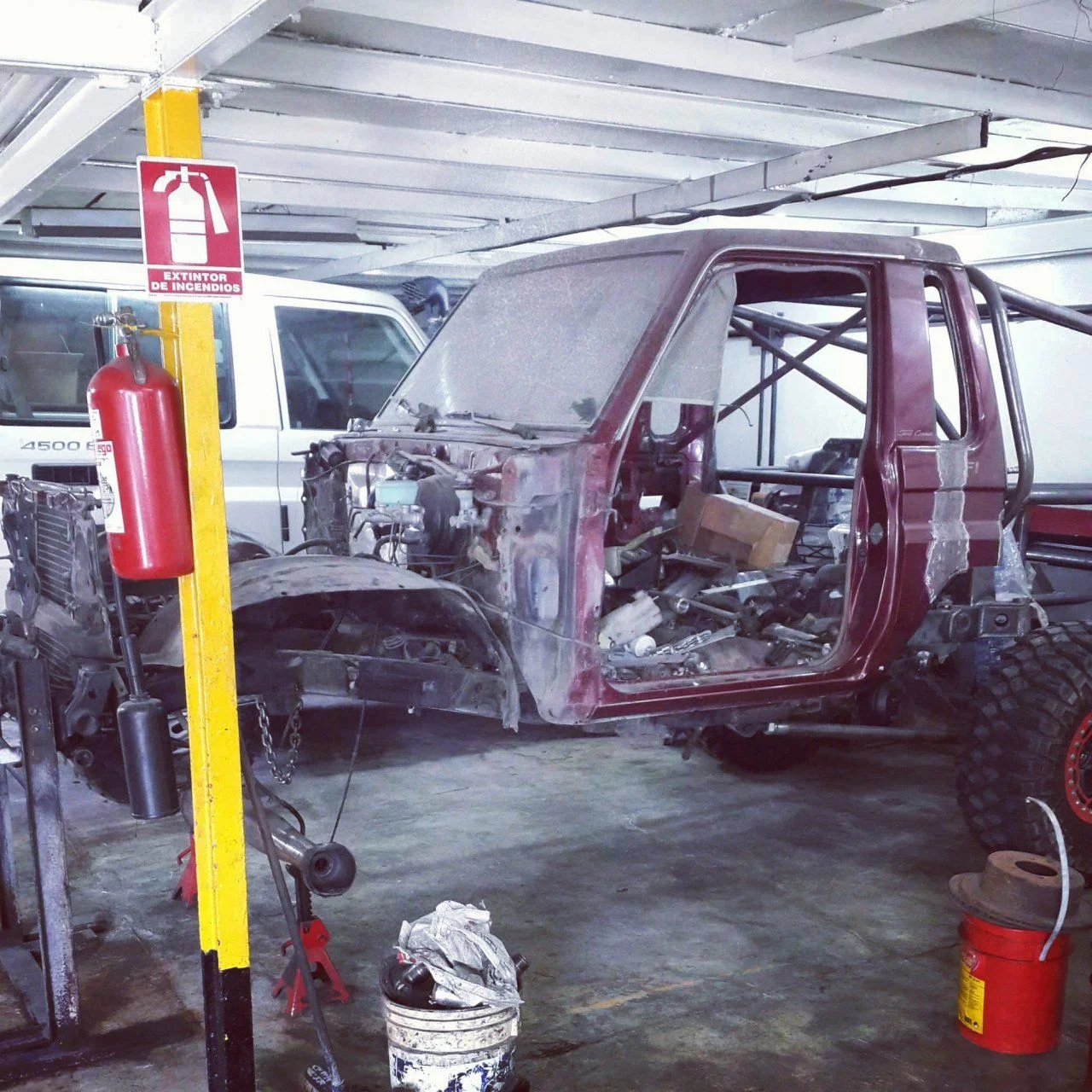

working on the engine cage... probably on monday isntall the engine to check everything is in the right place

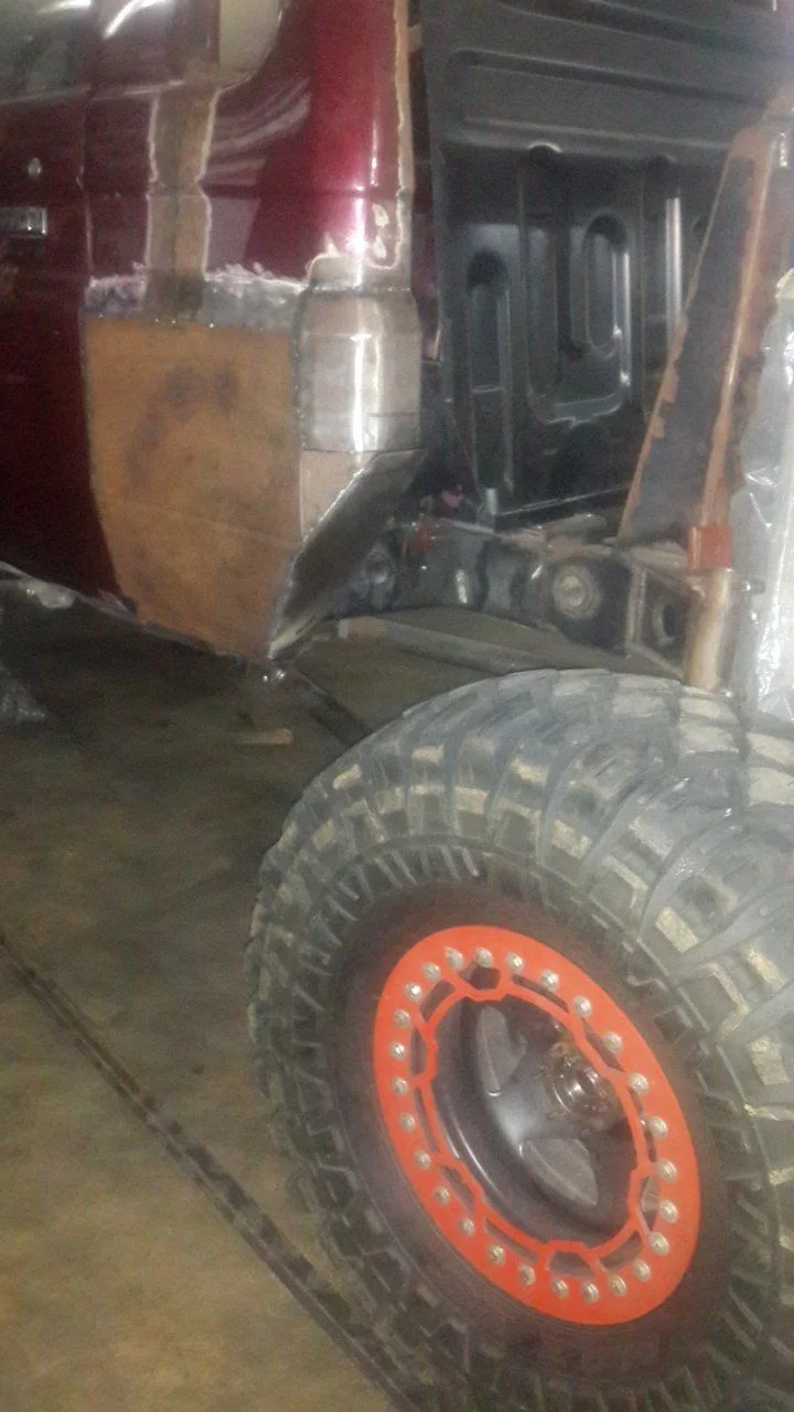

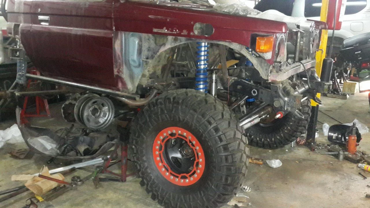

frame reinforment.... check some travel ....and put one tire to see if it fits :bounce::bounce:

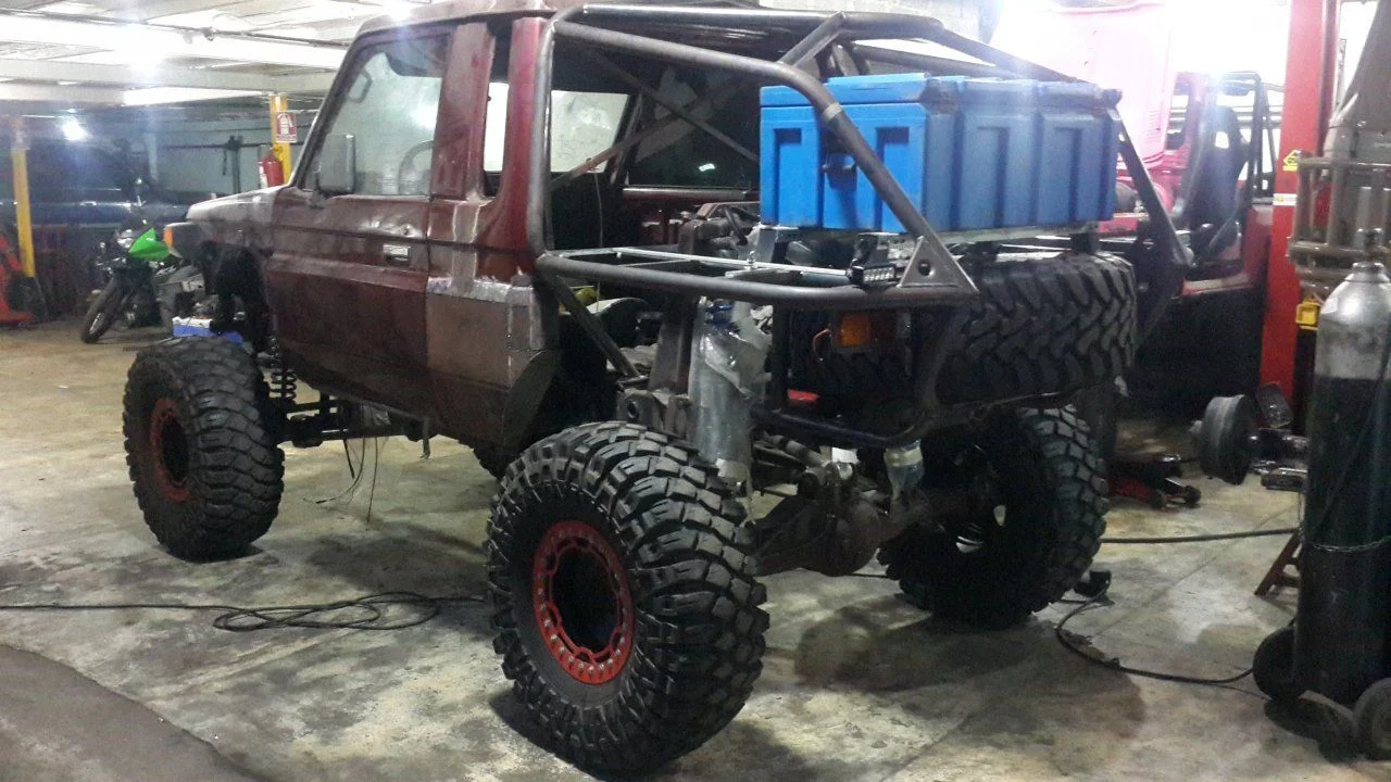

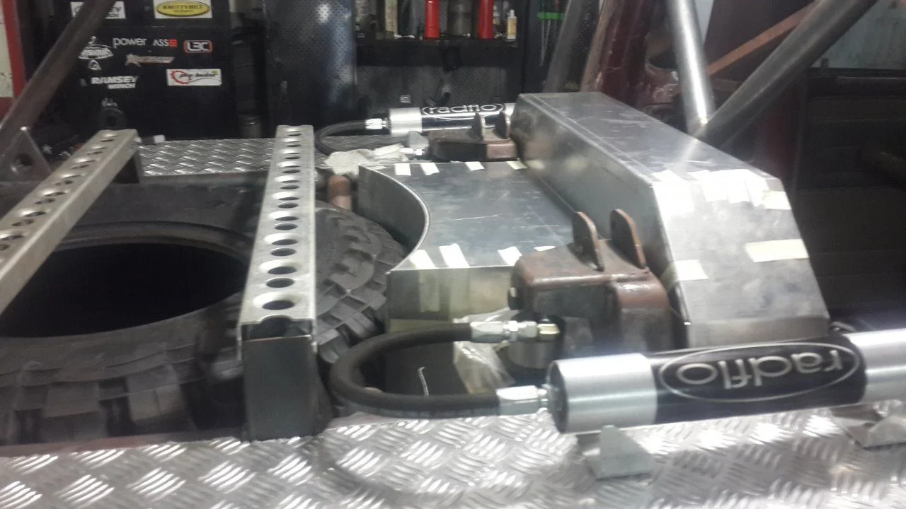

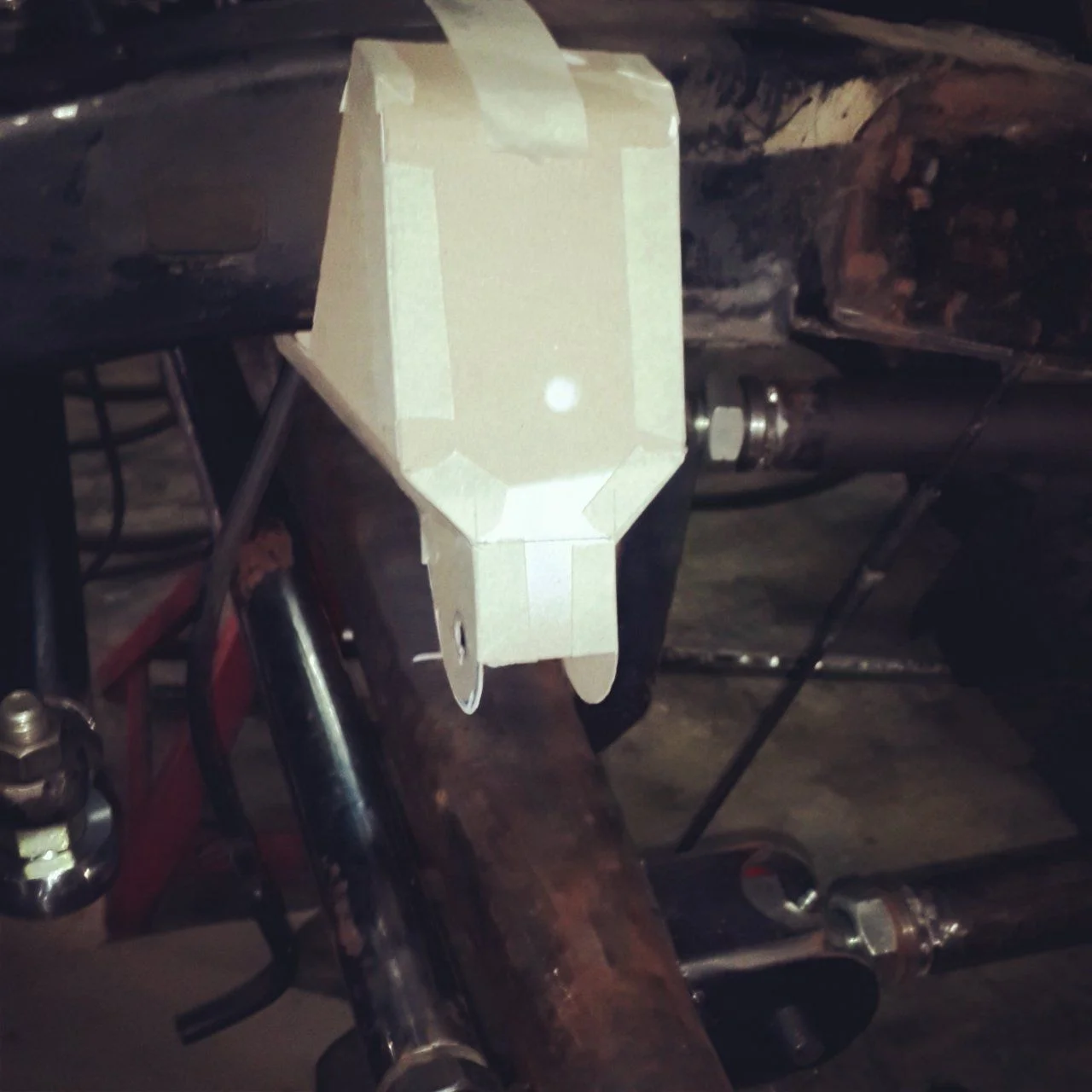

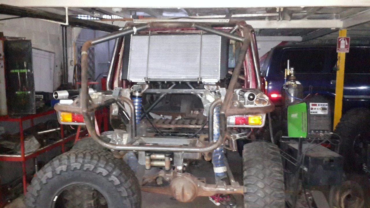

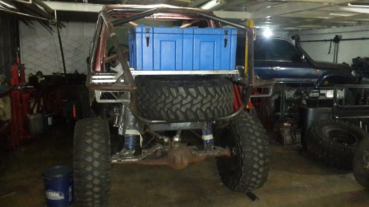

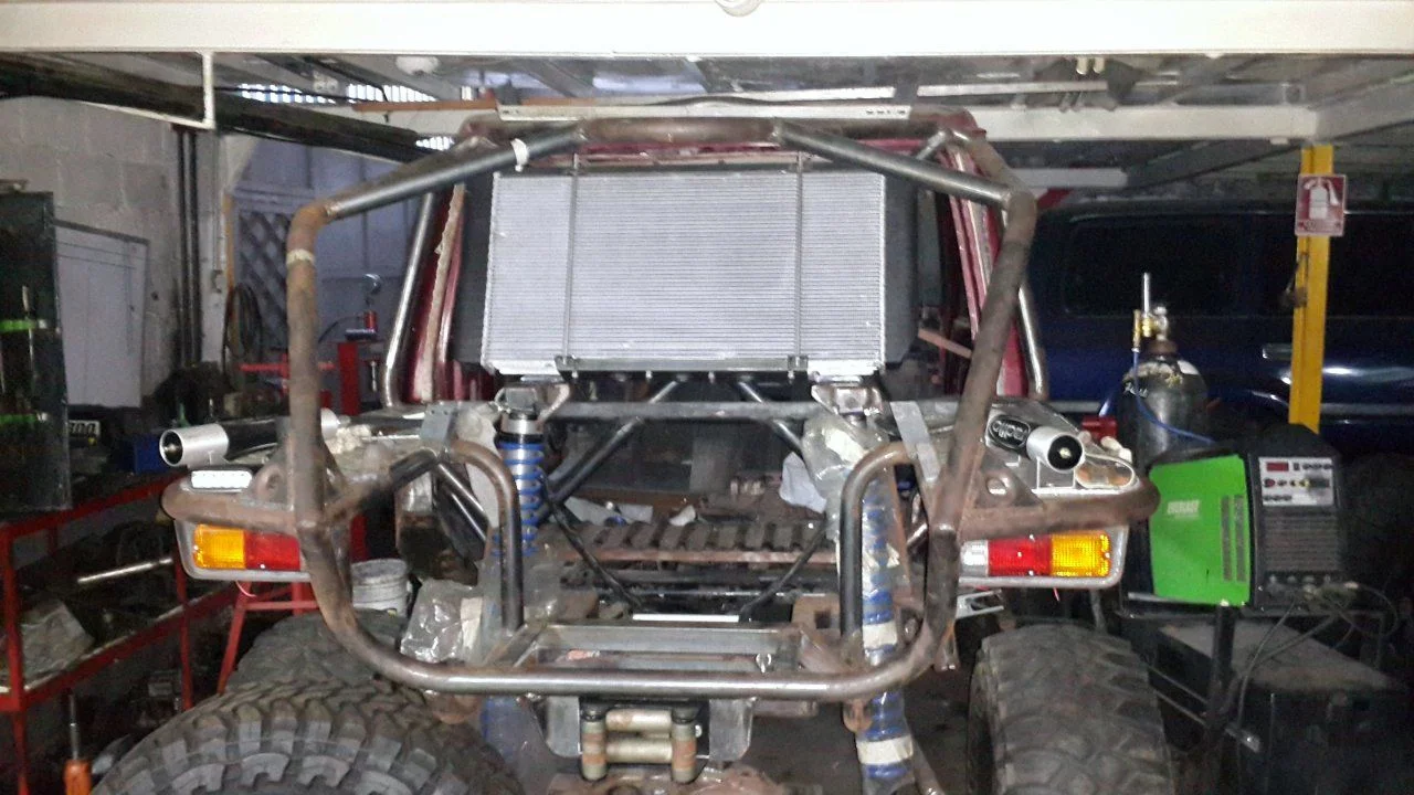

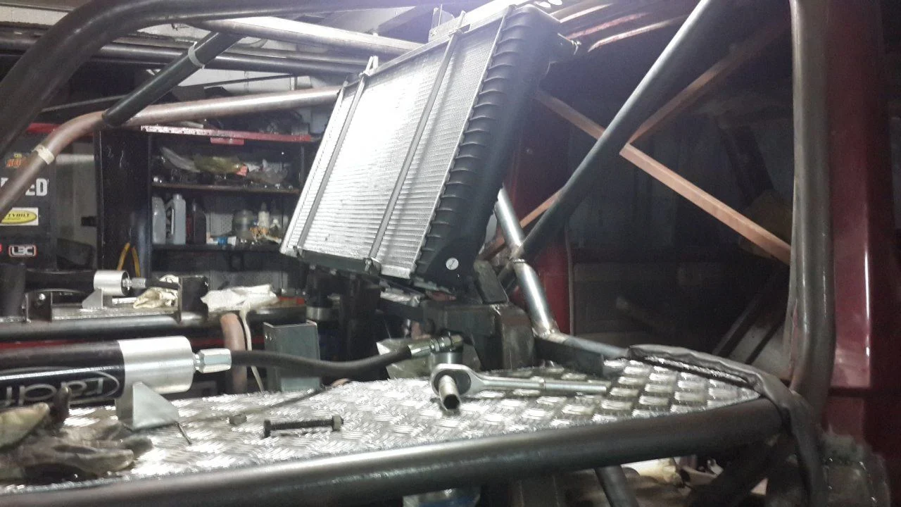

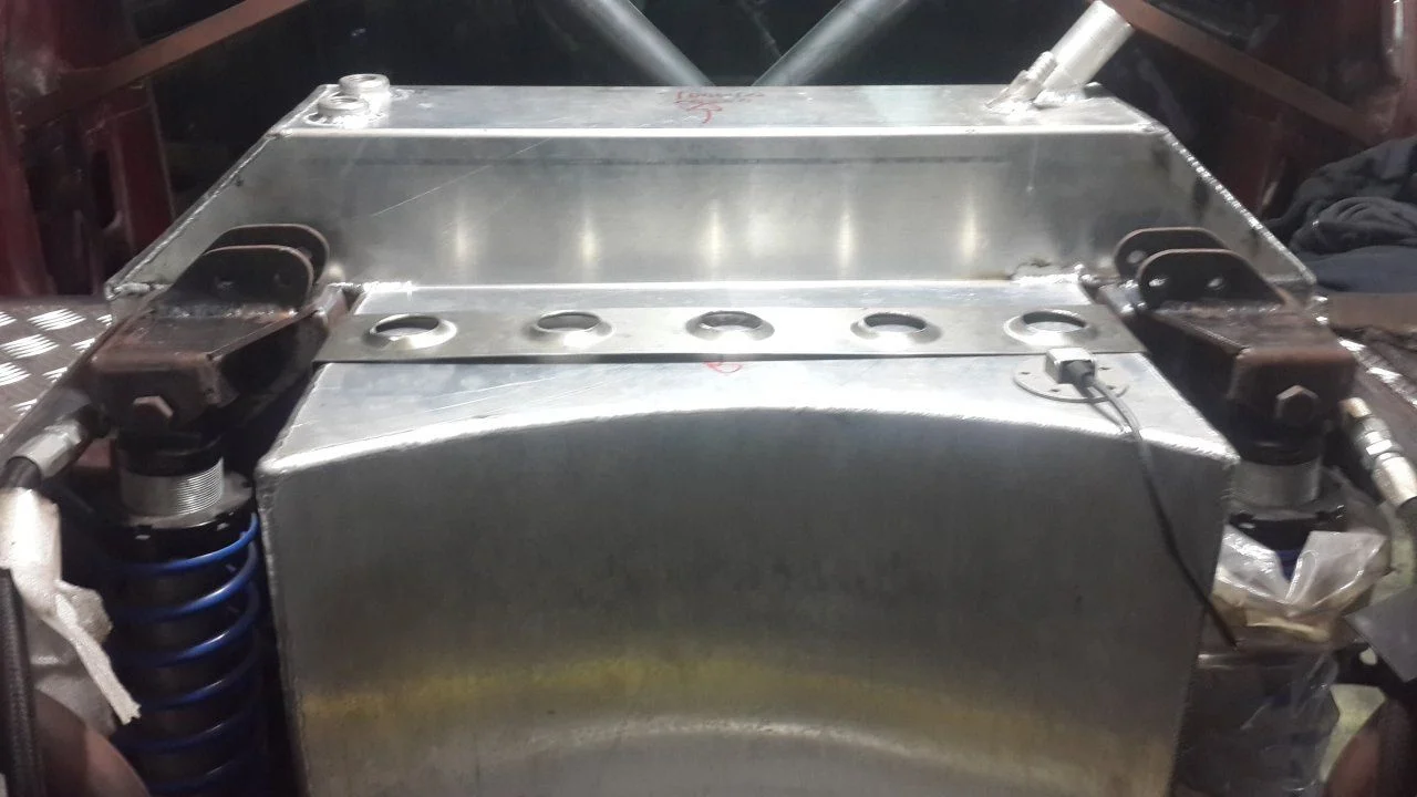

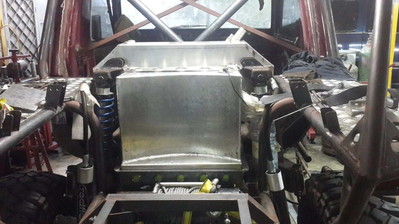

aluminum fuel tank and the rack for the pelican case, it aa PITA all the time we need to brake a part and do everything all over the radiator will be mount on the rear...
