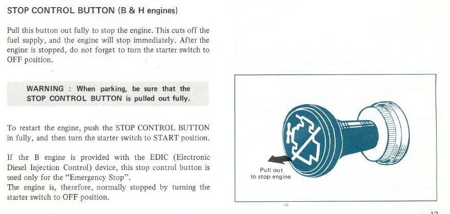

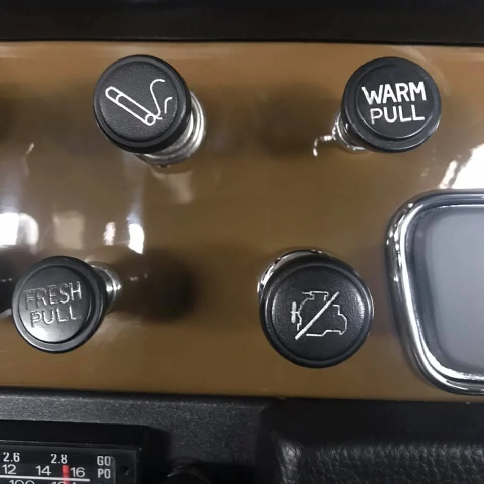

Some BJ40 had a factory stop-cable from new.. (see below).

A tidied up Stop Cable is adequate in my opinion.. yours may differ. A range of photos at the link below of other stop cable implementations I've come across.
